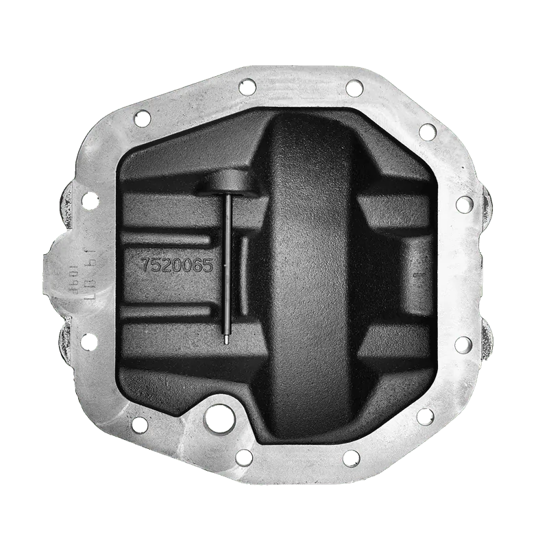

After going through all of Gale Banks' videos on the extensive R&D his company put into his product, I pretty much have backed away from considering anything else. The ARB comes closest in addressing most of the design 'problems' besides the Ford Performance (seen elsewhere) and I'm not overly hung up on the iron vs. alloy (or stamped steel in the case of stock) nor am I getting worked up on lubricant choices any more. It's easy to find the exterior shots of the different covers but here is an inside of the ARB. The drain plug casting is going to mess with flow to the axle bearings I think and with the drain already on the front of the diff housing I don't think it necessary. Plus filling from the dipstick hole might let dirt in future servicing and you'll have to be super vigilant about how much is going in. I can't picture what the horizontal ribs are going to do. The lighting here is confusing.
I still wonder if a windage tray in the large capacity, flat backed covers could work.

Thanks for posting that picture @Racket. I'm leaning towards the arb but I'm questioning even bothering with it now. Does anyone make a skid plate for our rear end? I've seen one for the Gladiator which uses the same axle but I'm not sure about fitment.

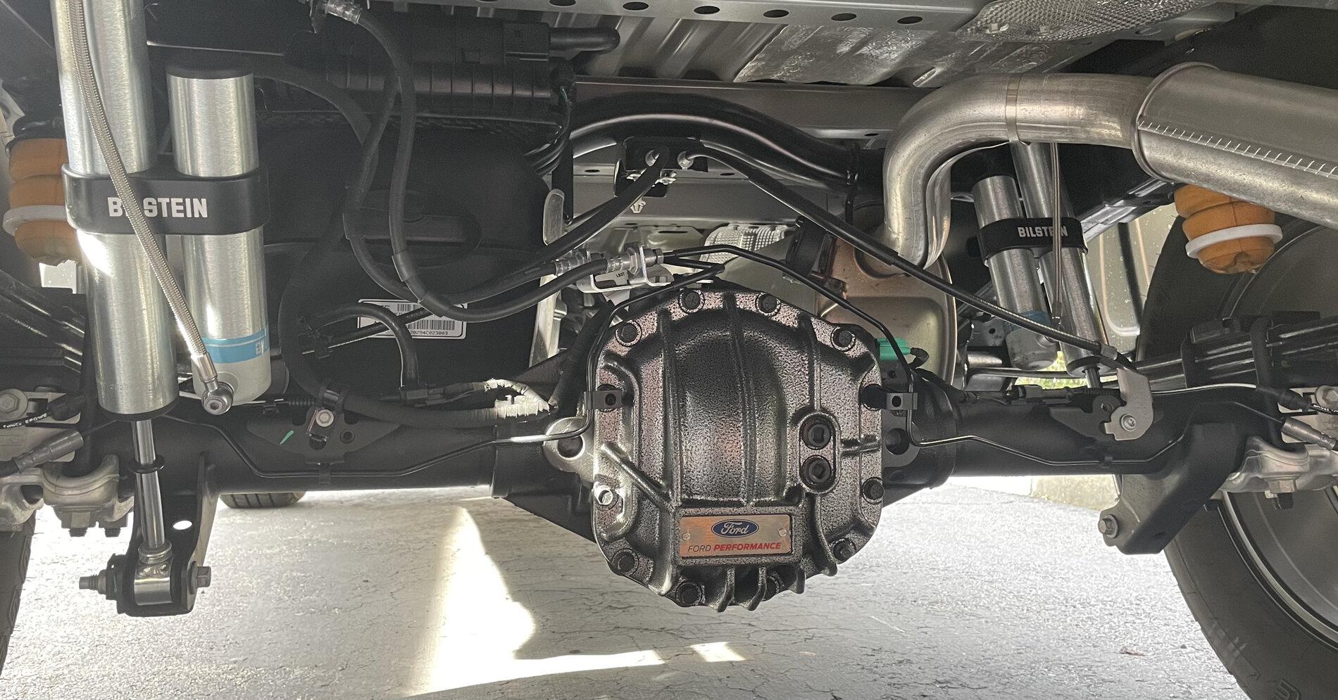

ARB cover is the only aftermarket one I've seen I'd consider. The Ford Performance one's detent for the logo plate isn't going to do much harm but, man, that logo plate will not age well, I assure you.

But for our Rangers... His points on the "square backs" and fluid flow, turbulence aeration etc make perfect sense and I would not buy a cover like that. The drawback of add capacity also make sense and seem that would do more harm than good. So where does that leave us? The Ford Perf and ARB covers vs stock steel?
