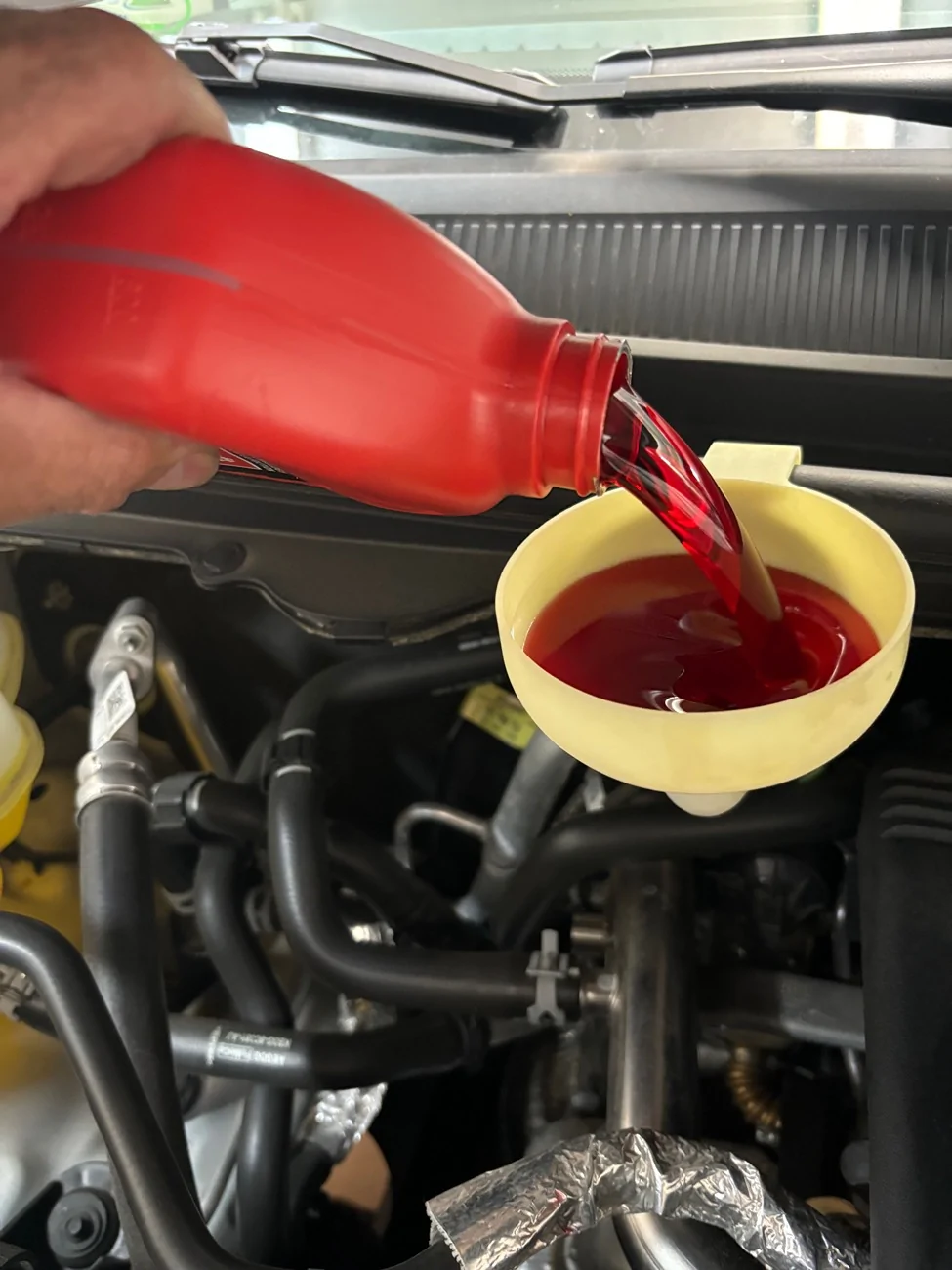

I was looking for you, remember readding about your dipstick a few years ago and I'm getting ready to change the fluid and wanted an easy way to measure the fluid level. All I did was search for "2021 Ford Ranger dipstick" and you ended up at the top of the list.
It's an easy way to check the level, pump it out, and fill it up.... ACCURATELY, with no mess. I've accomplished it 3 times. Can do it in less than 40 minutes if not changing the filter, without spilling a drop and have it completely accurate.
Hint: Once the Fitz stick is installed, position your truck where you plan to change the fluid. If you let it sit 48 hours you can pump 7.5qts out via the dipstick.... takes about 15 minutes. Put back in the same amount using your Fitzstick Funnel.
Put your dipstick in and start your truck, shift through the gears at 5 second intervals, then back to park at at 5 second intervals, immediately hop out and check your fluid. It should be just touching your dipstick, no more than 1/8" up the stick. This only works with cold truck and fluid. You must be on a flat surface to accurately check your fluid level. ULV expands rapidly with heat.
If you do this 3 times say over 1000 miles, you'll have replaced 98% of the fluid. Less than 7.5 quarts lowers the clean fluid level down to as low as 90%. A lot cheaper than taking it to a dealer.
All because of Fitz! (Thank you again!:clap:)

I think I have had a total of about 10 different color funnels, the original yellow ones, many different blue ones, a couple silvers, I even tried transparent colors so you could see the fluid through the funnel. (they don't print well at all)
The problem is whenever I find a brand/color that prints well, it always seems to run out of stock and is no longer available, so I have to pick something else.
I'm onto light blue now and so far it has been available for quite a while.
My printer runs all day and half the night, every 7+ hours it pops out 3 of them, then I also pay a guy to print backup funnels for when my printer is down.
The funnels are a bit of a pain to print and prep for shipping, but the feedback has been so good, I have to keep it going.
