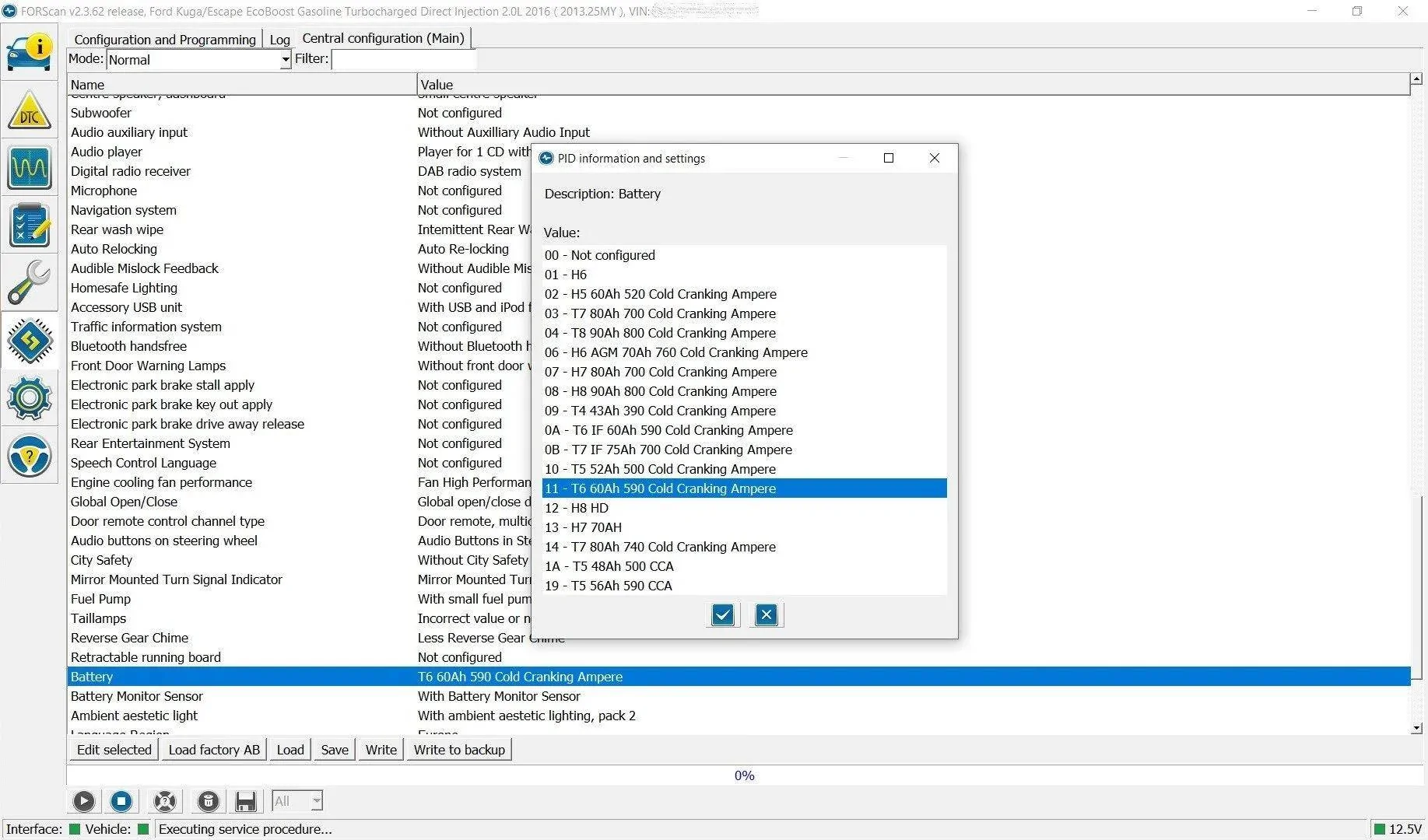

BTW, I tried to reset the battery in both Forscan and using method in the manual but Forscan keeps telling me the battery is almost 1500 days old. Anyone else seen that?
peterb
There is another avenue to reset that date - Forscan (Battery Type), note what is currently set (selected) change it to something else and then set it back.
I do not remember off hand if there was a (pre-programmed) selection in Forscan to upgrade up to the Lariat battery (800 CCA) from (720 or 760 CCA).
I do remember there was not a EXACT selection and you have the option to bump the size in either direction.
But the point is changing this selection, changes the Time Since Installed - Date
Another possibility - This makes sense - Forscan - Run a NEW PROFILE and see if it changes, this will force a new module scan and may update that PID.
Hmm, well since I did take out the stock XL H6 battery and installed the Lariat H7 battery I did change that but it didn't 0 it out. When you say run a NEW PROFILE do you mean to not accept the saved profile when I first connect it?
peterb
YES - Try a New Profile and rename it, in fact with the latest update, I remember seeing a pop-up message stating it was recommended, or it was in the download notes when it updated. I do not remember which.

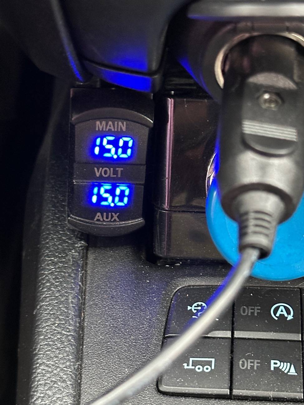

I’m nearing the end of my original stock H6 battery life (2019 XLT), which was extended due to me installing an additional battery in parallel to help power an insanely large industrial compressor a year or so after getting the truck.
I’d noticed some instances of the ASS not working and installed a dual voltage meter so I could see what was going on with both batteries at all times. Photo added to show both batteries at 15v while driving. My guess is the alternator is going hard to recharge the batteries (they were showing 12.1v this morning when I turned the key to power up truck but before cranking).
Had the truck in for warranty work recently (was with Ford nearly a month getting a door rust issue resolved). Ford told me my battery was at 60% and should be replaced. I declined, as I already have replacements ready and they had no idea I have two batteries.
Given my high accessory amp draw (170amp compressor that runs as needed and only while truck is on/alternator working), I’ve been a bit tuned into monitoring the battery usage and unhappy with the BMS. How could Ford invest in technology that wasn’t good for batteries? Haha. After reading @TJC and @Airline tech’s trials and tribulations I am convinced I need to pull the plug when I install the new batteries.

My questions are:
which onboard desulfator is the way to go (I’ve seen two referenced)?
Does simply unplugging solve the charge rate issue or do I need to invest in Forscan to change the SOC percentage?
Do I need to disable other systems to prevent dark drain? I have a remote start key fob that I use regularly and want to keep.
What does telematics control?
Answers in order of your questions
  1. I trust the BatteryMinder model. Been using it for years with success. I've mentioned a link in this thread where you'll get the best price that I have found. It is at an RV Accessories sales web site for ~$70.
  2. If you unplug the sensor, the BMS resorts to the charging system methodology used in the 4G Rangers, but charge voltages are 0.2v higher, probably due to the AGM battery that comes standard in the 5G Rangers. If you choose to keep the sensor plugged in, you'll need Forscan to turn off ASS and set SOC to 90%-100% range.
  3. If you want the fancy gadgets there is a price to be paid, and it is a higher dark current draw. I disabled telematics, the cellular modem, and a lot of lights, bells and whistles that draw power. My dark drain rate is now comparable to my 4G Ranger.
  4. Telematics doesn't really control anything. It piggybacks on the remote (Ford Cloud) convenience features. It constantly collects data about every aspect of your driving habits, vehicle performance, user preferences, etc., and sends that data to Ford Corporate, which Ford can then share/sell to whoever. There are terms of agreement, but Ford can really do whatever they want with the data.
    Ford uses the two way remote communications with the truck for diagnostics and upgrades as well.
