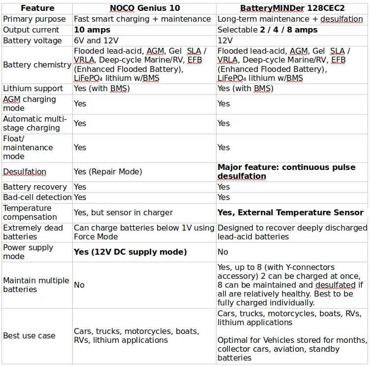

I picked up a NOCO Genius 10 after doing a bit of research on their technology. I also own the BatteryMINDer 128CEC2 and ran a comparison analysis. Here's what I came up with:

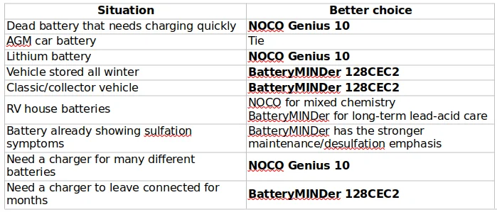

Which one is better for common situations?
I believe the chargers compliment each other. If you already own a BatteryMinder Onboard Desulfator, I'd lean towards the NOCO Genius10. I believe the BatteryMinder Desulfator Tech is superior to the NOCO, but if the battery has suffered heavy sulfation, It is worth the risk of using the brute force of the NOCO Repair cycle to bring it back to a level where the BatteryMinder can then fully optimize the battery by reducing the crystals even further.
I like them both for different reasons, and it is nice to have both in my toolset.
BTW, I have BatteryMinder Onboard Desulfators installed on all my vehicles, and my batteries last a long time.
And neither charger negates the need for the BatteryMinder Onboard Desulfator, esp on modern cars / trucks like our Rangers.
