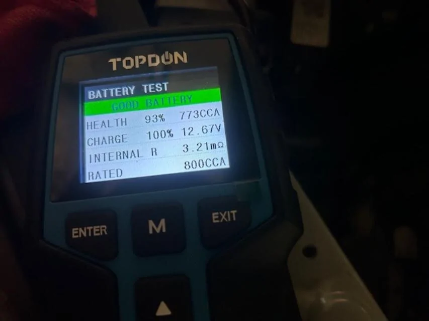

Battery Life Test Update - July 4th 2025 (9+ months since last test) Previous test for comparison.
Sept 25, 2024 Battery Test Results
2020 Ranger - Last driven 4 hours earlier for 20 miles
Battery Health = 100%
Battery Charge = 79%
CCA = 904 - Rated at 760
Voltage = 12.47v
Internal Resistance = 3.26 mOhms
July 4th, 2025 Battery Test Results
Truck was not driven for 10 days until today. Drive was 10 miles each way for grocery run - 20 miles total. Truck then sat 4 hours before the test. Opening the door activates my Amp Research Power Steps which will deplete any residual voltage overcharge. I am confident in the test accuracy. Both tests were taken using a Viking Battery Tester for consistency sake.
I do own a TopDon Tester. It reported higher voltage, lower CCA, and Lower Internal Resistance.
Battery Charge = 100%
CCA = 889 - Rated at 760
Voltage = 12.61v
Internal Resistance = 3.37 mOhms
The battery is 5 years 2 months old, and is showing no signs of deterioration. I expect at least another 5 years of useful life.
Ambient air temp was 90F. Charge voltage while driving was 13.6v - 13.8v. During winter the charge voltage runs around 14.1v - 14.3v

Latest test result from this morning is at the bottom of the entry. Still seeing improvement in battery health. I kept the previous 2 test results for comparison.
Voltage = 12.47v
Voltage = 12.61v
Sept 05, 2025 Battery Test Results
CCA = 931 - Rated at 760
Voltage = 12.71v
Internal Resistance = 3.22 mOhms
The battery is 64 months old, and is showing no signs of deterioration. I expect at least another 5 years of useful life.
I am contemplating setting resetting the BMS so it thinks that my battery is new, and as I think Ford engineers may be thinking older batteries decay, and they modify the charging parameters to reflect a weaker battery. I want those charging parameters to reflect a healthy battery, not a 5.5 year old battery.

I recently check mine, due to I occasionally plug in the voltmeter in the Power Point for a curiosity check.
Noted that my charging voltage was reading 12.2 (12.4 Actual) got to work and my door lock (handle) sensor was inop - locked with FOB.
Drive home same issue 12.2 - Hmm, cycled the headlights to (ON) voltage climbed to 13.7
cycled them back off and voltage remained at that level. Hmm - do I have an issue?
I am set to 90% SOC
Got home and checked the battery - tests good
now note it had been part of a heat wave (in the high 90's) and I know the PCM has a PID for:
Battery Temperature Estimated - I did not check to see what it was reading at the time of my little error, but I suspect possibly it sensed battery temp was above whatever it determines max temp and killed off the charge or the PCM just had a case of laziness.
Weird issue but it has not returned, and no fault codes found.
Granted the 12.4 Volts (actual) is normal to see if at idle and set to factory 75%, so it is still in normal range- but not while driving. I wonder if the Batt Minder (Desulf) may have triggered it - IDK. I checked it when I tested the battery (still blinking) above 13.5.
Anyway all is good now - I am monitoring every drive now till I am comfortable it resolved itself.

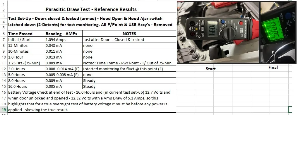

I put together a quick ref of my test results for - Parasitic Draw as a ref to normal
16.0 Hour (Test Window)
Did not note - while out in the garage any TCU (Ford Pass Check-Ins)
I am curious (when it occurs) how much of a draw it is and how long does it last?
Depending on how many times it does it through the (At Rest - Period) can have a change in the results.
I may set-up again for a quick test - Force (Ford Pass) Refresh and note Before and After as well as the timeline of the draw,
But here is my reference results:

Really valuable data. Thank you!
I surmise that you used a flat blade screwdriver to lock the hood latch.
I am also assuming that you used a clamp ammeter on the negative battery terminal. Was the meter undisturbed for the entire test? I have found that readings can vary depending on clamp placement.
I'm going to start my analysis just after I complete my rear seat delete work. I'm going to pull the same test on both my 2005 and 2020 Rangers. I will follow the same time and test parameters that you described. The results will be interesting.
I am surprised by how low the draw dropped.
You should change your mA reading units to Amps. For example, .005 Amps = 5 mA.
