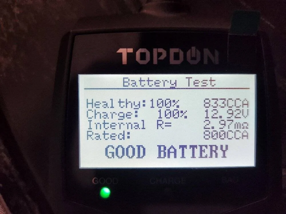

The top numbers seem accurate, but the bottom reading "does not compute," at 12.05 volts you should be ~ 50% charge, assuming it's an AGM battery. And yes with your battery still connected , despite things being turned off there is likely some parasitic discharge, IIRC some of the memory used in some devices draws a small amount of current as may some other components.
did you run the test several times ?
I understand these vehicles have some parasitic draw, but down to zero charge doesn't seem right.
Yes, tested more than once and charge showed 0% a couple times. Something is draining the battery over just two nights.
Finished a charge with the NOCO and looks good but still don't understand how it goes to zero in a couple nights.

The top numbers seem accurate, but the bottom reading "does not compute," at 12.05 volts you should be ~ 50% charge, assuming it's an AGM battery. And yes with your battery still connected , despite things being turned off there is likely some parasitic discharge, IIRC some of the memory (volatile)) used in some devices draws a small amount of current as may some other components.
According to a state of charge chart I have, 50% charge on an AGM battery at 80 degrees should be 12.40 volts. This same chart shows 12.00 volts as 25% charge, so the Topdon SOC reading seems to be very low for 12.01 volts.
You're on the money... closer to 45% charge for AGM, but close enough. I've seen some charts go as low as 30% for a 12.05v charge of 12v battery. These readings also vary with temperature. The colder the lower the readings.
There is quite a bit of dark current with newer autos. You can minimize dark current, but only by disabling a lot of the modern electronic gadgets, bells and whistles. Most won't accept the tradeoff.
I have my 2020 Ranger behaving just like my 2005 Ranger with regards to dark current loss and battery target charge levels. But it required turning off electronics, etc, and reverting to the 4G Ranger's BMS charging patterns.

If I'm interpreting some of the readings correctly- cca for one the battery would seem to be good, wonder if the tester is doesn't give accurate
I'd- if it's very cold I don't think your tester compensates and the battery voltage will be lower than at 80 degrees after the battery sits for a day or so and I doubt that Mr Topdon compensates for this thus the readings are less than accurate. A remote possibility is a bad cell within the battery. A clamp tester can tell you the current draw and verify you have parasitic loses but even when you think everthing is turned off there is still some current draw.
