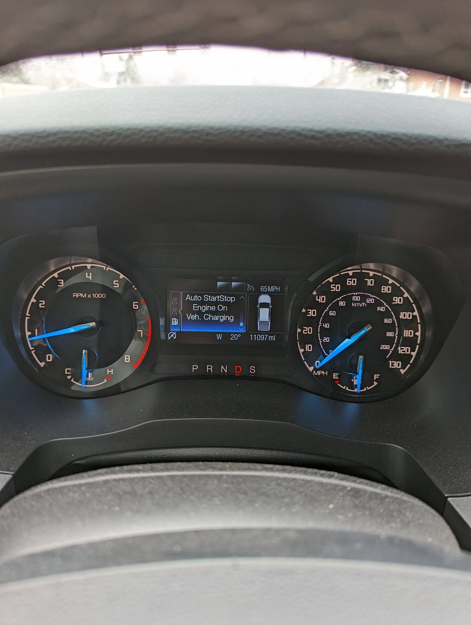

I have been having an issue with my battery over the past month. It has been sending my Ford Pass app "Remote features disabled..." messages to preserve battery. It also was giving me a message on Sync every morning when I went to start it, that I needed to either start the vehicle or turn off the ignition to preserve battery, or something to that effect. Anyway, I browsed thru the many threads involving battery issues and did not see a mention of this. I scheduled a visit to the dealer to get the battery checked. At the dealer, they put it on their Rotunda Battery tester and told me it would take 2 hours to fully run the test on that machine. Over four hours later, it was finally done testing. The dealer told me it sometimes takes the machine longer to do the test, depending on the battery, hence the 4+ hours. The end result was that the battery was good. Anyway, does anyone know what that Rotunda battery tester is? Seems it must be some type of de-sulfation charger, as my battery is definitely better than before it was on that machine. I have not gotten any warnings in several days. Only being 400 miles shy of my bumper to bumper warranty expiring, I am guessing my battery will now make it that far.

Thanks, the dealer did say that they needed a code from that to warranty the battery, which it did not give. When I got home, I tested the battery with my multi-meter, in which it was 12.5V, which settled down to 12.2V overnight. I had been checking the battery regularly over the past few weeks and I had not seen over 12.2V after a drive and it would settle down to 11.3-11.7V overnight (and give me the typical low battery messages). So I am wondering if the battery is on its way out or does my truck have a charging or battery management issue? That is why I asked this question, if that machine ran a desulfation process, and improved battery performance, than I can feel safe it is just the battery and not something with the charging system. I will exceed the bumper to bumper warranty in about weeks worth of driving, so I wanted to feel confident that it was just the battery.

That's the thing, I have not gotten any of those messages since it was on their machine. If it is just the battery going bad, I can deal with that, if it was due to the charging system, that may get a bit more costly. They did say the charging system was working as it should. The thing that gets me is I have been having these issues and if everything is testing out to be good, it's just not logical. If they would tell me the battery is on it's way out, but it is not bad enough yet for Ford to warranty it, I could live with that, but telling me everything is hunky dory, makes me worried.

I have the same exact problem. Dealer also said battery is "okay". Auto start/stop also doesn't work and says it's disabled for charging. Lots of other people have the same issue and some were able to get the battery replaced.

Yes, I have read the other threads. I guess it depends if you get a good dealer or not? Do you also get the message when you go to start it for the first time of the day? The message I get is on the Sync3 screen, I don't remember the exact warning, but it tells you to start the vehicle or turn off the ignition to preserve battery, or something to that effect. I actually had two occasions where i needed a jump start.

Yeah I get it on startup. The radio also shuts within 30 seconds of turning off the truck. I haven't needed a jump start yet though.
