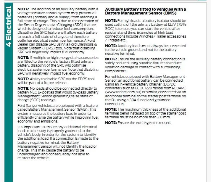

Since you are one of the few who have or plan on having a - Full Time Aux Battery without a trailer hooked up (Charging A Trailer Battery)
This is from the Body Equipment Builders Manual - for the Ranger
A few notes:
My recent play with FDRS did not show any (Quick Links) to disable the SRC, so unsure what this manual is referencing (I can assume it is - Disabling the BMS that same as Forscan would and alter the As-Built Files (Like Forscan)
Not this MAY be available from the Dealer Level (Sign-On) access, again I assume its the same thing only (wording different) here in this document.

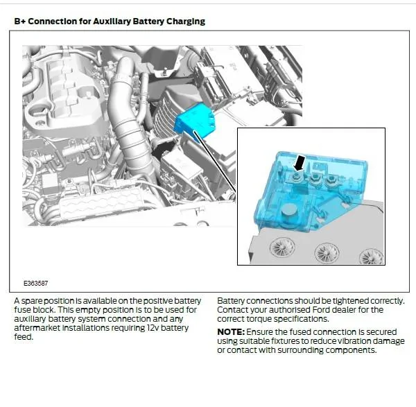

Another Note: Ref (B+) connection, there is not an extra spot for hook-up as stated on the BMFL however mounted below the (BJB) - Engine Bay (Fuse Box) there is a High-Current Fuse box with an extra port that a (+) cable can be connected.
For Non-Tremmer Trucks
I know that there are youtube videos about hook up and how they operate (External DC/DC) charger and when the (Aux Battery) begins charging, I believe it is similar to how the De-Sulf operates.
With priority given to the (Main) battery then charger kicks in and charges the (Aux)
More research is needed - with install of (Aux) battery
I would say if its lasted this long, then possible to just disable the BMS or Up the SOC may be beneficial enough to forgo an additional charger as described in this manual.
Note: This is the only (Mention) of any alteration of the BMS or charging system in any Ford Document (Note- they do not elaborate on it either)
A few notes:
