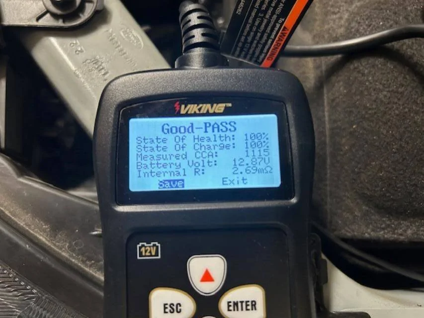

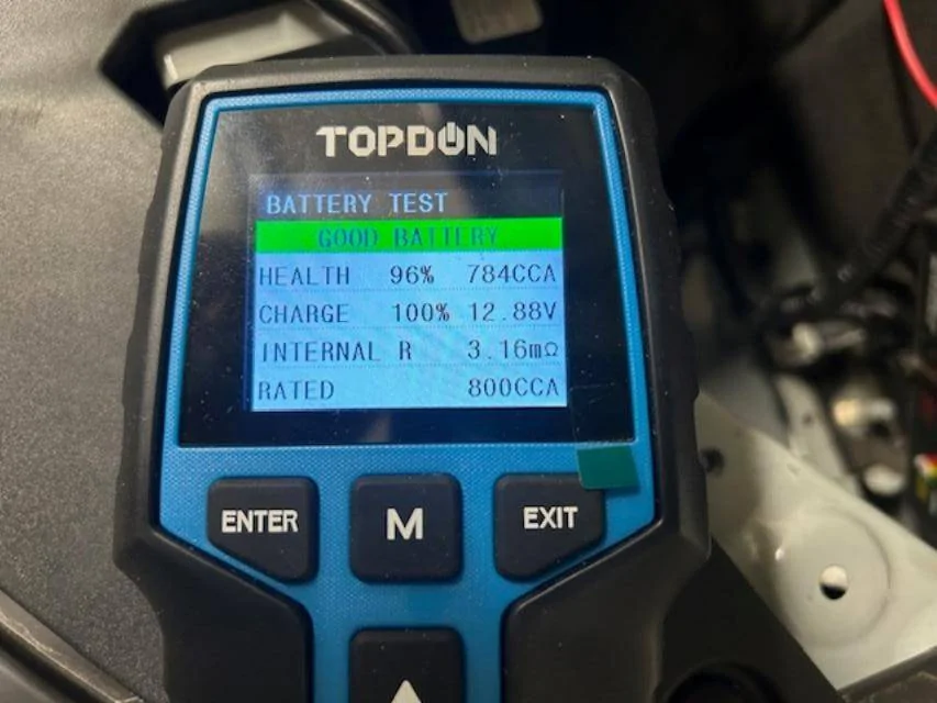

Decided I would do a Heath Check while in the Garage today.
The Onboard Desulfator and Raising the SOC to 90% is working, I have been at 90% since Dec 23.
I have thought about trying to find a clamp small enough to truly fit around the Positive Cable for more accurate results and then clamp the tester to that clamp.
I am highly curious how much of a difference the results would be (if battery disconnected) and direct to the posts but have not wanted to disconnect the battery unless necessary.

Good numbers

I understand the connection concern. I always take several measurement and they vary vastly. I just go with the best one and conclude that was the best connection.

It is good to see such great numbers. I have had the same thoughts about isolating the battery, but I am too lazy (or maybe ROI isn't worth it to me).

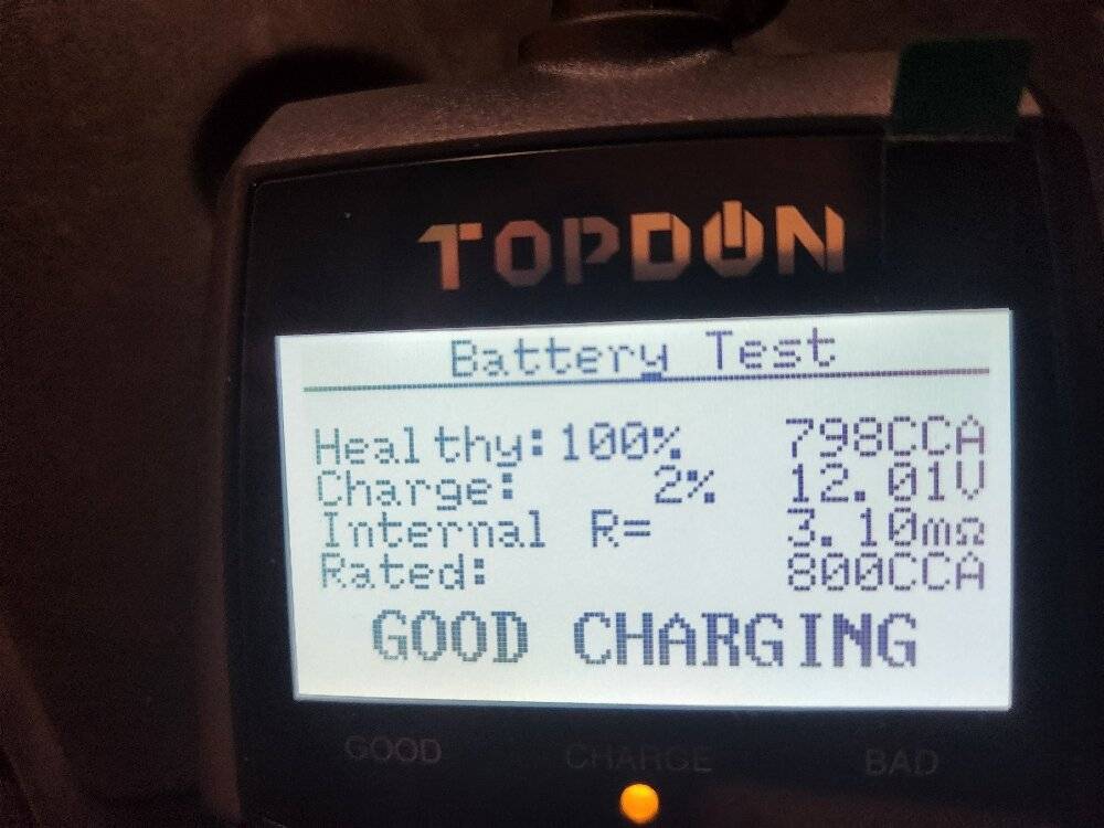

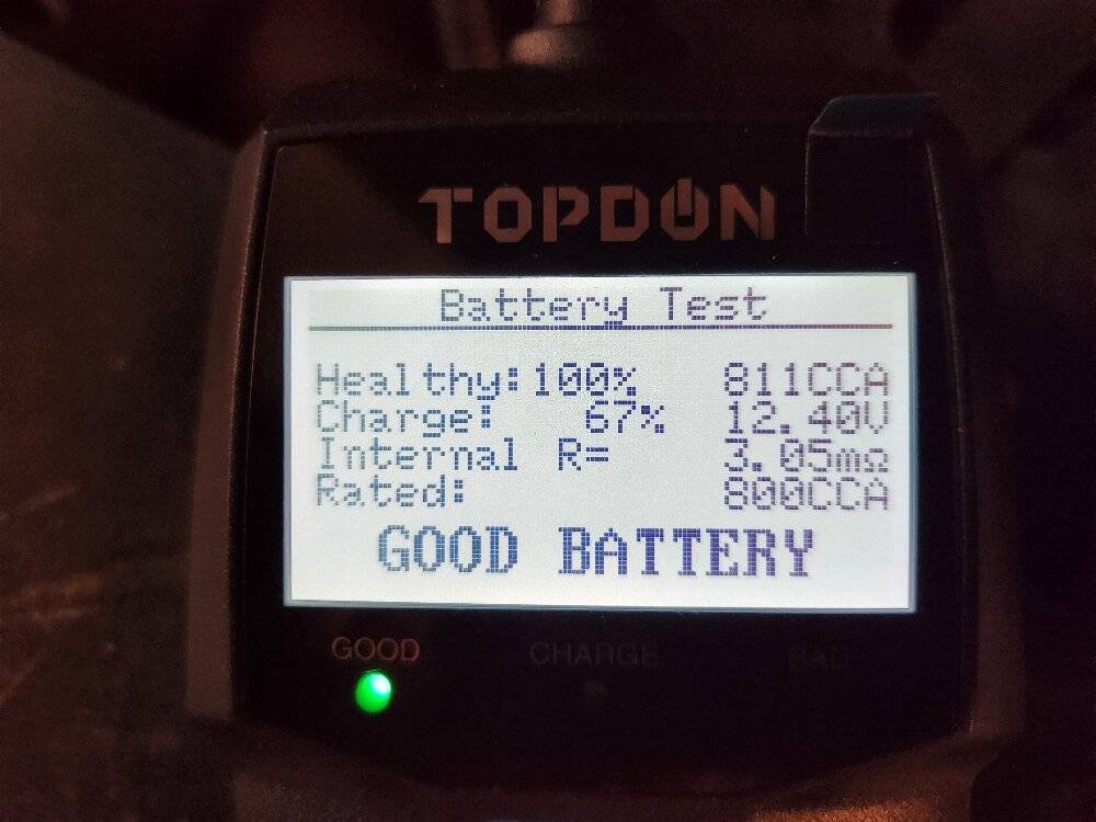

Question for @airline tech and others, I replaced my battery on 11/11/24 and parked it in the garage since 11/12/24. Why is the charge gone after a few days? Do you suspect a parasitic drain problem?
PS, nothing is left on.
When bought:
3 days later:

The top numbers seem accurate, but the bottom reading "does not compute," at 12.05 volts you should be ~ 50% charge, assuming it's an AGM battery. And yes with your battery still connected , despite things being turned off there is likely some parasitic discharge, IIRC some of the memory (volatile)) used in some devices draws a small amount of current as may some other components.
did you run the test several times ?
