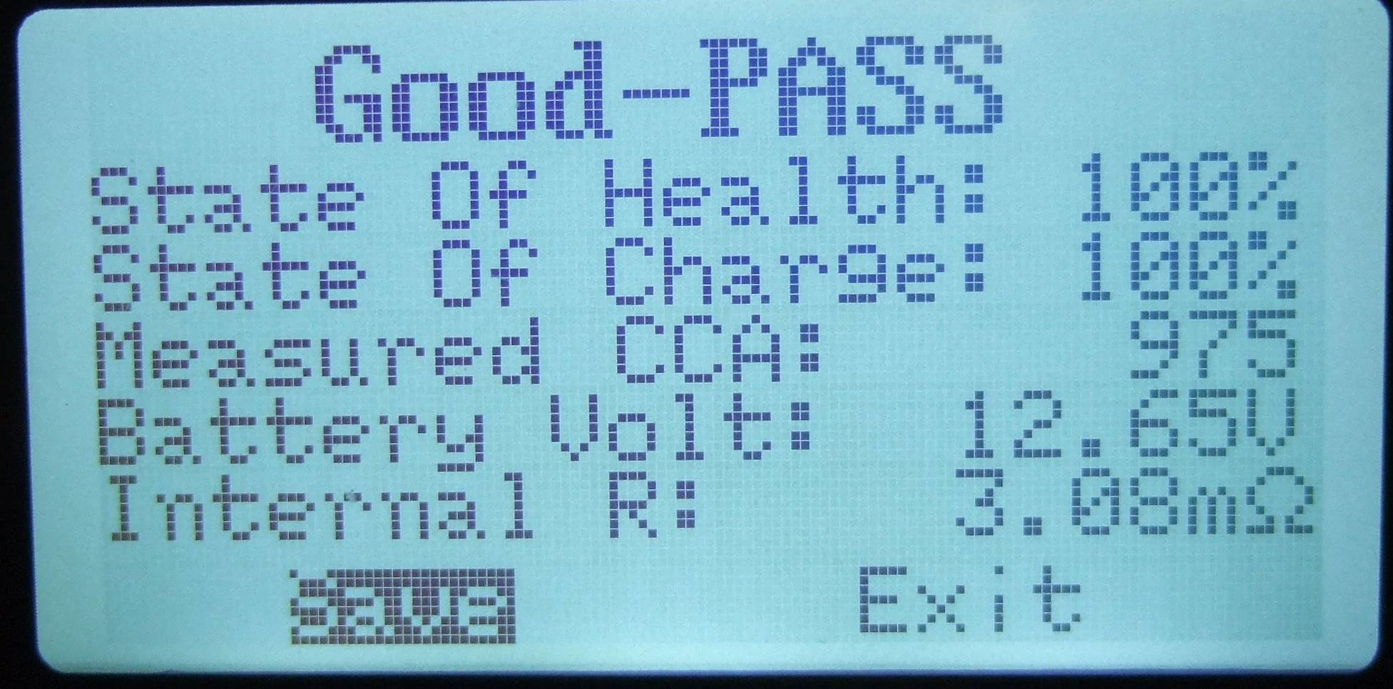

A sound strategy. I will be interested to see what SOC you settle on.
Here is another data point.
I just returned last night at midnight from a 1300 mile trip - 650 miles each way with a 2.5 day interval. No driving between the 2 long drives up and back on the day 1 and 4. I drove from Central North Carolina to 50 miles north of Syracuse, NY. All of the driving time was at night. Dark when I left Wed at 8PM and dark when I left at 7PM Saturday evening to head back home. Trip took ~10+ hours each way. I did not drive the truck the two days I was at destination. Temps were in the low 40's to low 50's and truck was outdoors during this time. Charge voltage jumped to 14.1v measured in the cab for most of the trip each way.
The truck has been parked for 12 hours - so the battery has been resting for 12 hours. Just went out and took measurements using my Viking Battery tester. I measured from the bolt on the negative terminal, and the small recessed stainless steel bolt on the positive terminal to insure an accurate reading. Measuring any place else on the positive side gives false readings. Here are my results.
Forscan Settings
ASS = Off​
BMS SOC = 95 (I am going to experiment with this a bit to find optimal SOC.)​
BatteryMinder Desulfator installed 18 months ago
Original 3 year old Ford battery rated at 760 CCA
My CCA is 205 CCA higher than the manufacturer's battery rating when new!
That's 28% above the batteries CCA rating!

Was this a repeat reading? I find that I can get widely varied readings if I take 2 or 3 or4 measurements within a couple of minutes.
TJC
Aug 28, 2020
45
3,933
9,871
I validate all my readings twice. And I let the battery rest at least 8 hours before taking a reading. The truck sat for 12 hours this time around, and I opened the door to open the hood (which powered my Amp Research Power Steps, and Step Lights). So I drew down some power prior to the test.
You will get different readings if you take them right after you charge the battery, or draw power. Minimize power draws as much as possible. I do not run through the Viking Battery Tester Power and Alternator tests. I tell the system that the battery is out of the car to avoid those tests.
I always take the readings from the same post as well. The little inset stainless steel stud. You get different readings from the other positive points. It matters!

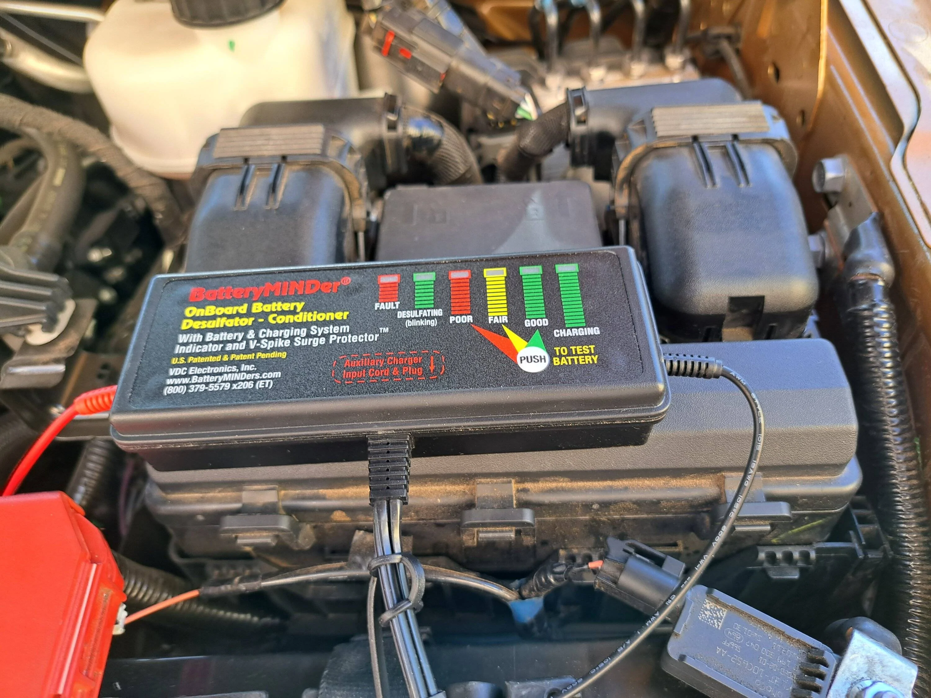

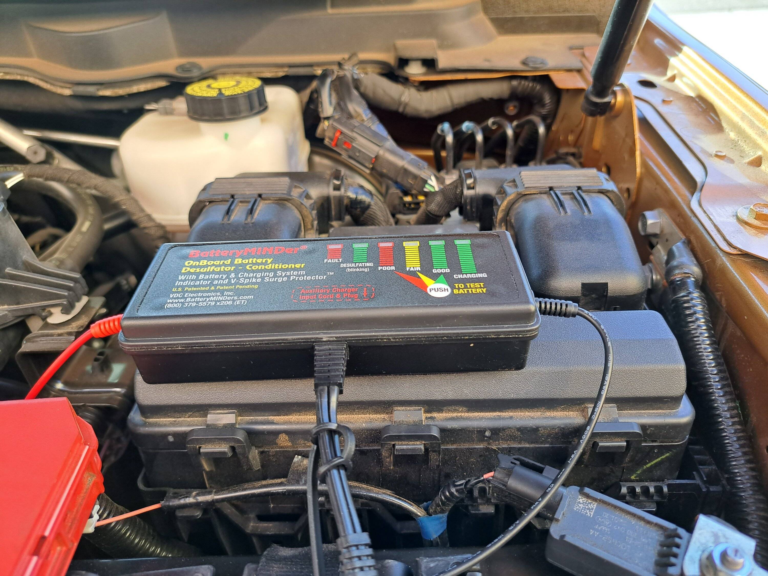

Pete,
Installed my BatteryMINDer in Sept. I stuck mine on the top front of the fuse box lid in a position where the fuse box will open without interfering with the BatterMINDer even though it will remain stuck on the fuse box lid after it is opened...the wires were too short to go much farther toward the firewall :frown: Tony @TJC had given me some excellent advice on how to go through the process of setting up and learning the system!

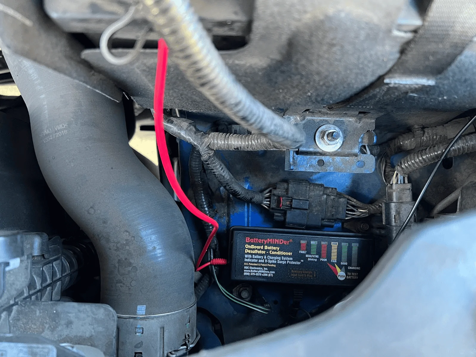

I've been meaning to post this but this is where I installed mine. Had to bend one of the connectors a but and clean up the grime on the metal but it fits snug and I think the Velcro will hold it well.

Congrats on the purchase and install. I did not need to extend the leads. Maybe they shortened them in the new versions. Put your battery on trickle charge, and let the desulfator do its thing for a week or two.
Thanks. I have noticed my voltage acting different. After it shuts down, it stays closer to 13 volts for longer now but it also seems to get down to 12 volts when I get back to the truck. I suppose it just needs to continue to do its work? I've not seen my CCA going up at all just yet but then it's only been a few days. I've put it on the charger a couple of times to let it do its thing.
I assume everyone keeps theirs attached? The only reason I ask is that it almost seems like it's causing the battery to drain while it continues to desulfate but then I thought I saw somewhere that when the battery goes below 13.5 or so it will shut off. Will continue to monitor and I'm hoping that I'm saving my original battery that's now 4-1/2 years old and can get it to got 6 or more years.
