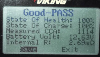

Since I purchased the truck in Aug 2020. Battery is a 760 CCA and my battery monitoring equipment shows it much higher CCA. Internal resistance is <= 3mOhm. I also added an onboard automatic Batteryminder desulfator. I have installed them on all my cars. Search this board for "Maximizing Battery". I did a very deep dive into ASS/BMS. My batteries last an average of 9-10 years. My 2020 Ranger battery was showing signs of weakness so I took action. It now is behaving exactly like my other vehicles. This picture below was measured at least 4 hours after being driven.... usually overnight. These are excellent readings.
I'll wager if you are allowing BMS to operate, your battery has between 5-10mOhm of internal resistance - meaning the battery charge has been so low for so long that the battery has heavy sulfation. (The sulfur in the acid binds to the lead plates as crystals causing high resistance, killing the battery.) This occurs when the battery voltage drops below 12.6v. The lower the voltage the faster the rate of accumulation. If you catch it soon enough, the process can be reversed with a Desulfator.
Ford BMS keeps the battery voltage intentionally low. They are trading battery life for EPA mileage ratings.

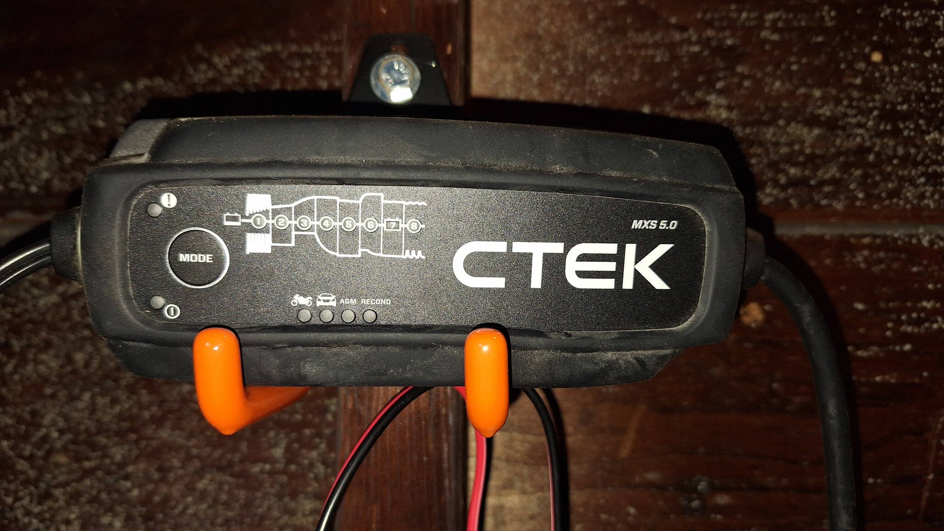

Since this thread's about a dead battery and charging from a low voltage, maybe one of you experts (and I'm being sincere, the stuff some of you know is mind boggling but tremendously interesting to read) can educate me on modern electrical systems.
I have a CTEK battery tender I run a few times a month and let it go overnight to do it's thing. I also carry a jump pack, just in case. From what I know, these are safe to use.
But ... if I were ever in a situation where the battery went dead, can an old school 10 amp charger still be used or is that asking for trouble?

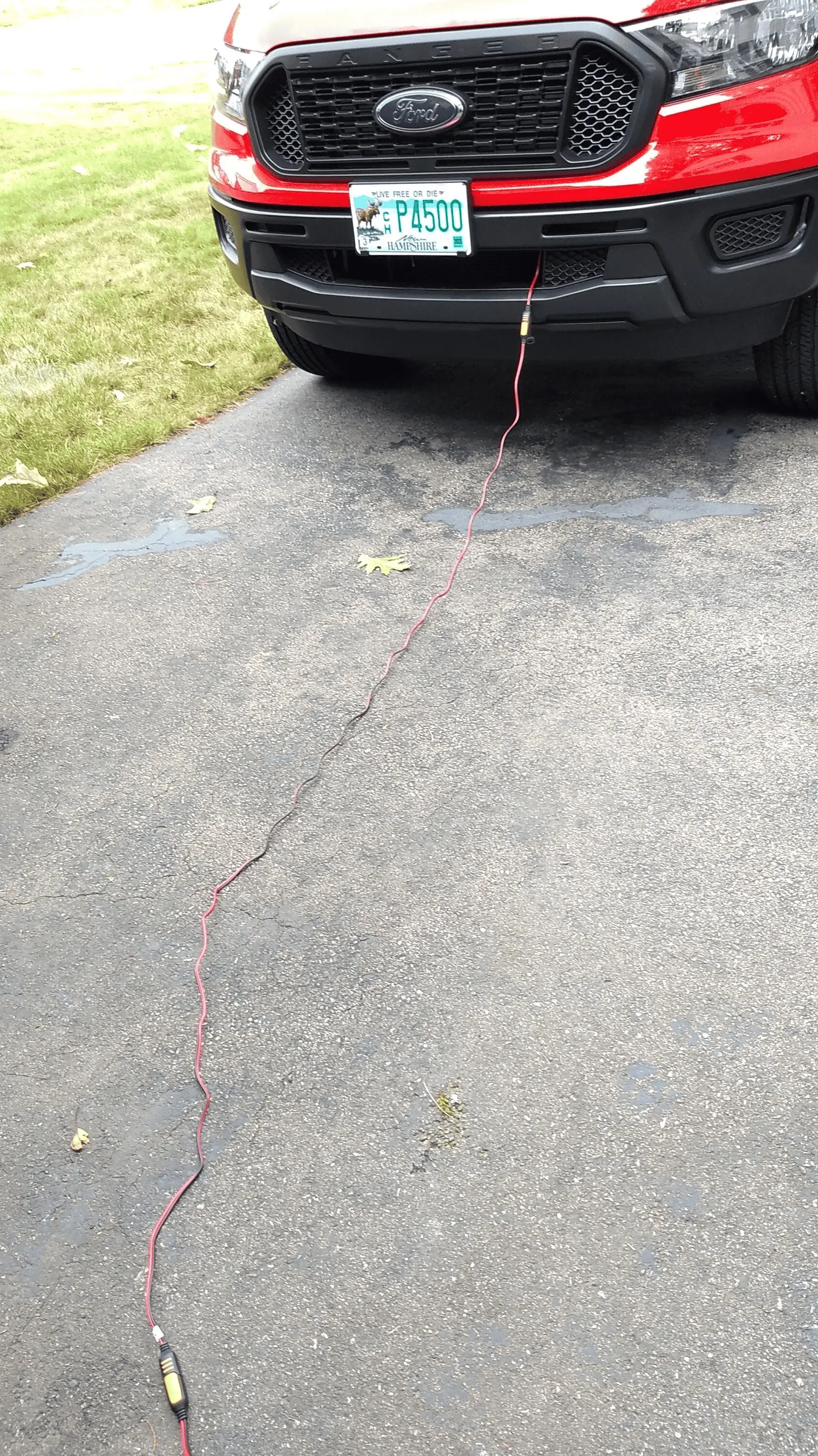

Always in the garage with 18 foot leads to the Ranger. Plug it in a few times a month in summer and at least once a week in winter.
