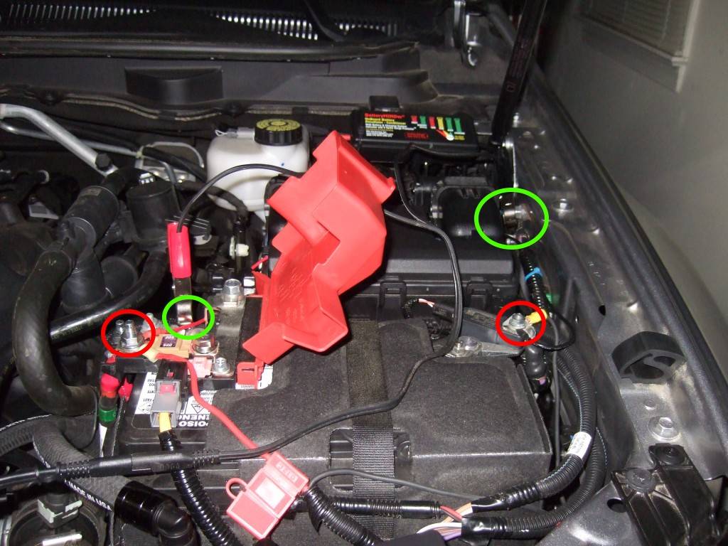

Hi Tony,
Do you have a pic on how your battery Minder is connected? Is the Red connected after the primary or secondary fuse or direct to the red lug? And the Black is it on the black lugs od chassis GND?

Hi Tony,
Thanks this info, this is interesting and I would like to try it since my battery is acting up.
I have the desulfator connected to the battery (Red Circles), The green circles are where I place the battery charger clamps . The green Neg connection point is the neg cable connection to the fender well. Note that I don't think the ground connection matters now that BMS is disabled in Forscan. So I now go directly to the Neg battery terminal after the BMS sensor (Red circle). The green circle on the positive battery post is optimal.
When testing the battery I use the same connection points as the battery charging points.
TJC
Aug 28, 2020
47
4,155
10,650
Iirc - my test points are to the bolt head - to the right of your positive clamp - and my negative is directly to the post- if you test at the fender ground you are adding resistance of the negative cable to your test result
And since the positive post is a little difficult to get a good connection- due to slight recess - I hook up to the most direct point from it
I found that altering from this gives inaccurate results
I test and charge at the same points that you do. The green circle near the positive terminal is that recessed bolt. I only used the fender ground when BMS was active. Now use the neg post after the BMS Sensor.
Thanks for the info, I appreciate it. I'll definitely look into this that I have another SUV that can use same desulfator.

The BMS system, when tuned properly, will outperform the standard charging system found on the 2005 Ranger. Based on my experience, the BMS does not overcharge the battery with a SOC at 95%.
The trick is to optimize for battery life over EPA mileage goals. Ford has set BMS up to gain some minuscule mileage increase by sacrificing battery life. I find this unacceptable, and I am forced to wonder if a fully charged optimized battery does more for EPA mileage (as the alternator is under far less load) than the present Ford BMS settings.
With the settings that I am using, BMS is literally trickle (Float Charging) charging my battery most of the time, instead of actively discharging it (down to 75% SOC) and then force feeding the battery with charge voltages well above optimal levels. Ford's BMS Regenerative charges are much higher than the charge rates listed below. To be blunt, the Ford BMS settings are abusing your battery, it is as simple as that!
Optimal AGM Absorption Charge = 14.2v - 14.6v​
Optimal AGM Float Charge = 13.2v - 13.8v​
To refresh all on what changes and additions have been made to my truck to insure a long life for my battery, here's the list that I have finally settled on:
  • Turned off ASS/BMS in Forscan (I don't think it actually turns off BMS, it simply neuters it! And the neutered algorithms are superior to those of the 2005 Ranger)
  • Raised Battery State of Charge Target (SOC) to 95% (from 75%) in Forscan
  • Minimized the headlight timers to shortest time or shut off entirely
  • Turned off various bells and chimes in Forscan
  • Installed a onboard BatteryMinder Desulfator Model OBD-12 that breaks down the sulfur crystals on the lead plates (lowering internal resistance) whenever the battery is being charged by the alternator.
I will sporadically monitor the system, but I am very satisfied with the results. I don't foresee any further work in this area.
Now on to the transmission issues!
