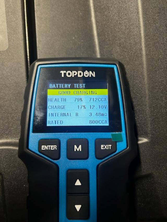

My Update:
Almost (1) month since installing the Batt Minder and upping the SOC from 75% to 80%
No seeing any improvement in battery health. Only using the Batt Minder (On-Board)
I did confirm what TJC has noted, when using a Plug-In Voltmeter in the Power Points there is a (.2)
voltage difference -Power Point = (.2) volts lower than actual battery voltage
as I stated before, this is most likely the voltage drop across the power point relay.
At shutdown after 5-Minutes - Same or close to all previous readings
A little bit lower than before install
However, cooler temps and more night driving so more noted in the 14's charging voltage.
Desulphator light is blinking at anything over 13.5 volts (verifed)
So, i question the effectiveness of the desulphator 13.5 vs 14.5 volts, which one of the (2) is doing more for the battery?
Since my main goal is to get better battery health, I need to include at test after 10 to 12 hrs rest
Note: 12.1 Volts, this matches what I have always seen on the Power Point meter 11.9 Volts, this clearly shows the voltage drop. In all of my Wake-Up voltage tests.
So, I need to update my BMS Charging System Thread, to note this small difference.
So, for mine - I have always have roughly .75-volt loss during sleep modes, my wake-up voltages have always been around 11.9 volts (12.1 Actual) on my meter. even after letting it sit for 3 or more days without starting it.
After 12 Hrs. Rest - (AKA - Wake-Up) Voltage
My changes today:
Bumped SOC from 80% to 85% and will monitor next month for any progression.
I also ordered the Noco Genius 10 - Cyber Monday
Being that I should have a battery charger in my massive tool assortment anyway.
I thought I would give it a try.
My thought was to hook up with it and disulfate while at rest vs only while being driven to speed up the process.
I do question at what IR, will the NOCO register it needs Desulphated, what is its programmed minimum IR it needs to see before it turns the desulphating mode off?
For a related matter, I question the true readings of the Topdon, how accurate is it? I know the voltage reading itself is accurate but how accurate is the Battery Test Results?
Being that results will widely vary depending on where you hook up the test leads.
The results themselves stay pretty much the same as long as I hook up to the same exact location every time.
Note: Resistance variance from the lead hook up points, will vary your results.
If needed might step up to the more expensive Batt Minder, IDK this is not a dire need for me, it is more of a can I make it better quest and what will it take in baby steps to reach that goal.

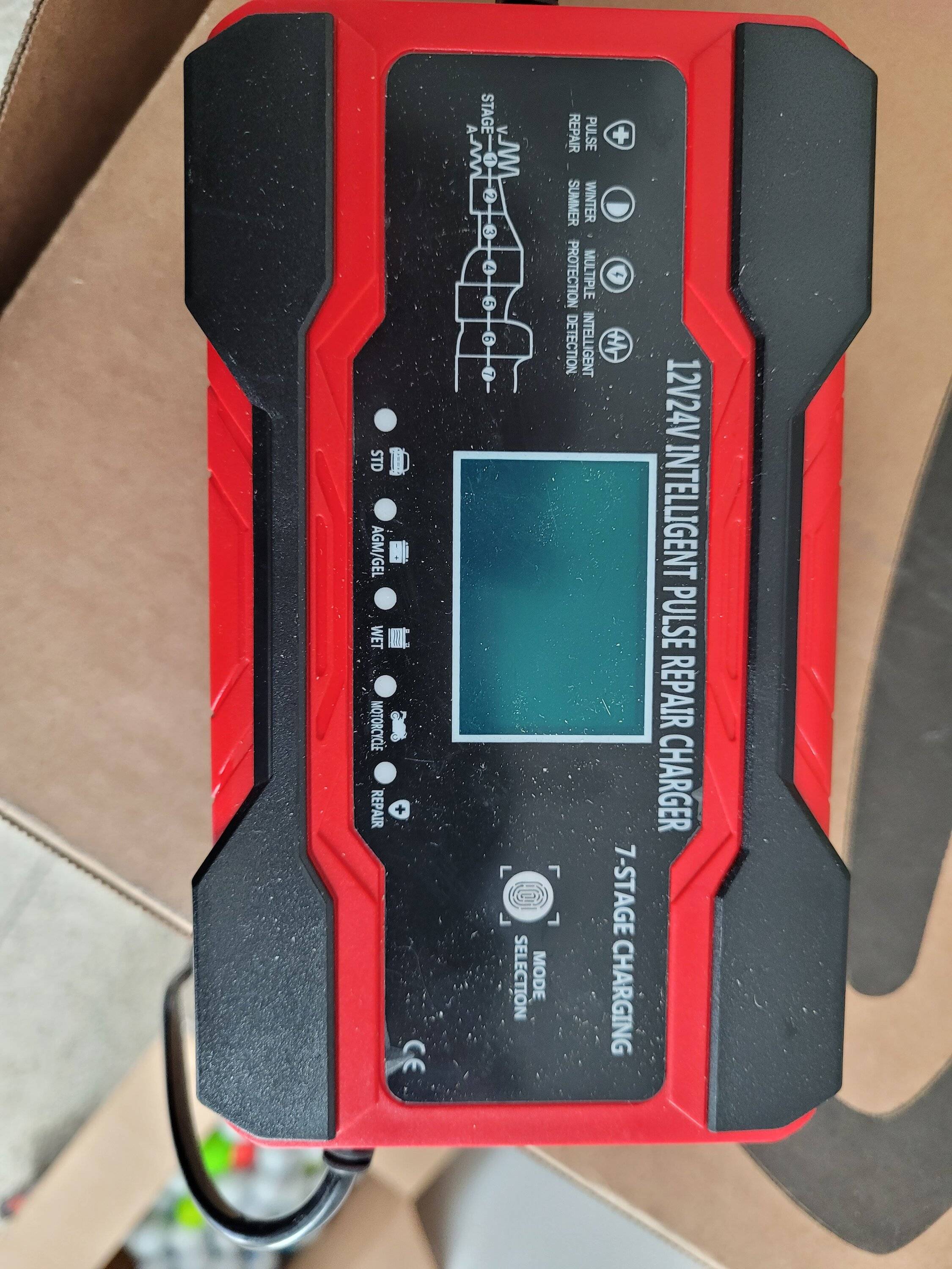

If I had a NOCO charger I'd be tempted to open it up and compare it to my Chinese brand, wouldn't be at all surprised if both are very similar, possibly identical . This is what happens when there is a rush to off shore mfg and certain countries have a well documented history of not abiding by patent laws. When I was looking at buying a modern battery charger there were dozens of options to choose from but nearly all mfg in China.
China is the pits. Bastards steal every idea they can get their hands on. It's like it's ingrained in them.
If I had a magic wand, no US company would manufacture or invest in anything in China. Prices be damned. Just slam the door on the bastards.

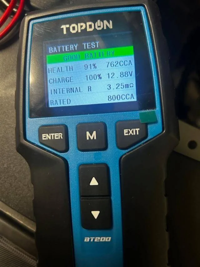

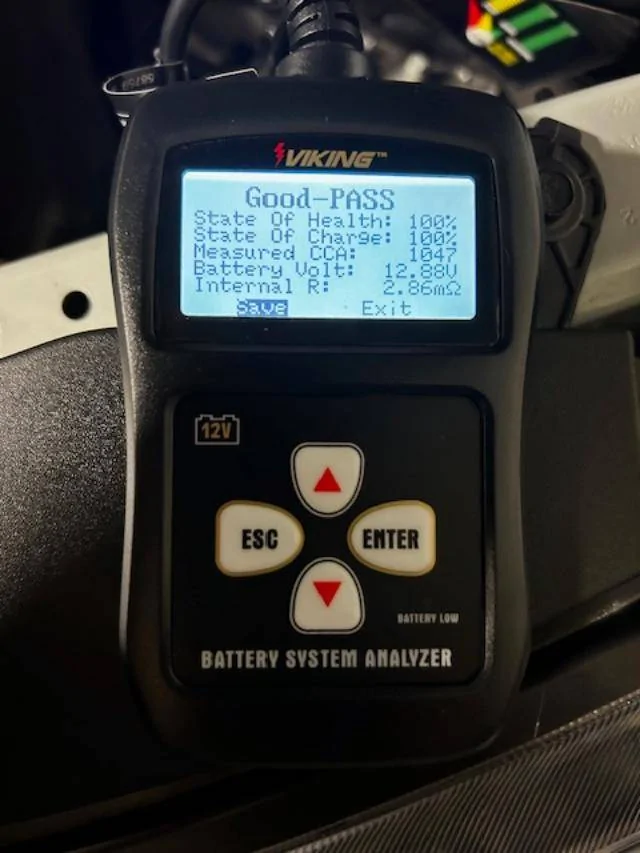

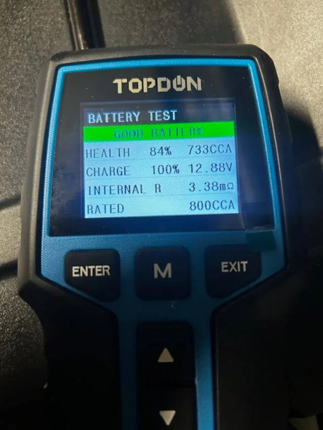

Well sometimes you have to say -Huh.
After putting my battery on the Noco-10 twice and I was not seeing any improvement in my test readings I wondered if my Topdon was not accurate.
I invested a small sum of money in the cheaper Viking tester, just as a comparison test tool.
I am thinking that I may send my Topdon in for repair or calibration, on the off chance it is indeed off. I have a feeling it is accurate, and my results are what they are. with it.
But here are my test results from today, taken at the same test points minutes apart.
HUGE difference in the results. :facepalm:
Which one is the most accurate?
I know these things are not the most reliable for accuracy.
I guess the main thing that had me stumped was how TJC was able to get CCA's so high, now I see the same with my Viking. Although I would like the Viking's results to be accurate, I have a hunch the Topdon is the winner here. IDK, I guess at least use both of these results as the baseline. :LOL:

Airline Tech,
I just ordered a BT200 on Amazon Prime and it will be here Sunday. Let's see if I can validate your results.
I have several autos and I will test them all with both testers, posting the results here.
