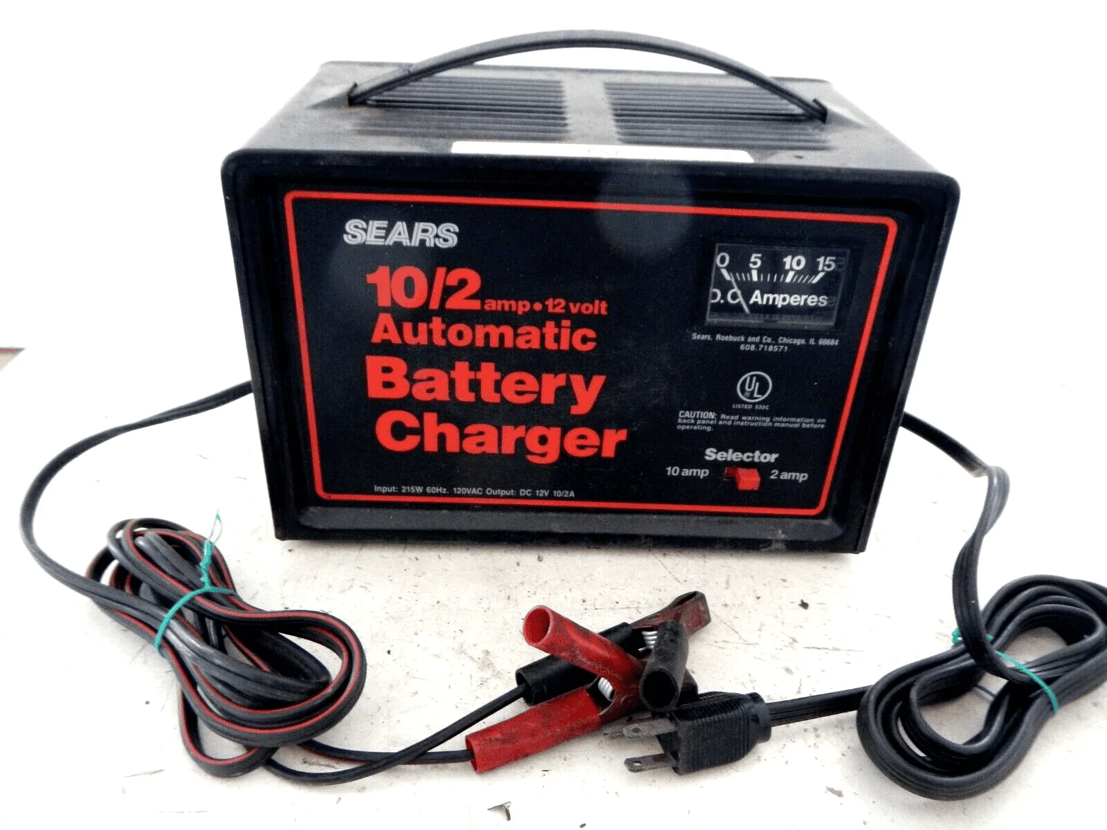

Since this thread's about a dead battery and charging from a low voltage, maybe one of you experts (and I'm being sincere, the stuff some of you know is mind boggling but tremendously interesting to read) can educate me on modern electrical systems.
I have a CTEK battery tender I run a few times a month and let it go overnight to do it's thing. I also carry a jump pack, just in case. From what I know, these are safe to use.
But ... if I were ever in a situation where the battery went dead, can an old school 10 amp charger still be used or is that asking for trouble?
I still have this "vintage" one that works and I've used on my FJ40 for 40+ years.
I've got two of those, except mine have 12 hour mechanical timers! One I purchased way back for me and another for my now deceased father - Both still work great! I've several smart chargers but sometimes you need raw brute force.
