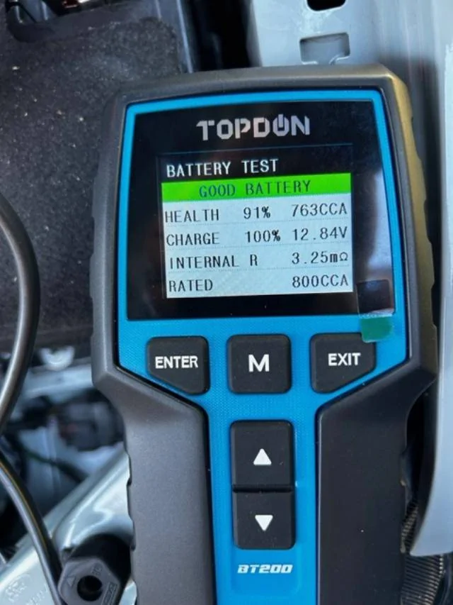

Battery Health Comparision.
All OEM settings - 22 Lariat 8,965 Miles 13 months of ownership, battery maintaining. status quo.
Jan 2023
Oct 23 (Today)
Jan 2023
Oct 23 (Today)
So you have no mods or BMS changes and this is battery health so far? Not bad.

It is not bad, but notice the actual CCA is already slipping below the Rated CCA.... and resistance has started to climb. The battery is still in good shape, but the symptoms are already beginning to show themselves. The desulfator may be all you need, but it will not run as often due to the charge voltage being below the rate needed to activate it for a large period of time. It's that 75% SOC thing again.
My 18 month old Ford battery was in worse shape initially. Noticed that the CCA more than doubled... and it exceeded the manufacturer's rating! I see trhe same results on all my autos, 2005 Ranger, 2023 CX-5, and my 93 Miata LE.
Ford Battery Rated at 760 CCA
Initial starting measurements after receiving a Low Battery Warning - Battery 18 months after purchasing the truck ~6,000 miles
Voltage = 12.37
Internal Resistance = 5.19 mOhm
CCA = 485.7
Current Reading 18 Months Later
(Newer Battery Tester gives me SOC and SOH)
State of Health = 100%
State of Charge = 100%
Voltage = 12.66
Internal Resistance = 3.06 mOhm
CCA = 980
Both measured with battery at rest over night.
