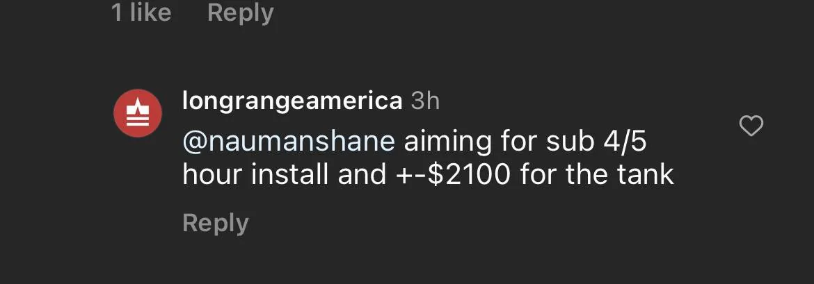

LRA on IG said approx $2100 just for the tank. My local LRA dealer said approx $300 shipping and $700-800 install.

This is a prototype tank. LRAM are using this tank to figure out bracket placement, hose length, etc. They are looking to have tanks build and in the warehouse sometime in October-December. They are working on an install video as well. The goal is to have this install take 3-5 hours.
