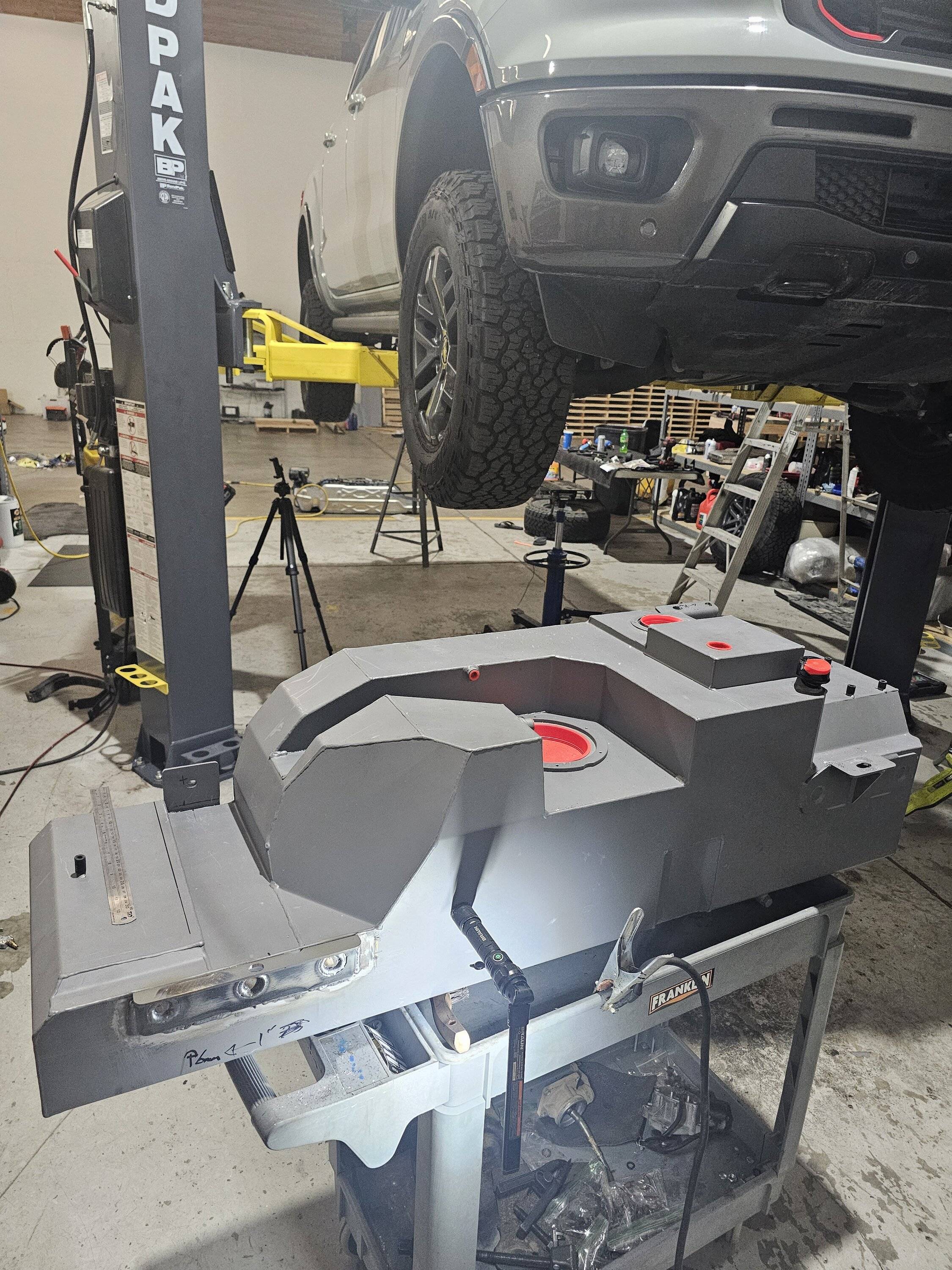

Long Range America tank being installed! Should be ready to drive home tomorrow! 37 gallons. This puts me around an 800 mile per tank range. The tank doesn't sit low enough I'd be worried about hitting anything on a trail. Rock rails and differentials will be the deciding factor for trail lines.
Not low enough to worry about it, but lower than the factory unit? Lower than the bottom of the panels? I'm still interested in seeing a final product installed, good luck today.

I will post more/better photos when it's back down on the ground.
What was the process for getting ahold of one? Is this a prototype or production unit? Very interested to see additional photos and more information about your installation process.
This is a prototype tank. LRAM are using this tank to figure out bracket placement, hose length, etc. They are looking to have tanks build and in the warehouse sometime in October-December. They are working on an install video as well. The goal is to have this install take 3-5 hours.
