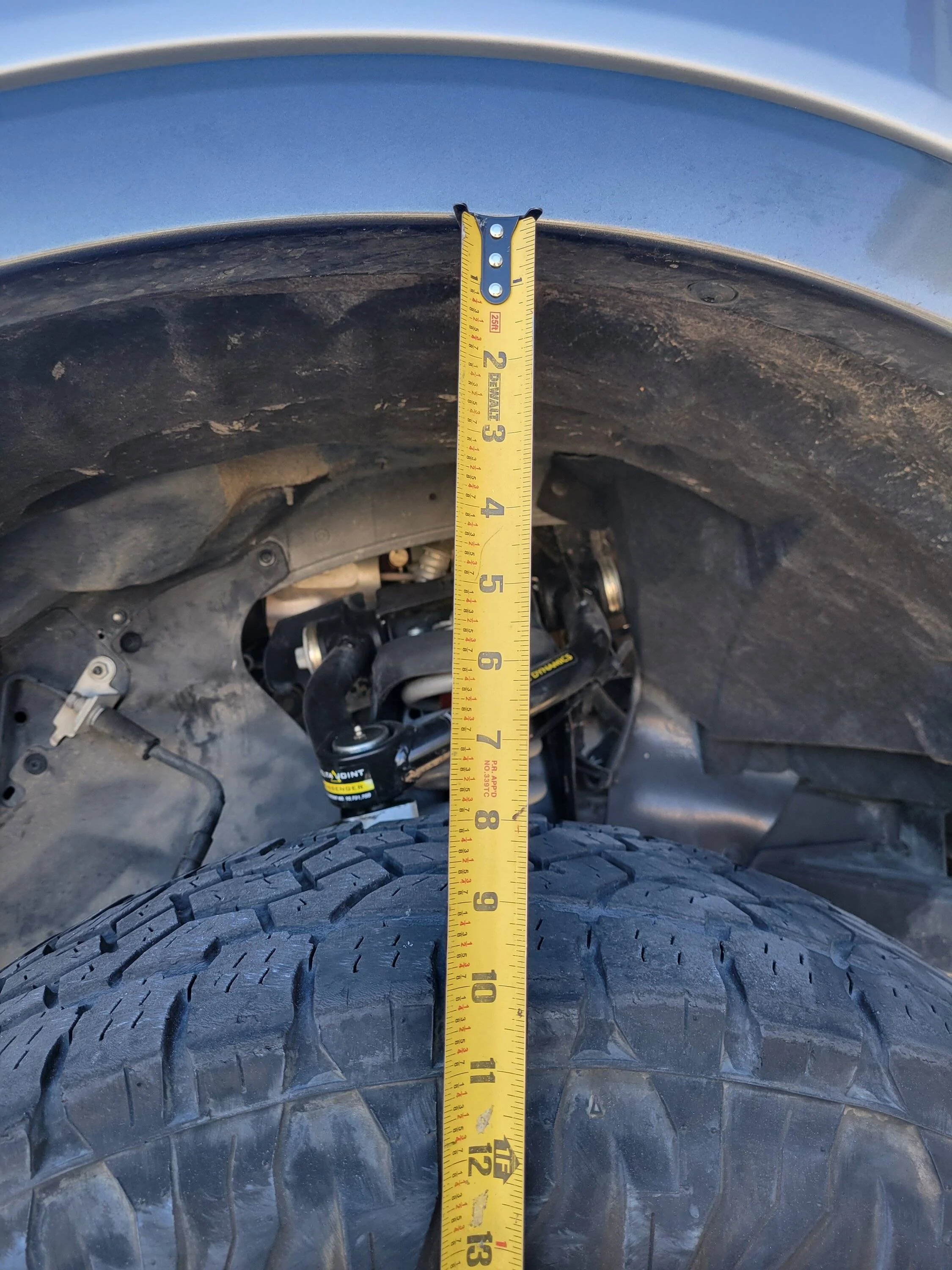

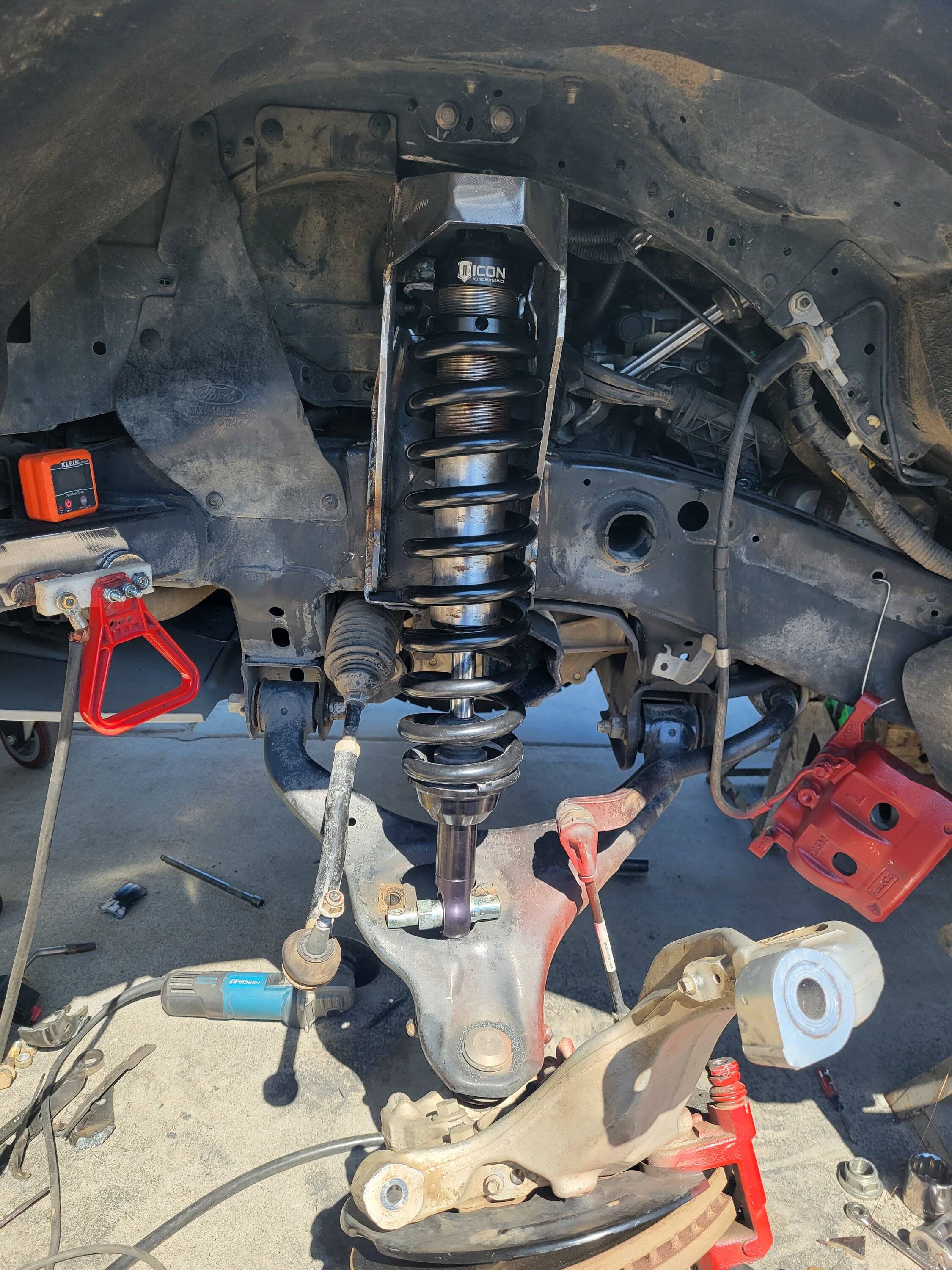

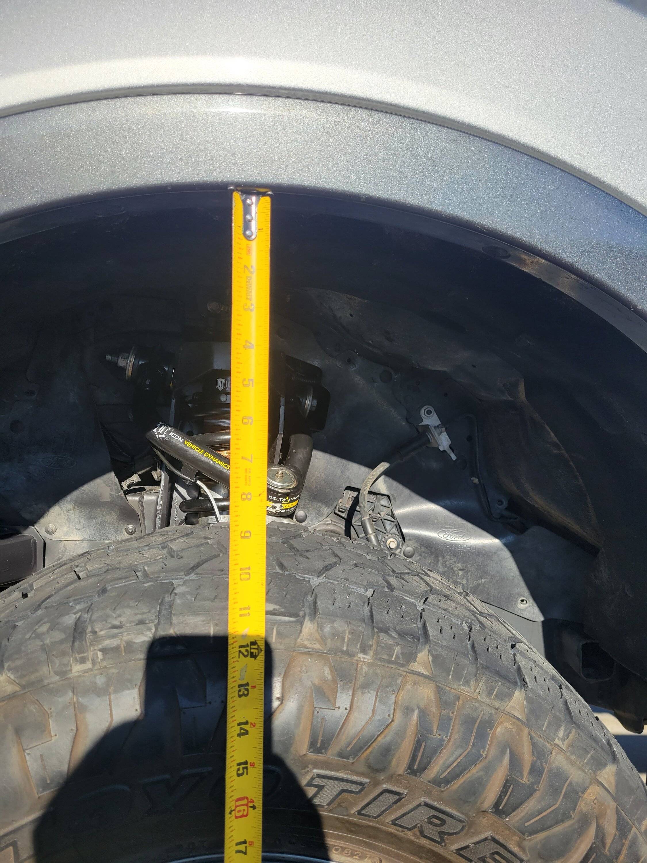

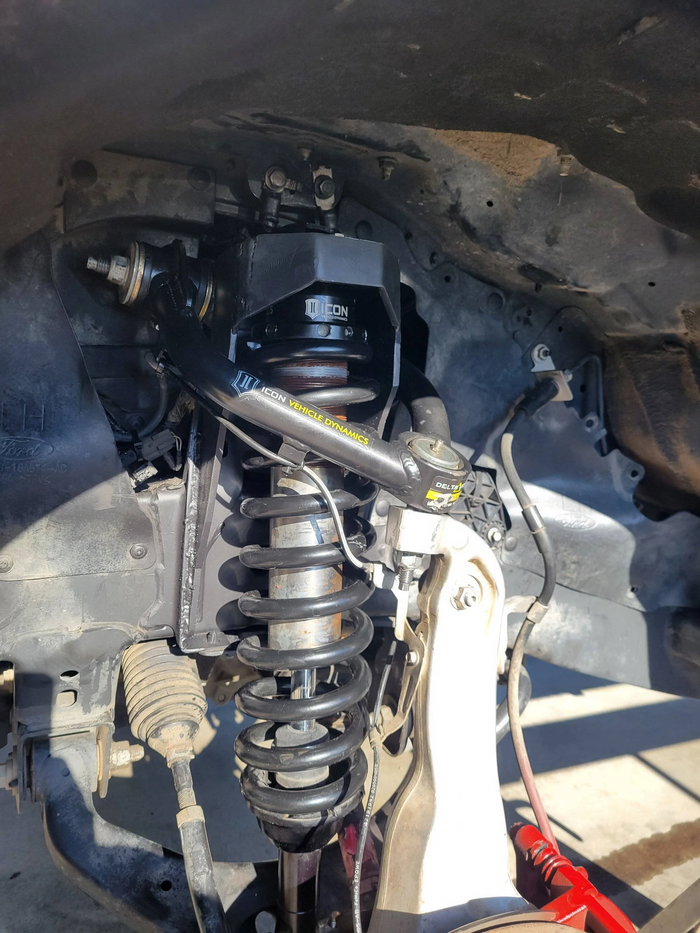

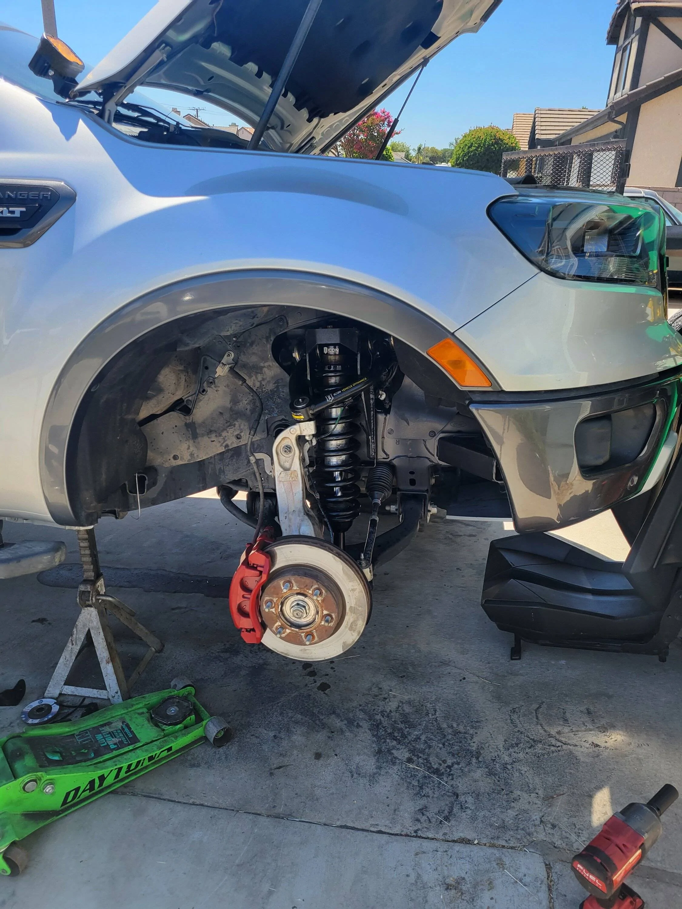

Got driver side done and mounted. Gained 2 inches of travel, still need to adjust to same height as rear of 42"

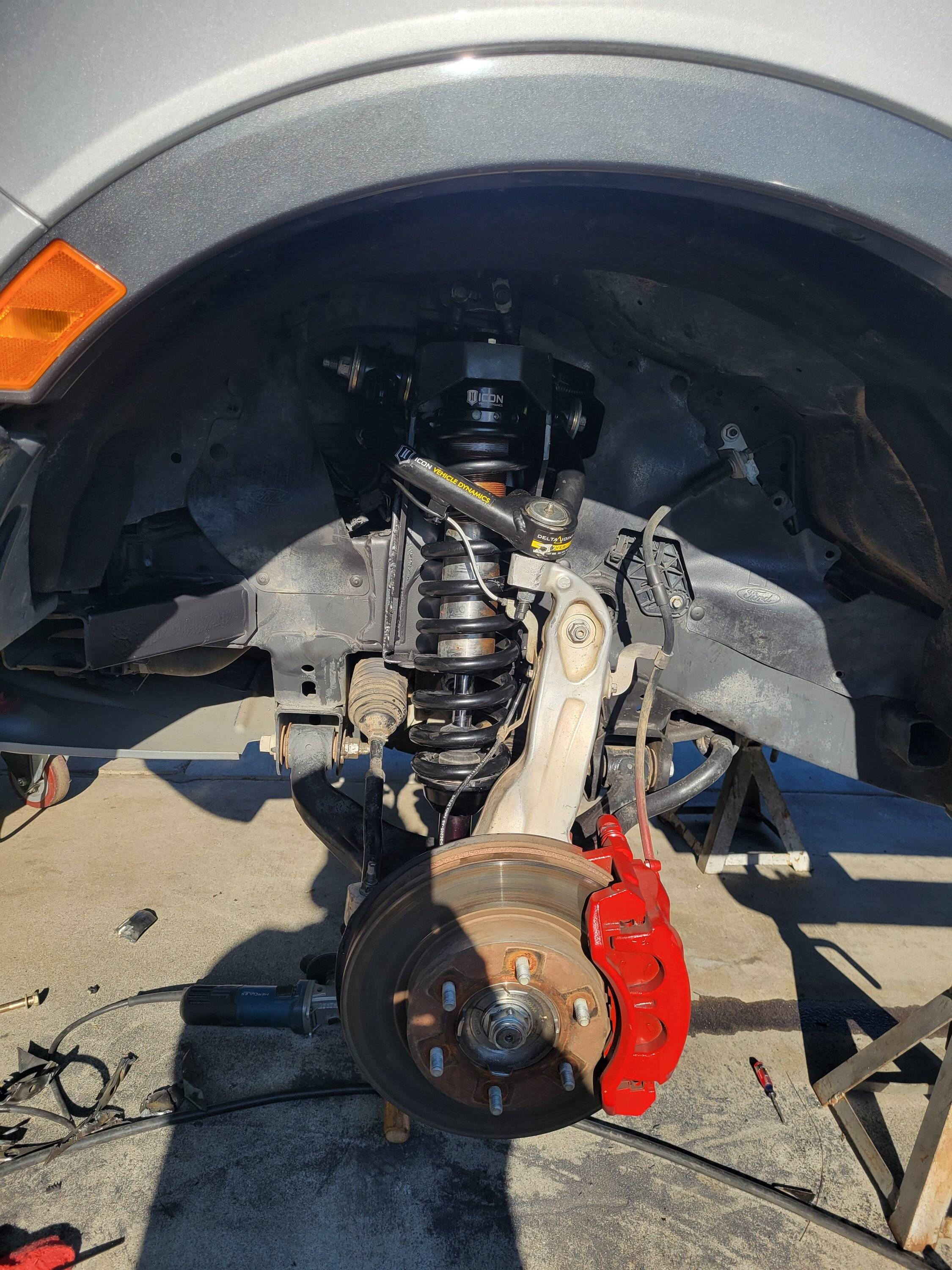

Missed a picture
Venom_z89
Venom_z89
Edson
Apr 16, 2021
512
1,830
So Cal
2019 Ford Ranger fx4
Forklift technician
Swap complete, man does she feel smooth upfront i was able to hit 60 on a washboard trail it stayed pretty planted.
gryder
Garrett
Feb 1, 2021
131
152
2019 Ford Ranger Fx4
Looks good Venom, will definitely be following this build! You made the mounts look like it came from the factory like that.

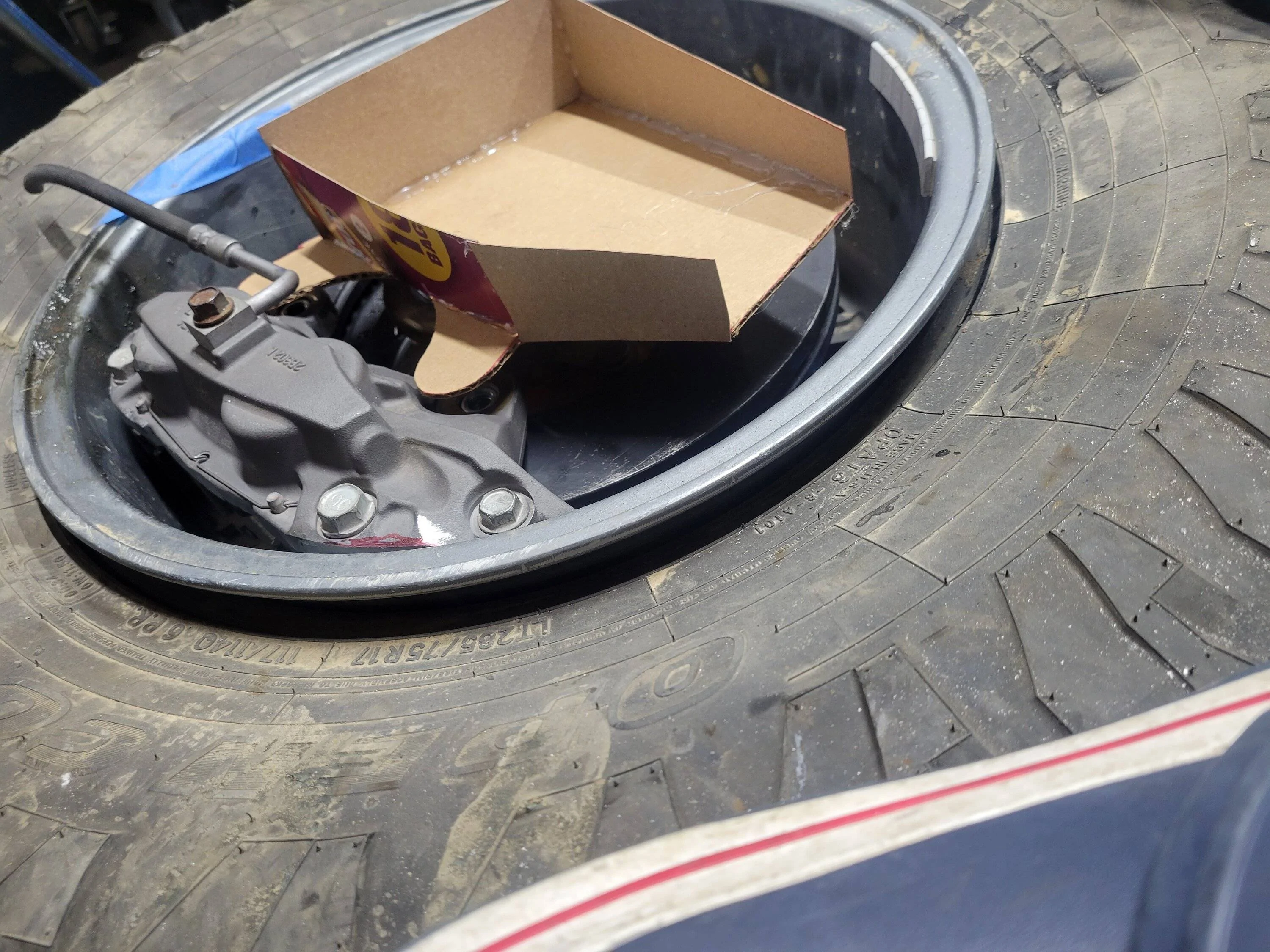

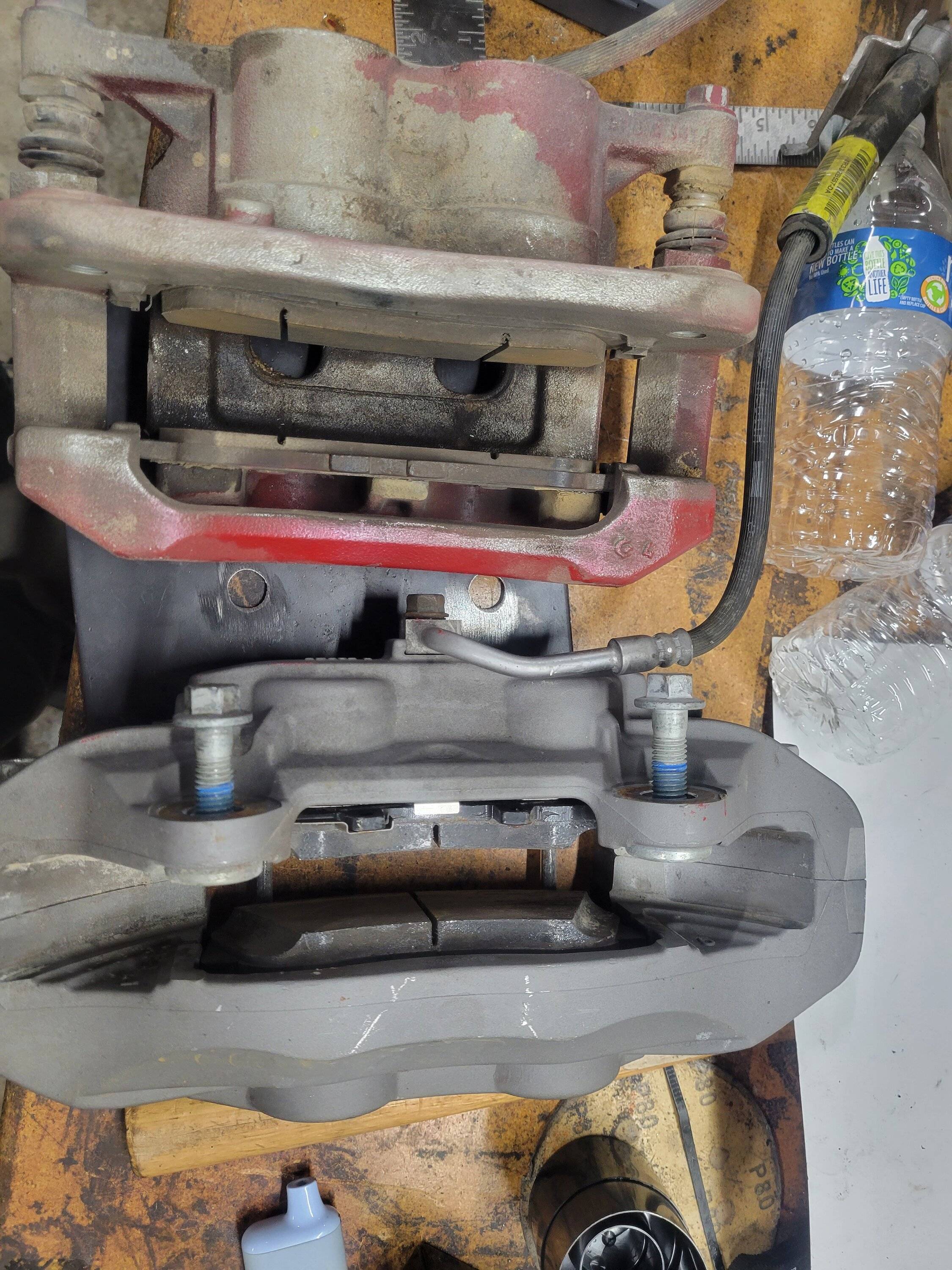

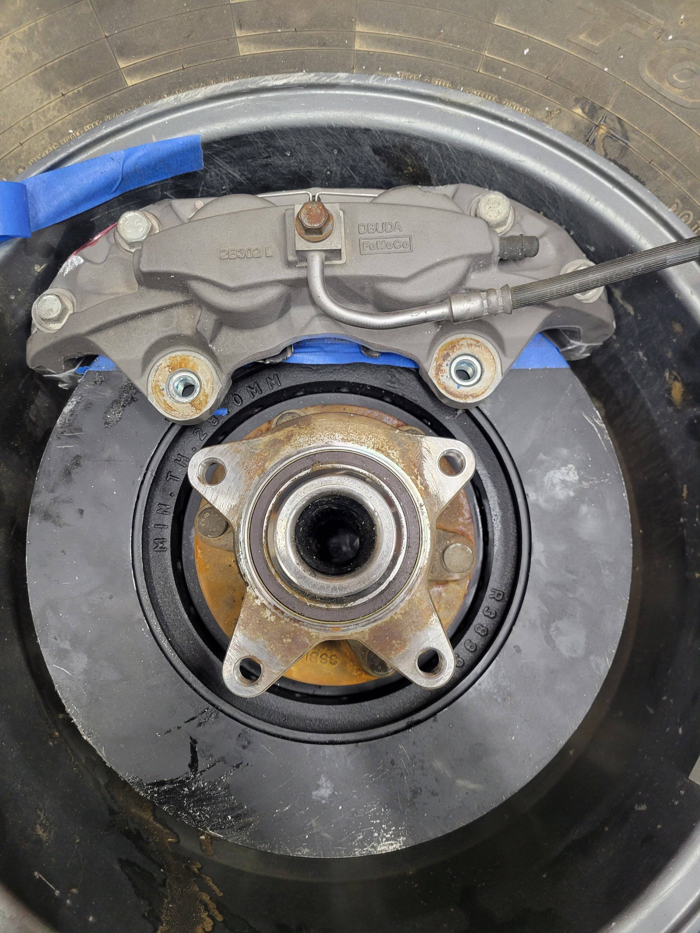

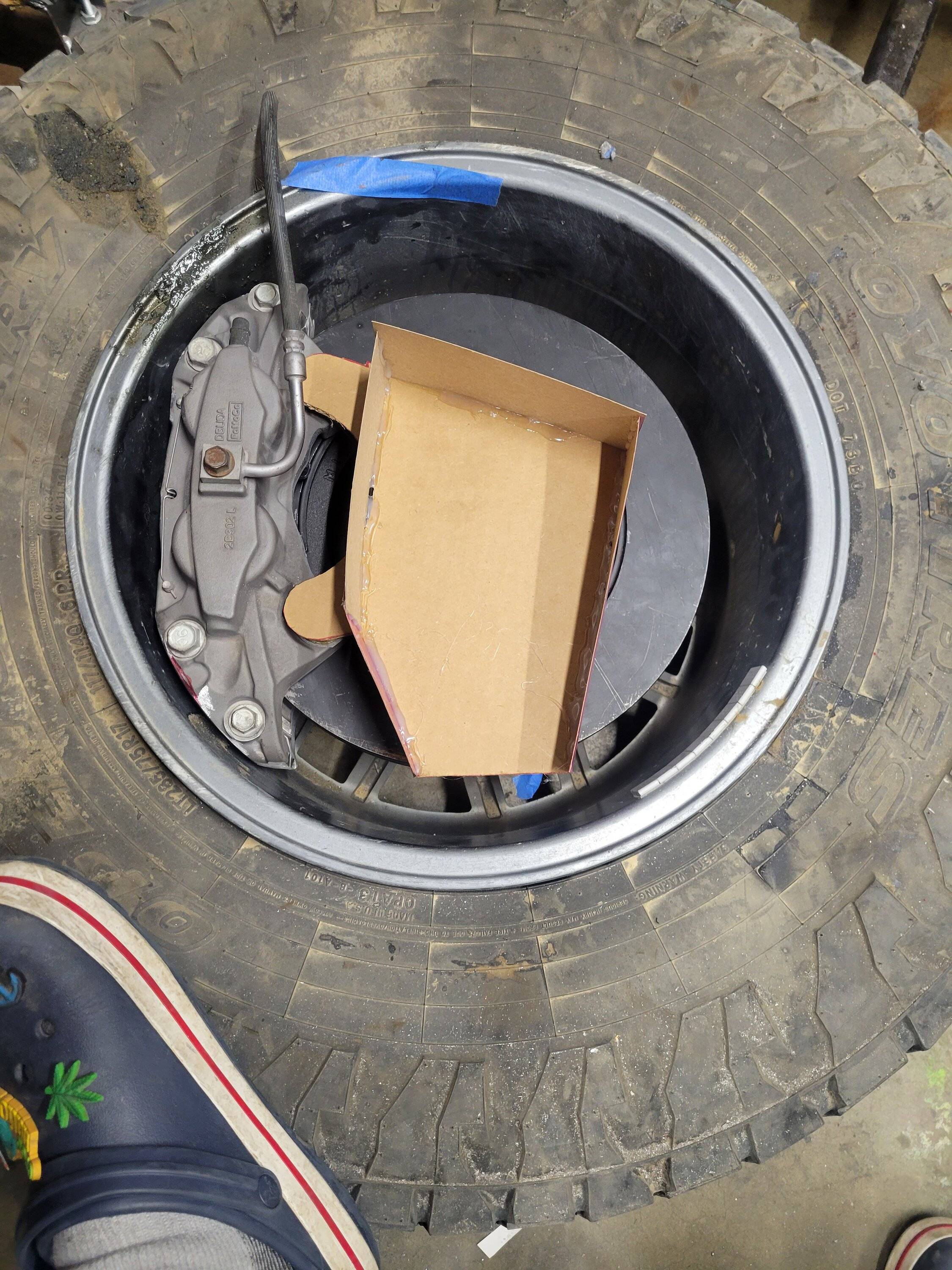

I did some parts cross referencing using parts catalogs to determine sizes and find a nearly cheap and alternative to big brake kit i want to do. I found that silverado/escalade 14" rotors will work best. This i believe to be the most reasonable solution as i tried looking for vendors that sell 14" rotors for ranger bug brake kits all i found was full kits, and rotors not sold individually which i think is a bad practice. The escalade rotors can eaily be found at a parts store. Stop tech rotors cost 100 bucks eac. They have the thickness of mustang gt rotors with mounting surface a measurements nearly identical to rangers minus hub bore. Hub bore will have to be bored from the 78mm to 93mm which should be easy enough with a router or taking to a machine shop. Calipers i will use are 4 piston mustang gt calipers can be got for cheap on ebay which means youll have a plethora of brake pads available not to mention same mounting points of a 6 piston if wanting to go bigger later. Also again the ease and availability of getting parts locally without some huge markup is what im going for

Rear will consist of similar items escalade rear rotors and gt calipers. I will also be getting hub centric 6mm spacers that will actually go behind the rotor kind of like in some 70s cars.

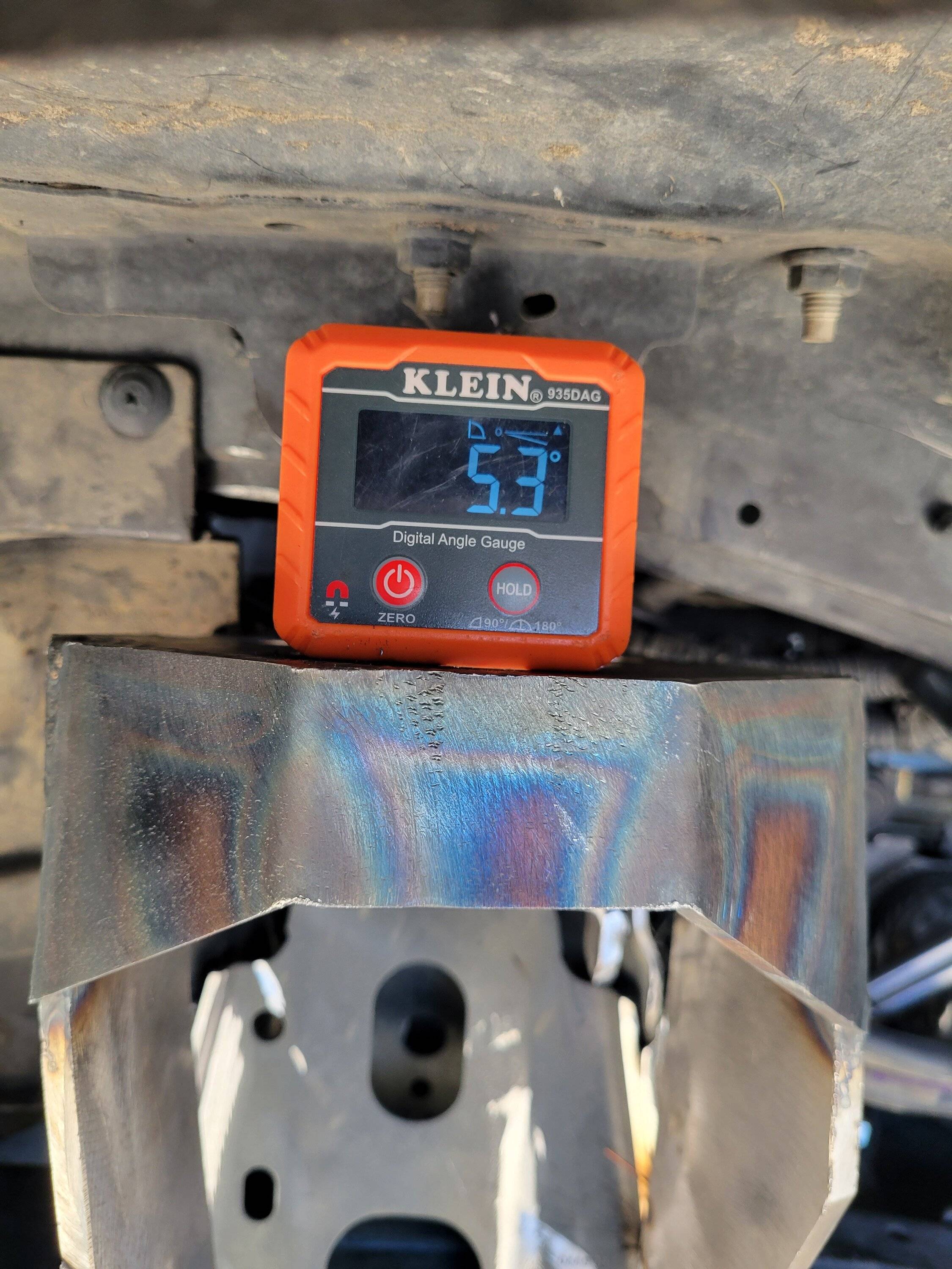

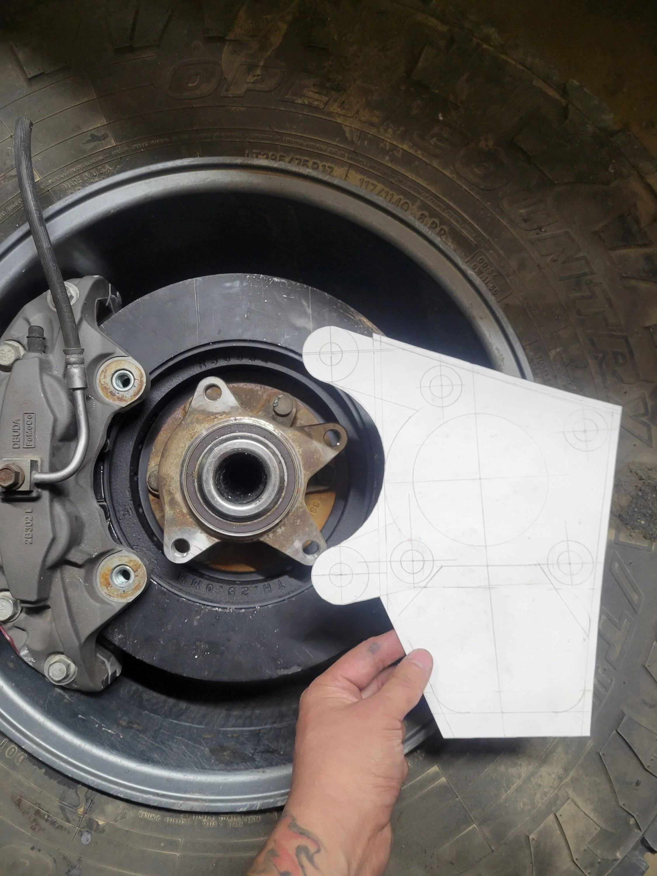

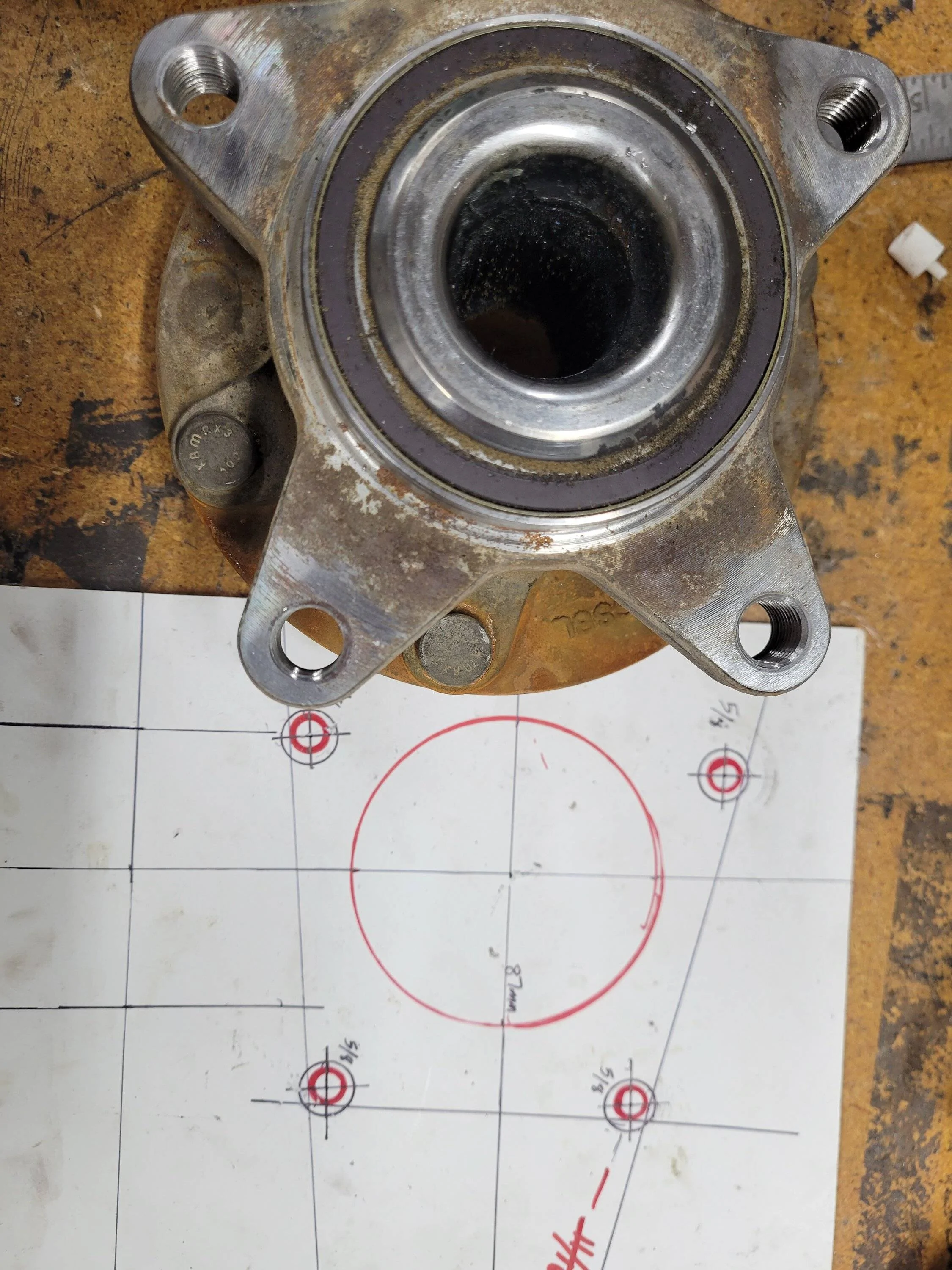

Beginning stages of a fully boxed spindle along with templates and jig. My spindle will incorporate oem bronco/ranger bearing, abs sensor, and musang calipers and escalade rotors.

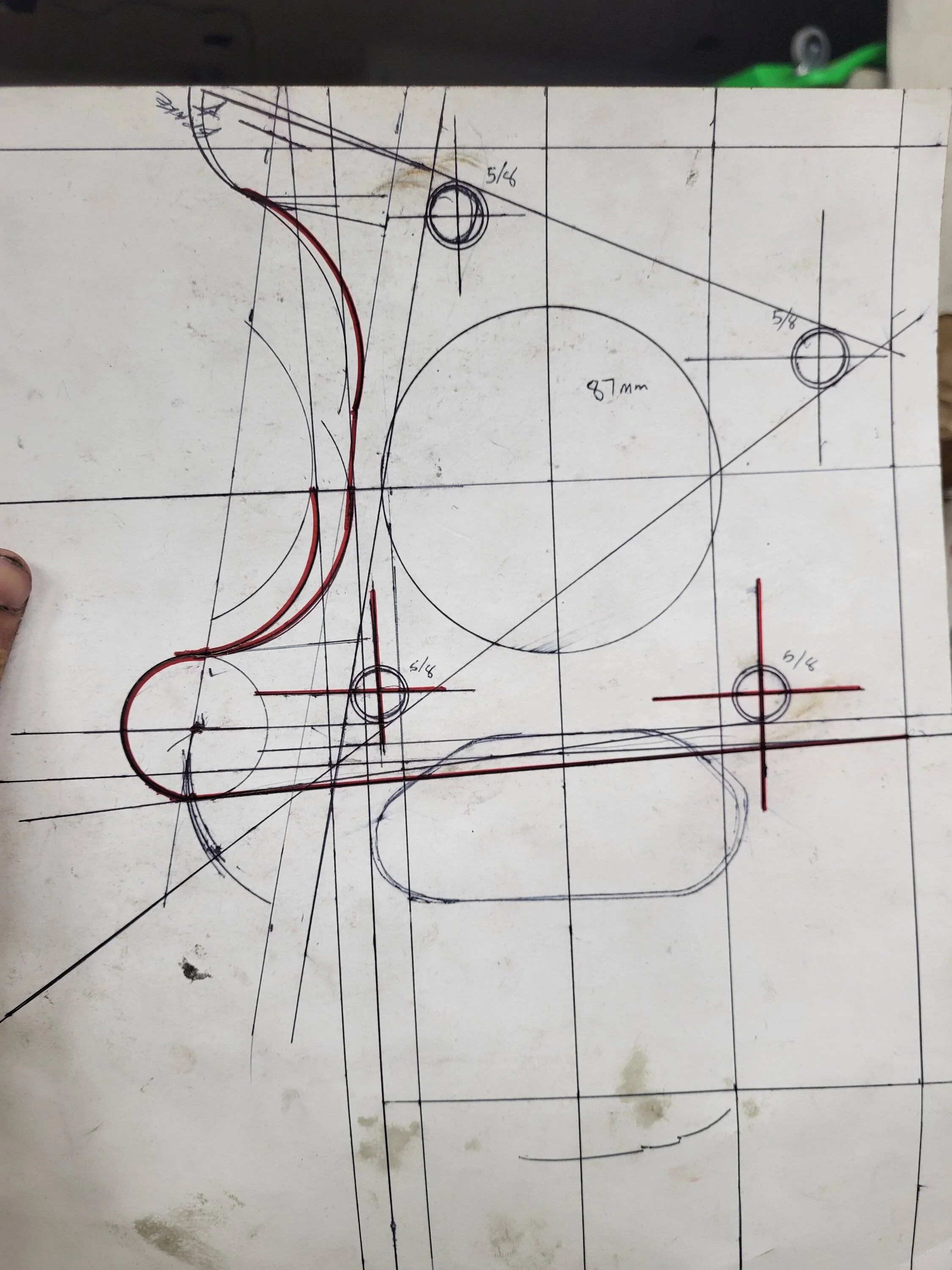

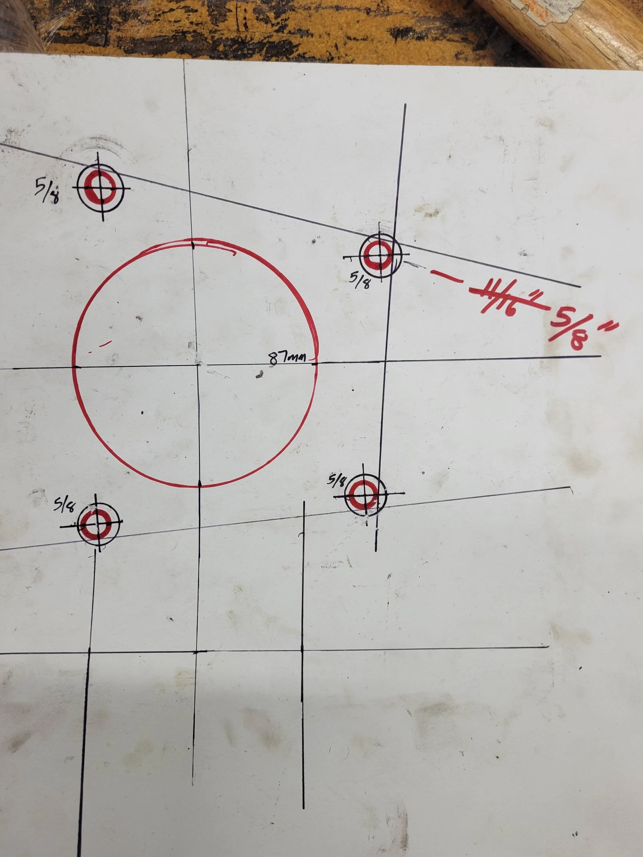

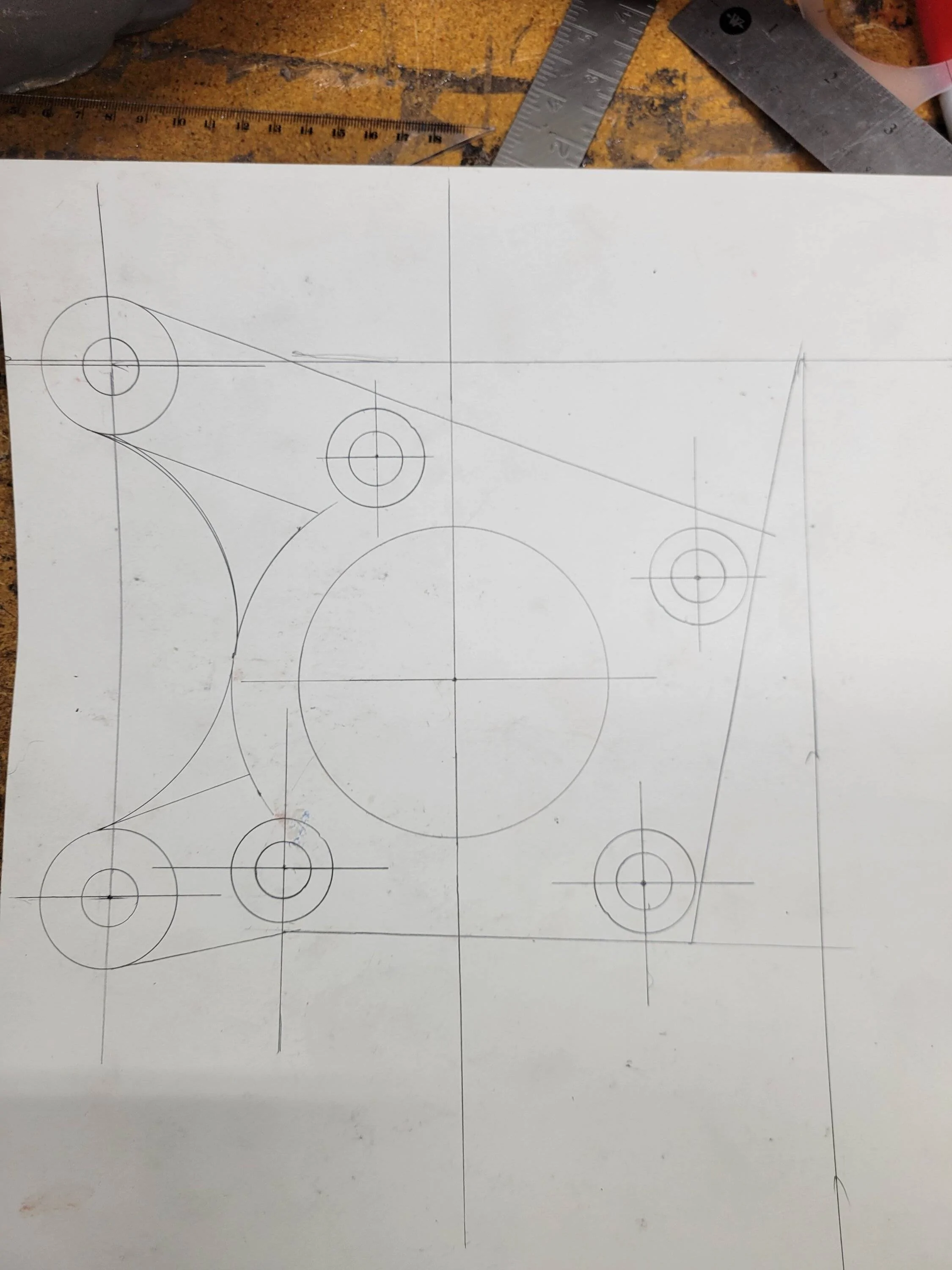

Spindle face roughly drawn out. Still need to add the mount for the lca uniball

Too much math and skill for me.
If I tried this I'd be a dumb ape throwing sticks at it while swinging around the rafters in my garage grunting and pounding my chest.
Lol its been like that at times lol

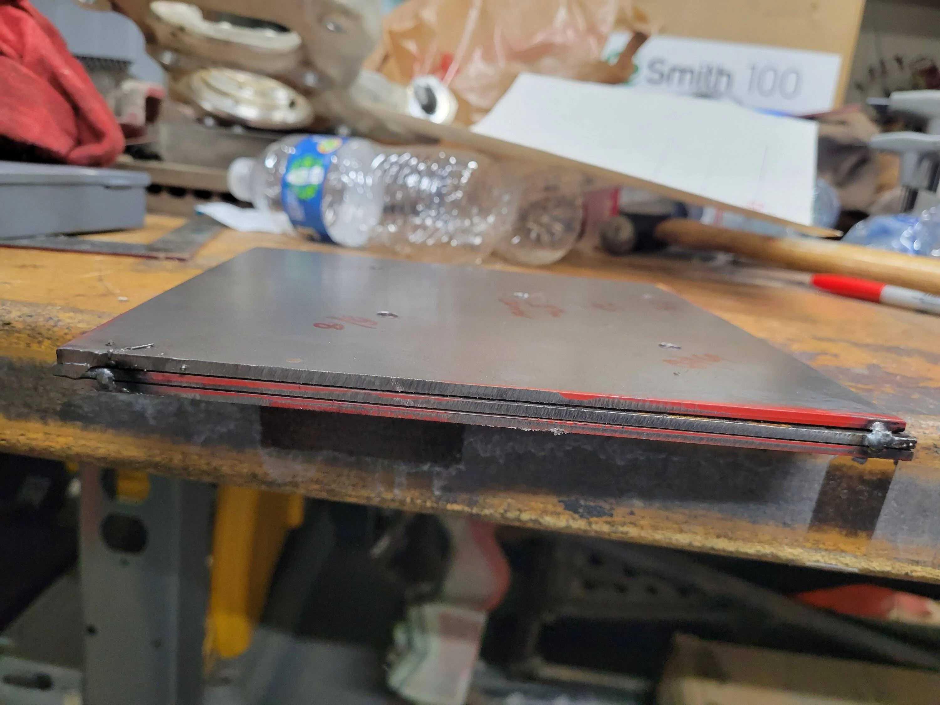

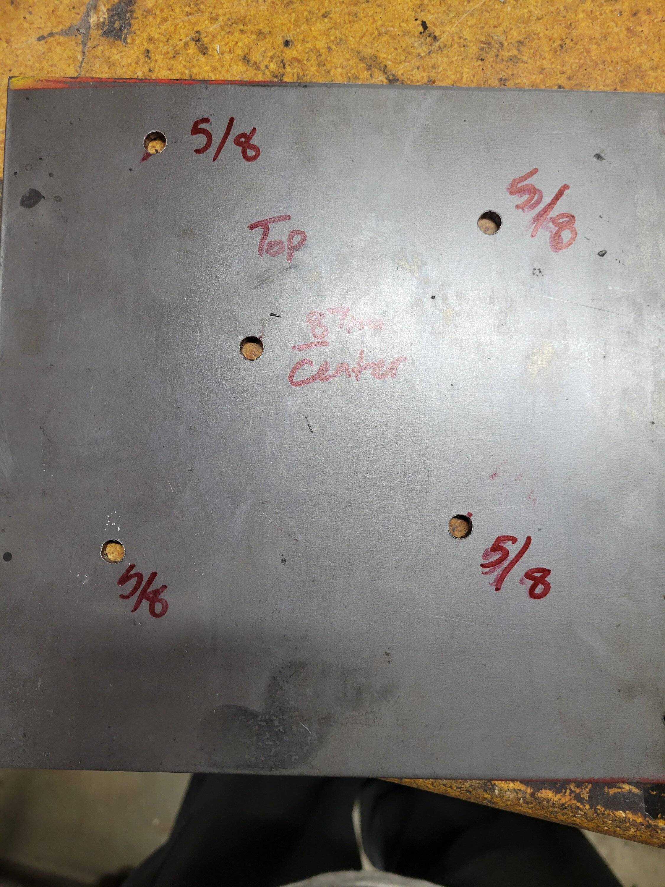

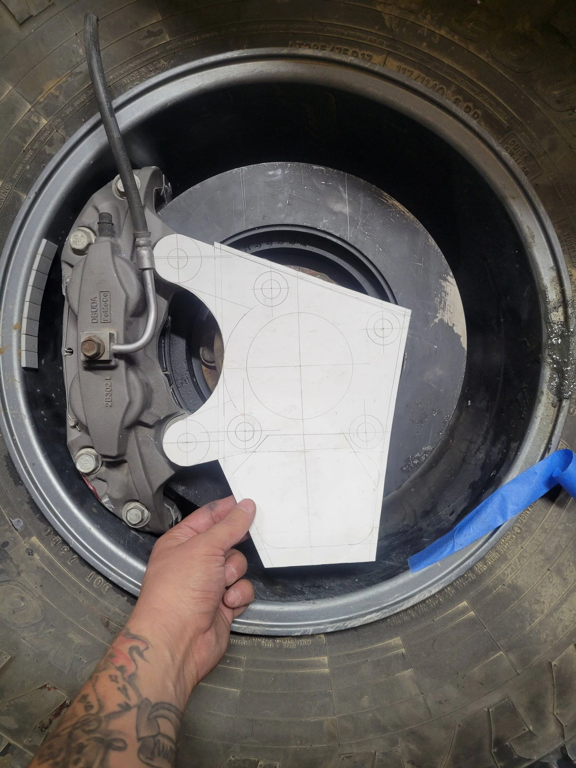

Will be taking this to get water jet once the boxed portions are designed. Which are acounted for in my template below.

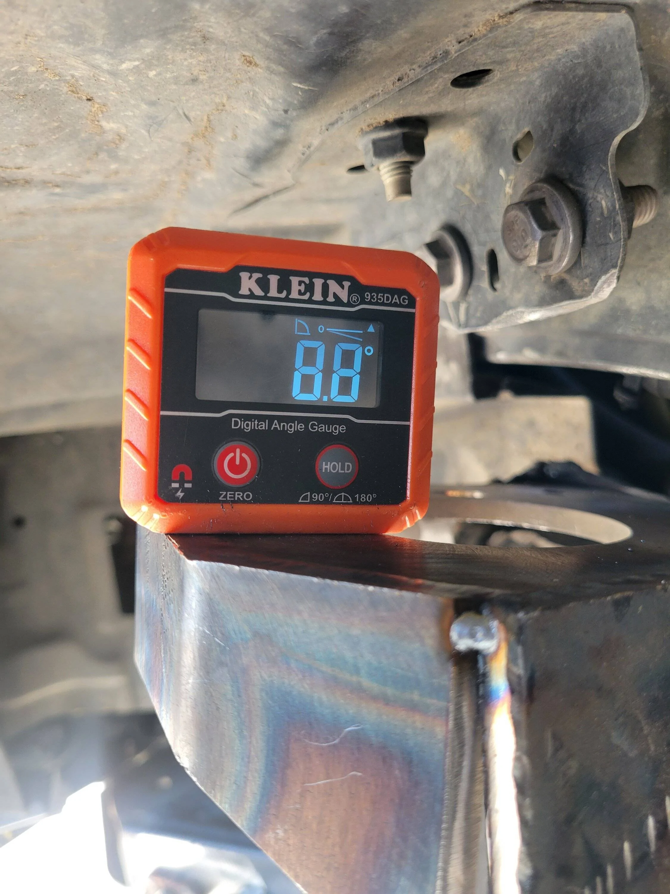

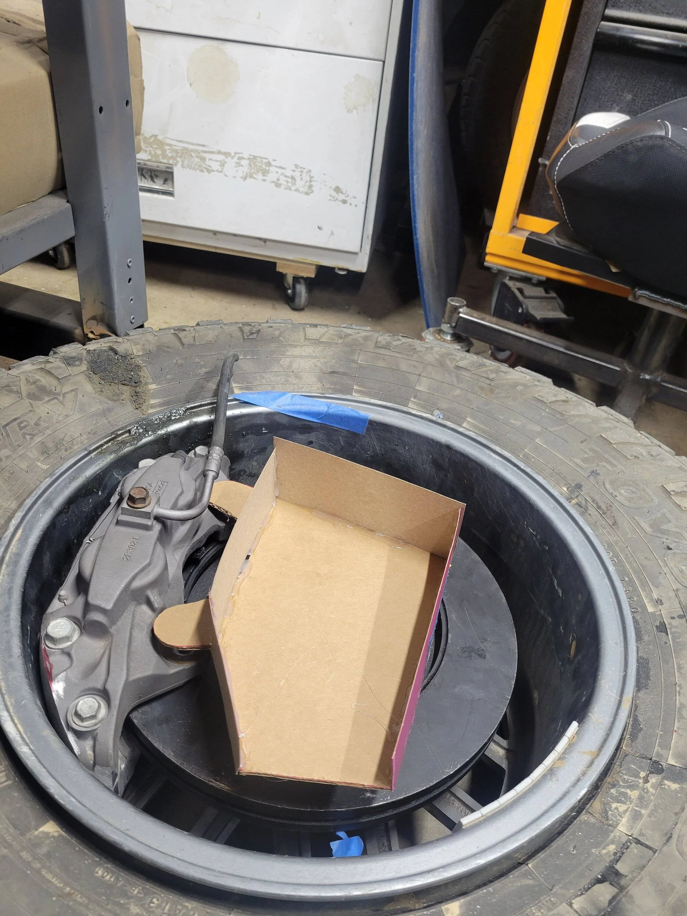

Some rough boxing

I haven’t posted on here for a bit so here’s quick update. Hoss 3.0 steering rack ordered and paid for, Chevy c85 leafs springs paid for and ordered, all shocks, coil overs, and bump stops ordered. Huge huge shout out and thanks to walker at final frontier Motorsports for all my suspension needs. Bronco 315/70s 17 got all 5 headlock capable wheels. Still need to buy axles front and rear, think I’m changing to 2010 mustang 4 pot Brembo they seem to be smaller footprint with same specs as s550 get 4 piston. They’re roughly same cost on eBay.
