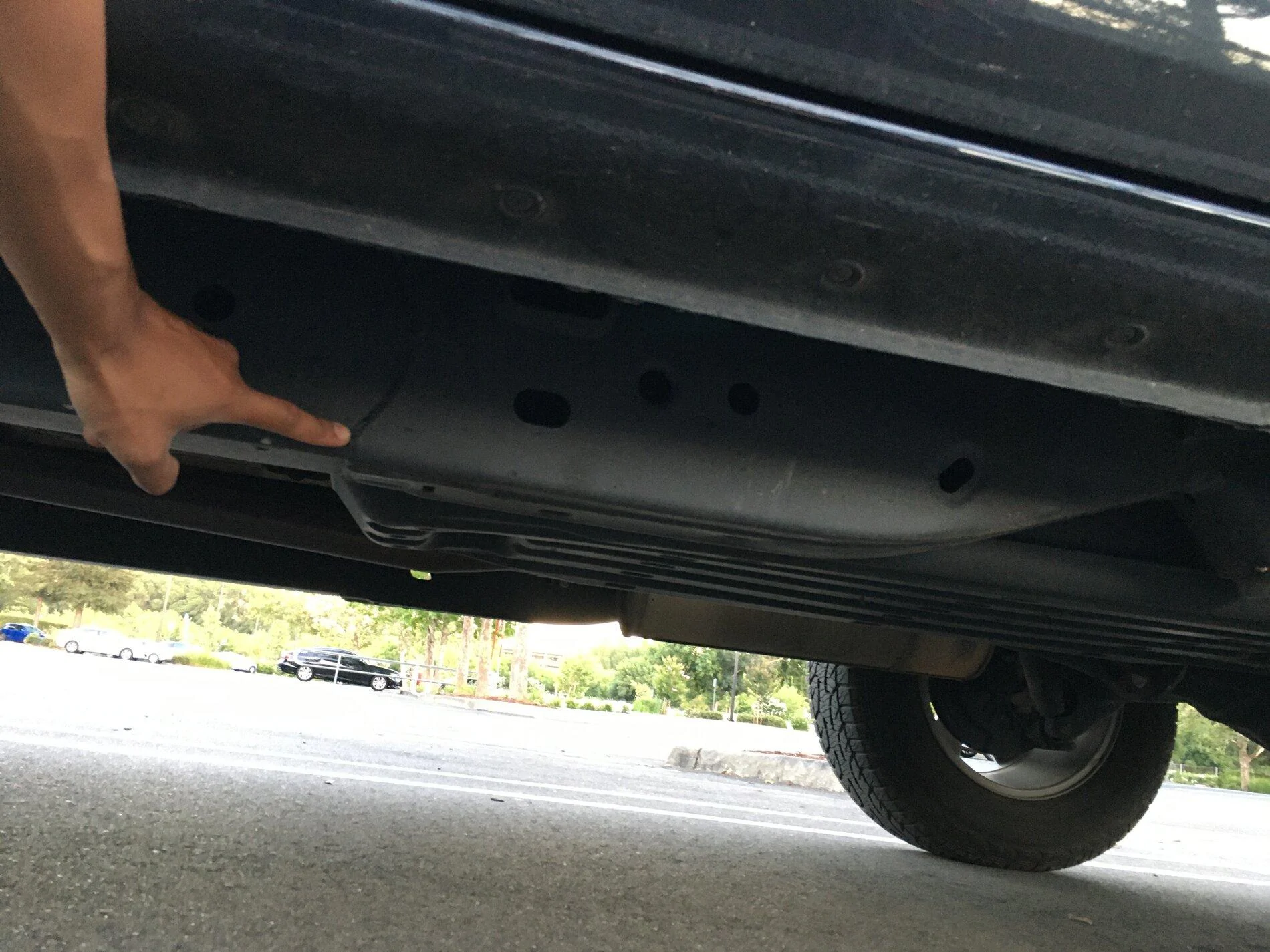

Here is where the cut will happen. Well not really a cut more like a weld grind. I’ll grind out the old bead and pull the frame apart. It actually slides in a few inches.
Interesting modification. Not sure I could talk myself into doing that.

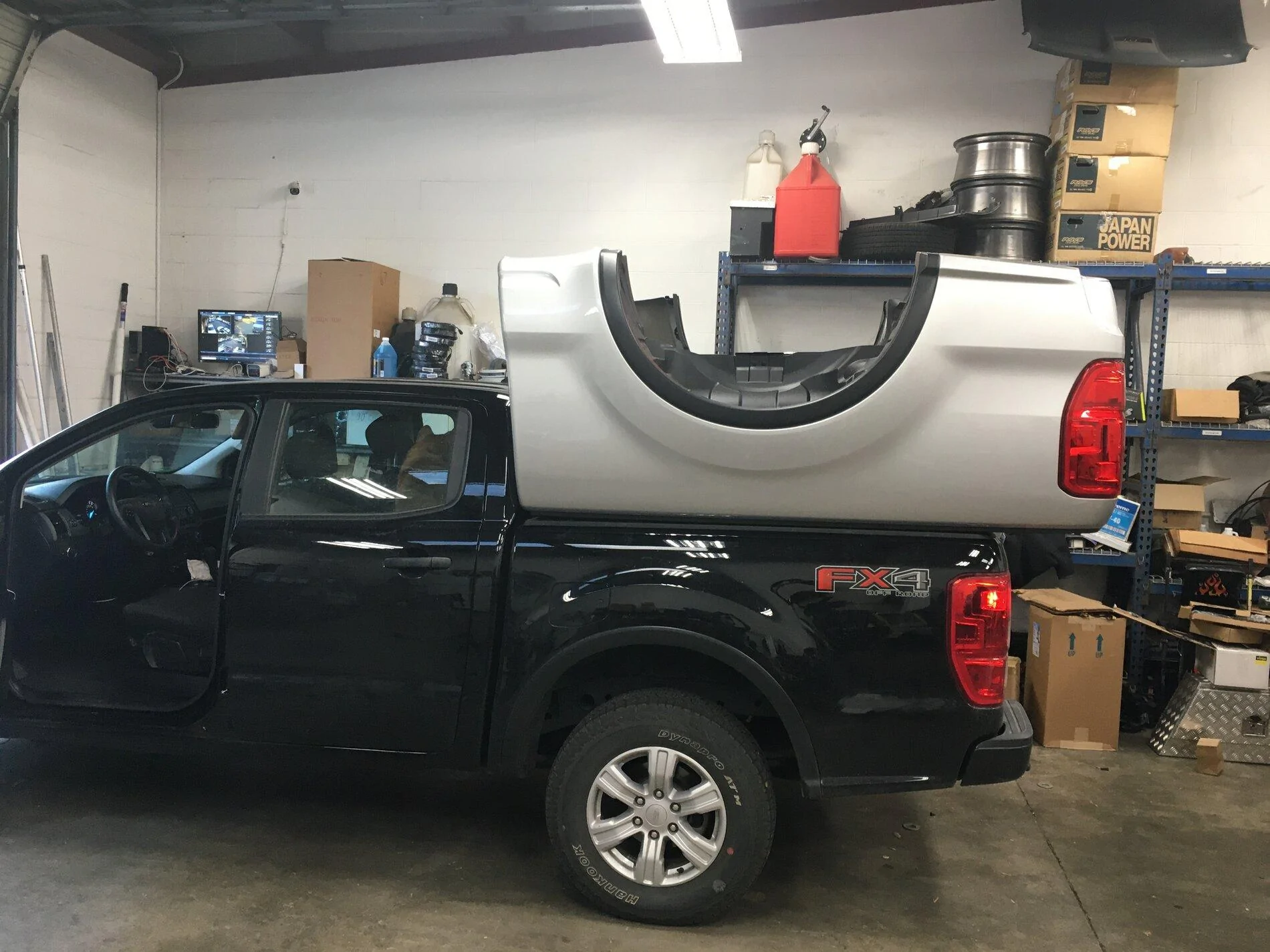

The way the frames are engineered it definitely would be tough to safely stretch at home. Would really be a nice factory option. Good deal on a bed with taillights.

So far I know of two that were done. 1 was a box truck conversion the other a accident that was turned into a flatbed on chevy 63s. It doesn't look too complex of a swap but expensive yea. You'd need new brake lines, parking lines, Stretch harness, driveshaft, as well as bed. I was just curious if this one had gotten anywhere to see how they look with a factory box.

If ya gotta do something like this , SuperCab shortbed would be the way id go ...
