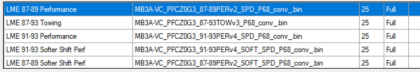

Just updated and here is what is available to me:
Try them all tomorrow and report back...Its too damn cold out there for anything right now.
Will be trying out the the version 2 soft shift towing soon.

Just got back after my maiden voyage with the 87-89 soft shift performance tune and I can tell you that WOW, that was different. Different in a great way. All the surging at shift points is gone. Feels so much more like the progression through gears as our Explorer ST with the 10 speed. Low speed groan seems to be better addressed with a more natural downshift under 30 mph. Gonna put some highway on it tonight and see how it goes, but so far so good!

Switched to the soft 91-93 tonight .... and .... not much different from the performance 91-93...a little softer shifts but still the surge at partial throttle but more firm at full throttle. Lots of power and a ton of fun... actually feels stronger than the v3 but prefer the 87-89 soft for daily though...I'll keep testing...
