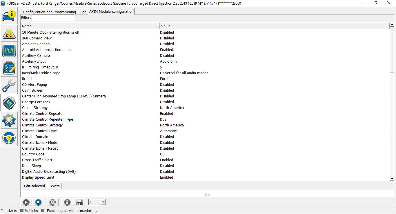

Go into the APIM module (not the asbuilt) one. Your dropdowns should look like mine (the climate section only). Im pretty sure it was climate control repeater, and both climate icons.
Here is what I used to get my climate back. Just used the dropdown menu for Forscan.
So, what it seems like so far is some of these configurations have the climate domain disabled, but climate type is Auto. The Auto setting also toggles on the voice commands for temperature. That's why the ones losing the climate UI still have voice commands. The ones that don't lose the climate UI have their climate domain enabled along with Auto type. Why that is the case...?
Just to confirm your suspicions, here is my truck data pulled from FORscan.

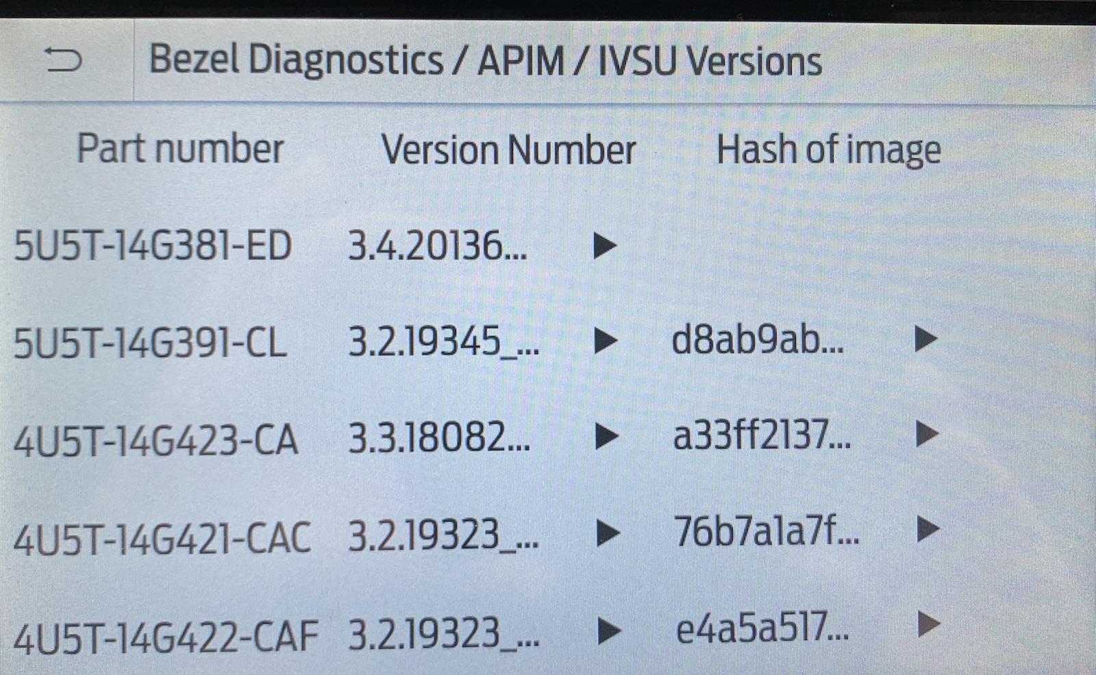

You should expect 2 automatic restarts. On initial plug in, the voice data is deleted and the first set of map chunks goes in with the license. It will then auto restart. Then the second set of map chunks go in, again followed by an auto restart. Finally, the last map chunk and 3 nav voice chunks go in. This time, when the install complete pop up is shown it will stay on screen. The system will not automatically restart itself after a few seconds.
Got the map fully loaded and Voice control works! Thank-you!
A couple comments on the map load....
This is not your problem but I wish Ford 'Vehicle Instructions' would just come out and say do not pull the USB Drive during the first 2 automatic restarts - pul it out only when the system wants a 3rd restart that needs to be invoked manually. The verbiage I read in the vehicle instructions was inaccurate and confusing. To compound matters there are on screen messages that appear before the auto restart that I took to mean "pull the plug".
From here on out I'll wait until it won't restart.
Sync 3.4 evidently does not necessarily start over if the map load procees is interrupted before it's completed...I shutdown the engine shortly after the first automatic restart yesterday. I went for a drive today and inserted the USB drive and it immediately began "Updating System Software" - It took about 45 minutes and it never did automatically reboot. But this time the message was clear: changes would take effect after the next vehicle start (or some such verbiage). Here is what my IVSU screen shows....I trust this is all correct.....
Thanks again for your help!!!!
