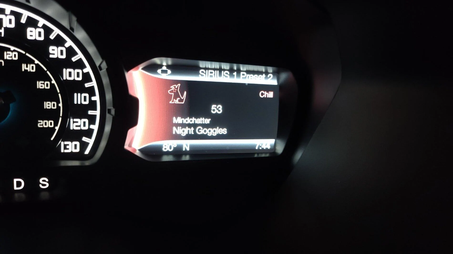

My update went great. It finally fixed the glitch of not showing XM song titles in the dash. This may sound silly but it was one of my biggest gripes about the truck. So happy!

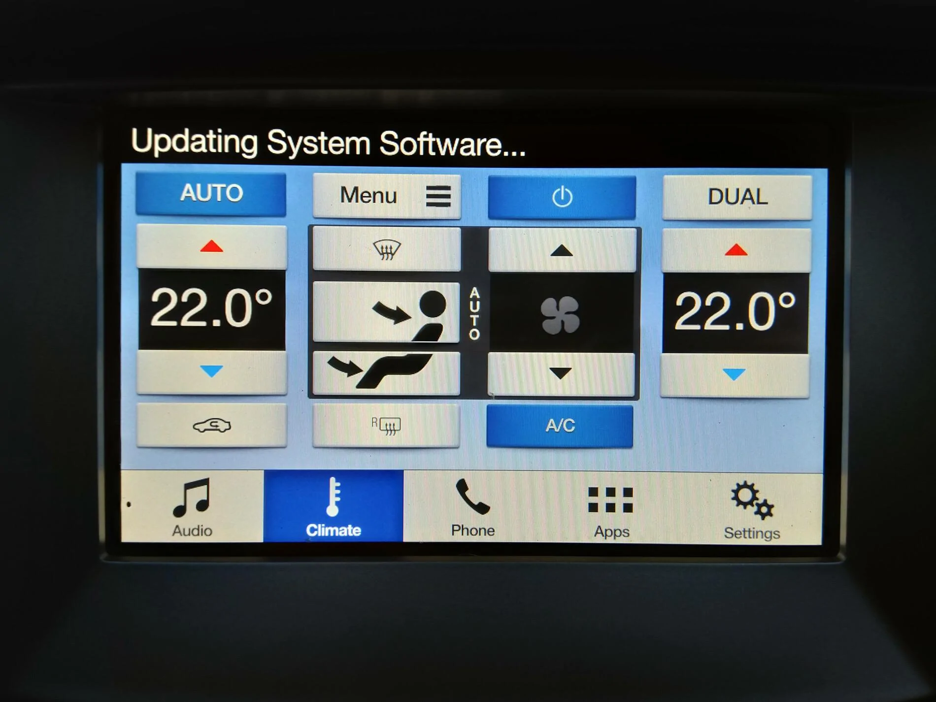

I performed the update from Ford, seemed to go smoothly but as others have reported I do not have the climate controls. 2019 Lariat FX4
I'll probably give it a few days before busting out Forscan to fix it, I didn't use that screen much.
We shouldn't have to use Forscan to get climate controls back.

Wish me luck, I'm a bit scared. Wife won't be happy if I have take this to a dealer to get sorted.
Edit:. Well that sucks. Climate controls are gone. FFS. Now I have to get this to the dealer. Don't have ForScan.

19' Ranger XLT Sport here- did the update last night, lost climate. Ford Pass doesn't work anymore either. Annoying. I don't have Forscan yet, so looks like I'm down to the manual controls only now.
