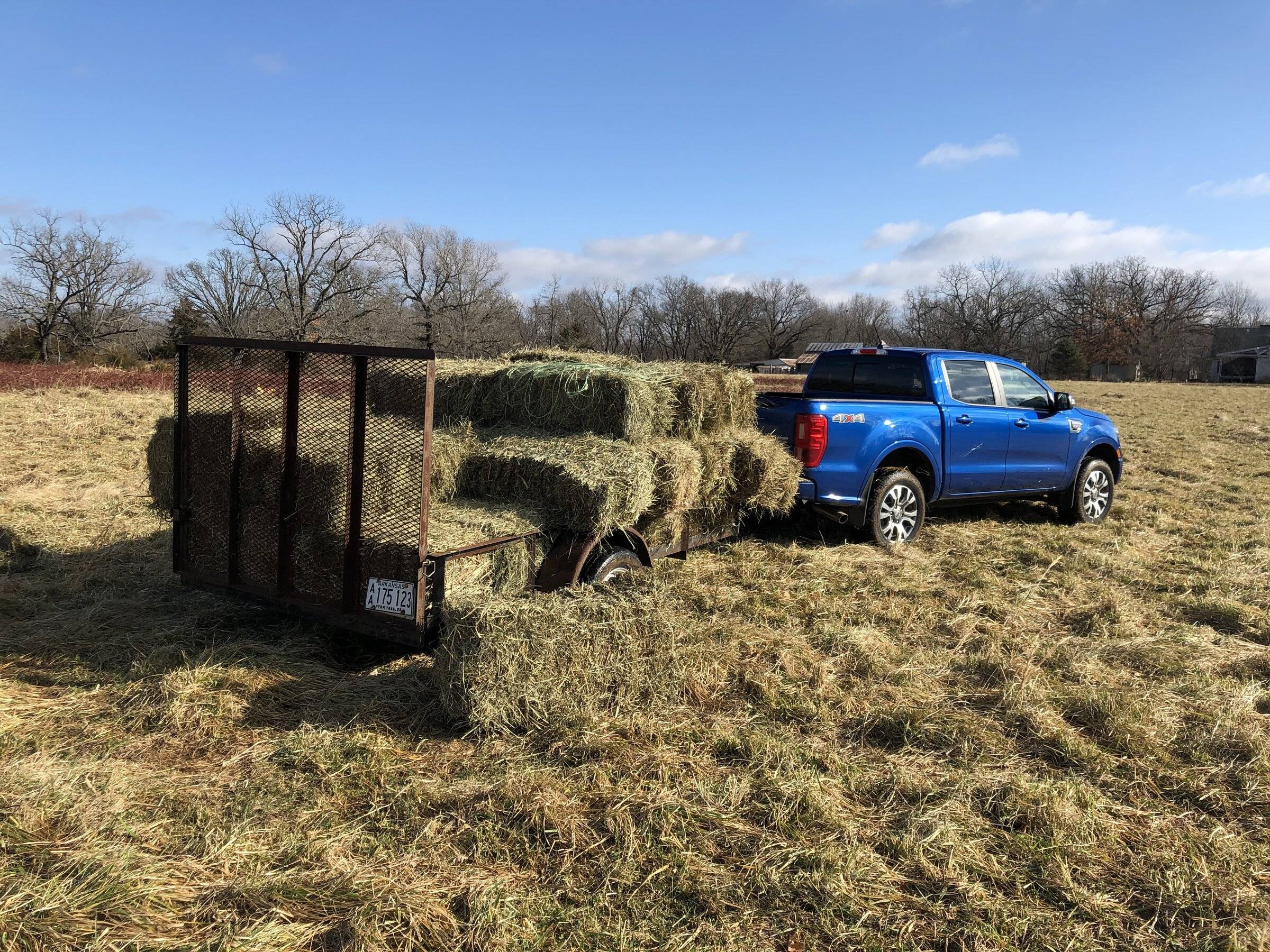

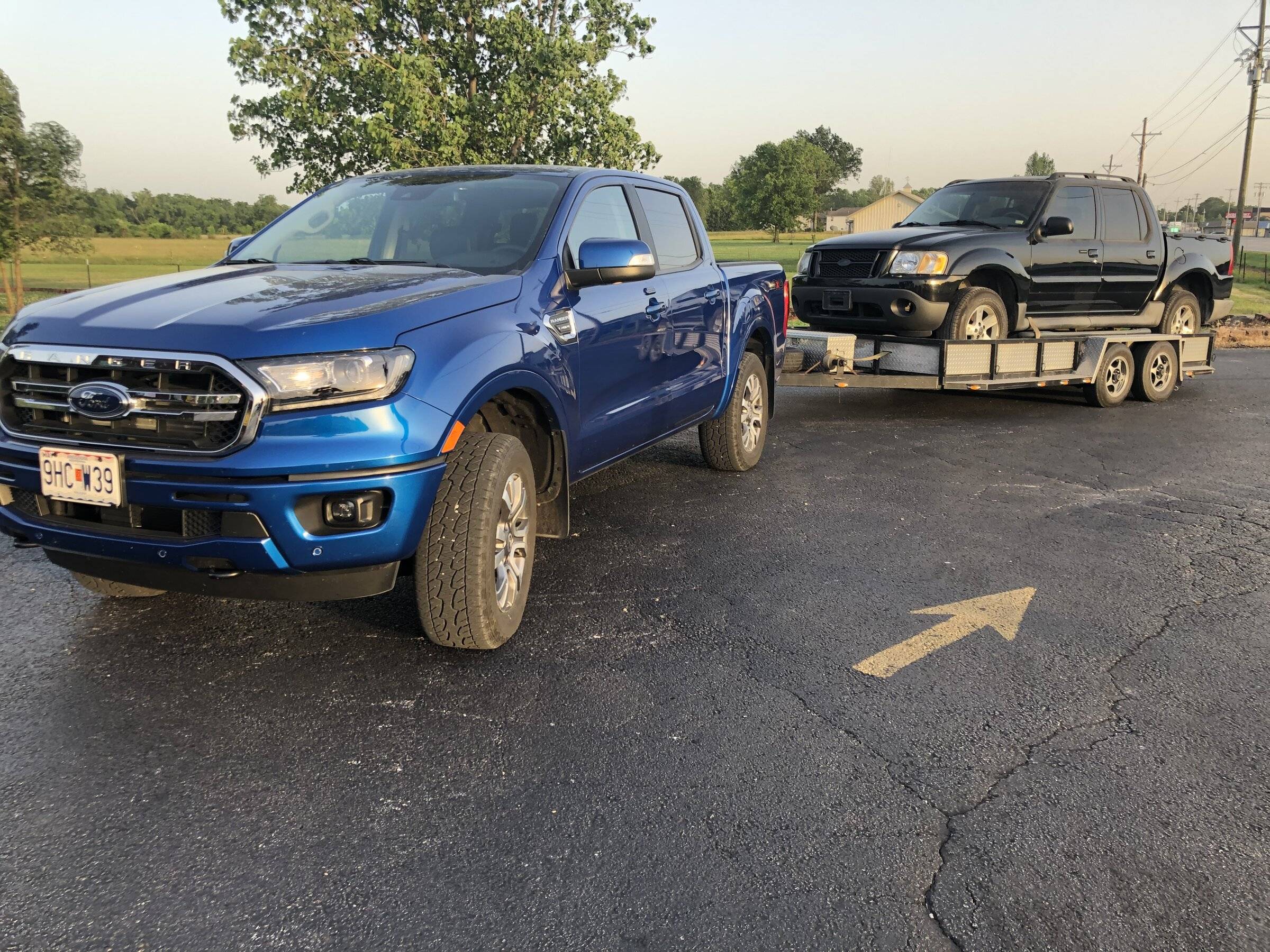

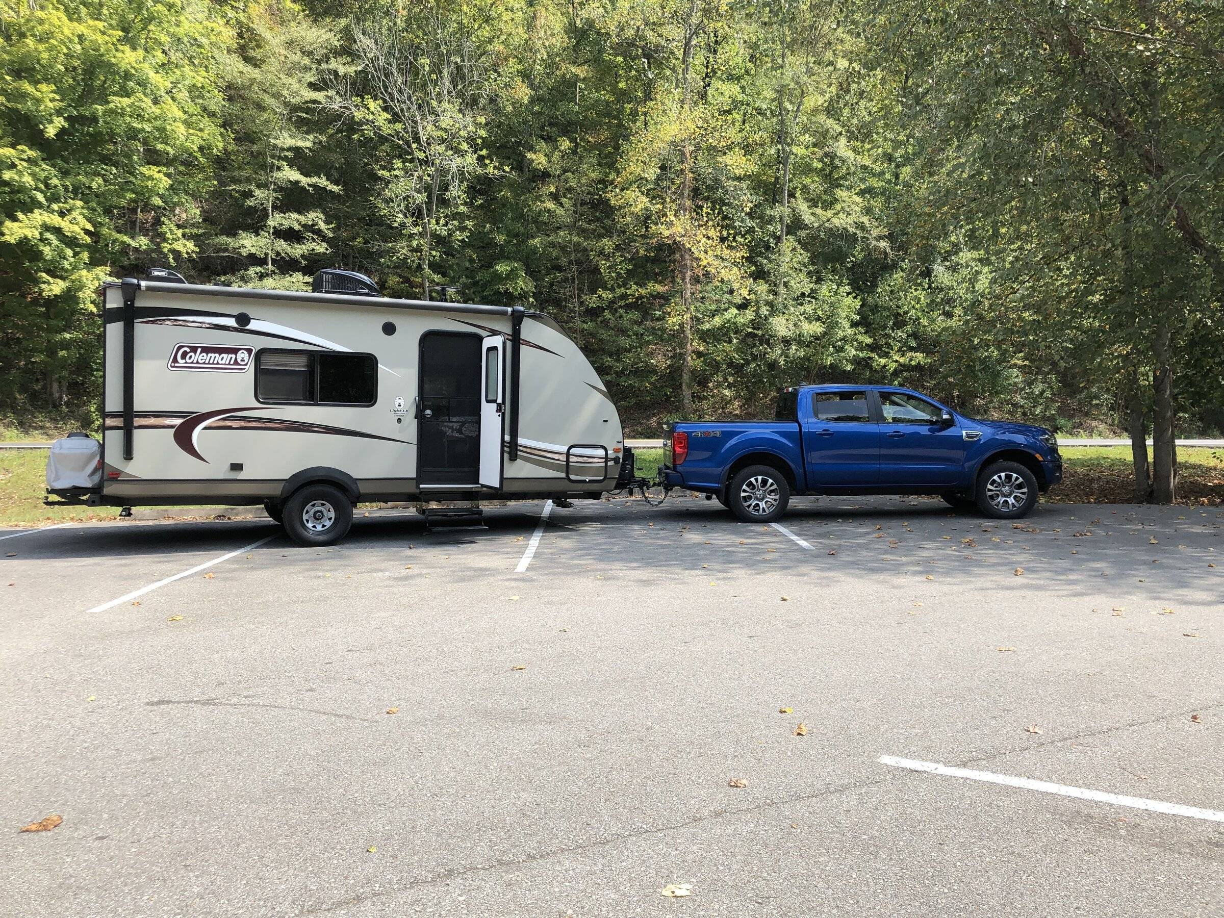

My experience is towing a 28’ #5,500 camper a lot with an ‘03 Excursion V10 gasser. Pulled with the Ranger once for 60 miles. The Ranger pulled in a straight line better than the EX, hearing maybe? But the Ranger was all over with passing traffic. Classic tail wagging the dog, not safe in my opinion. We had the WDH and anti-sway on. True apples to apples comparison. My 2 cents.
