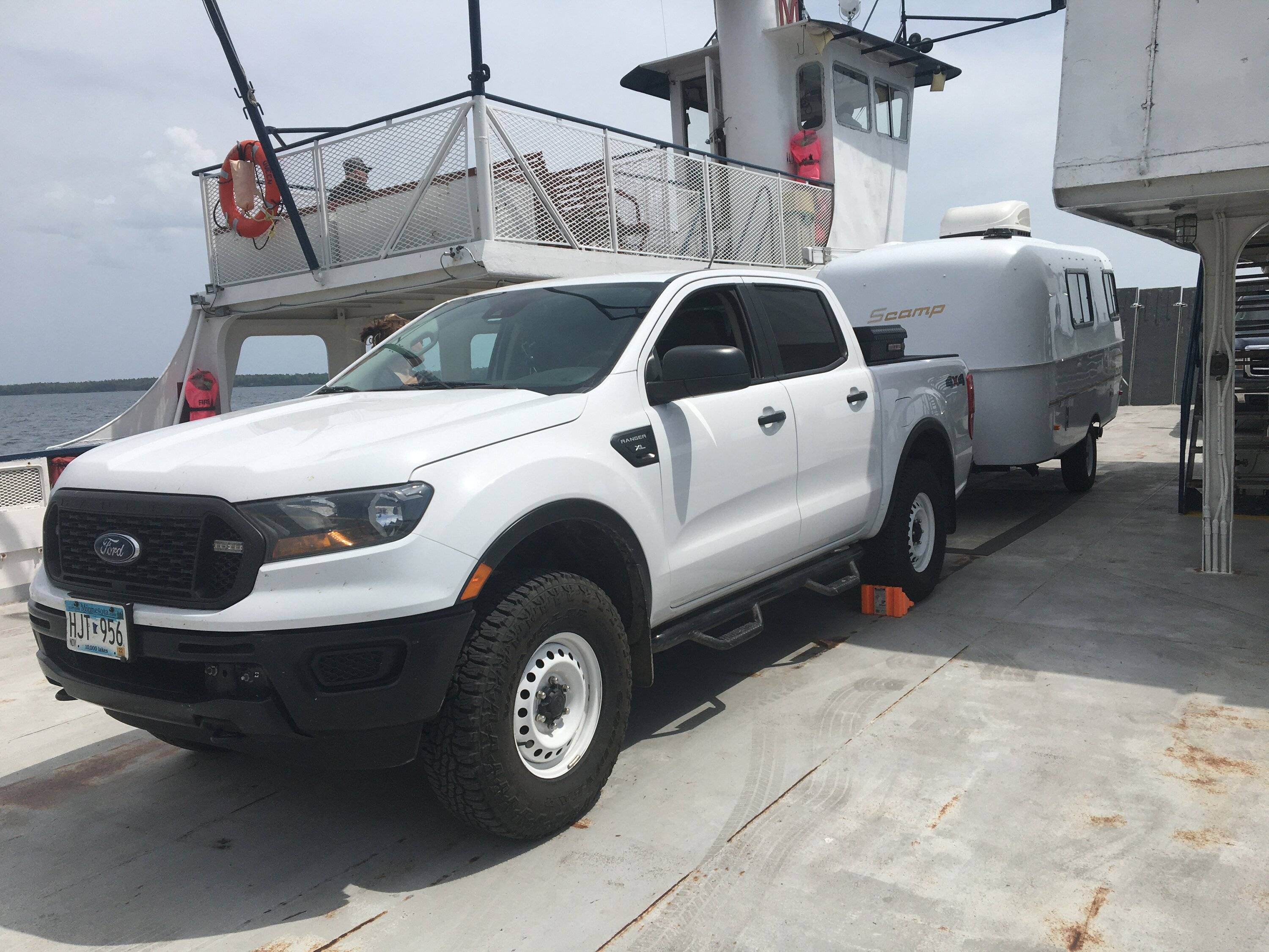

One more reason to keep it small. Paying by the foot on the Madeline island ferry.
18mpg heading up, 13 coming back, all 55mph.
