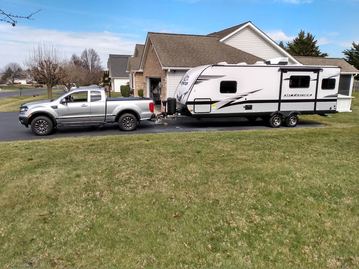

I don't know just how Ford in their infinite wisdom, figures frontal area standards for their trucks and how they determine what each can tow.
Do they consider the total frontal area, which in my case is probably around 80 sq feet (8 ft wide X 10 ft high) or just the area that sticks up from the top of the bed to the roof.
It becomes a moot point. Many on the site , self included, tow full size trailers without a problem. Yes, mileage will go down, but you should still get 10-12 mpg depending on size of your rig and driving habits.
Pictured is my rig, and I get around 11-12 at 65 mph, flat x-way driving. Throw mountains and stop n go and mpg goes down.

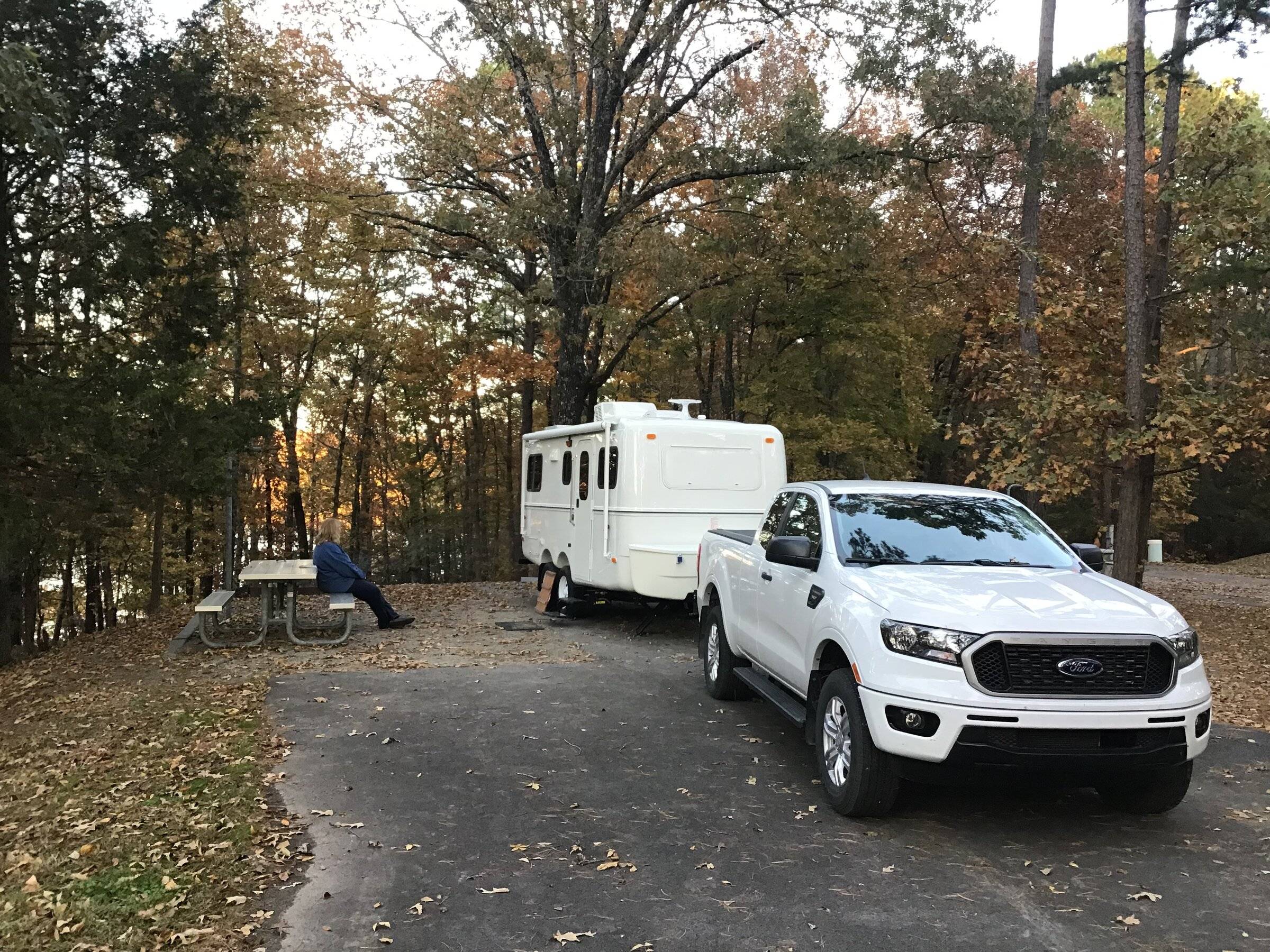

I don’t know how Ford calculates it, but it’s only 55sq ft for the Ranger rating. Width will increase resistance, and visibility decreases; plus, depending on the driver, possibly fatigue over equal time.
The Scamp is 6’8” wide. There are many 7’ wide trailers. I have trailers from 7’ to 8 1/2’ wide, and I prefer trailers 7’-7 1/2’ wide. I find livability to be good once a trailer gets 7’ wide, and drivability to start going down once you reach 7 1/2’. I find the 6’8” trailers not really livable for me. Even my pickup camper was 7’ wide.
My 7’ wide trailer from awning to water inlet is almost 7 1/2’. My last 7 1/2’ trailer was 8’ by the same measurement. My 8 1/2’ boat trailer is actually almost 9’.
I have an Escape 19’ fiberglass trailer. It’s 4620lbs loaded for long trips and 7’ wide and it tows great. It is heavy for an Escape 19. I get a low of 13mpg on windy steep uphill days. Typically I am around 15-15 1/2mpg hand calculated.
I have the ClearView towing mirrors. Expensive, but worth it to me. The truck has a little over 11,000 miles on it, 8000 of those towing.
I know everyone has different opinions, but I hope this helps. Maybe someone who knows will chime in with how the 55 sq ft is calculated. I too would like to know.

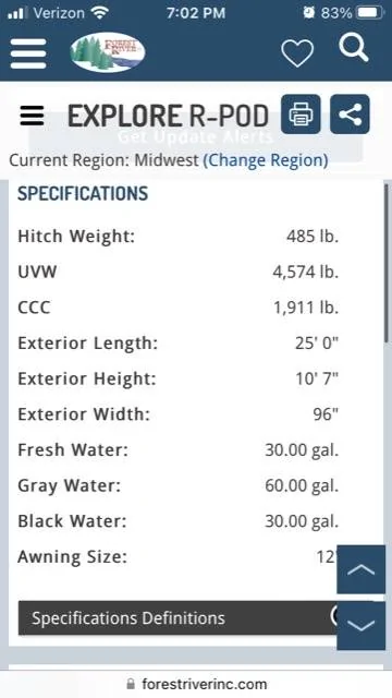

We love this floor plan. Best deal I can get is 33k, 36 after taxes and what not.
It’s a lot of money to spend if I have to buy a different truck to tow it in a month.
https://forestriverinc.com/rvs/travel-trailers/r-pod/RP-202/5489

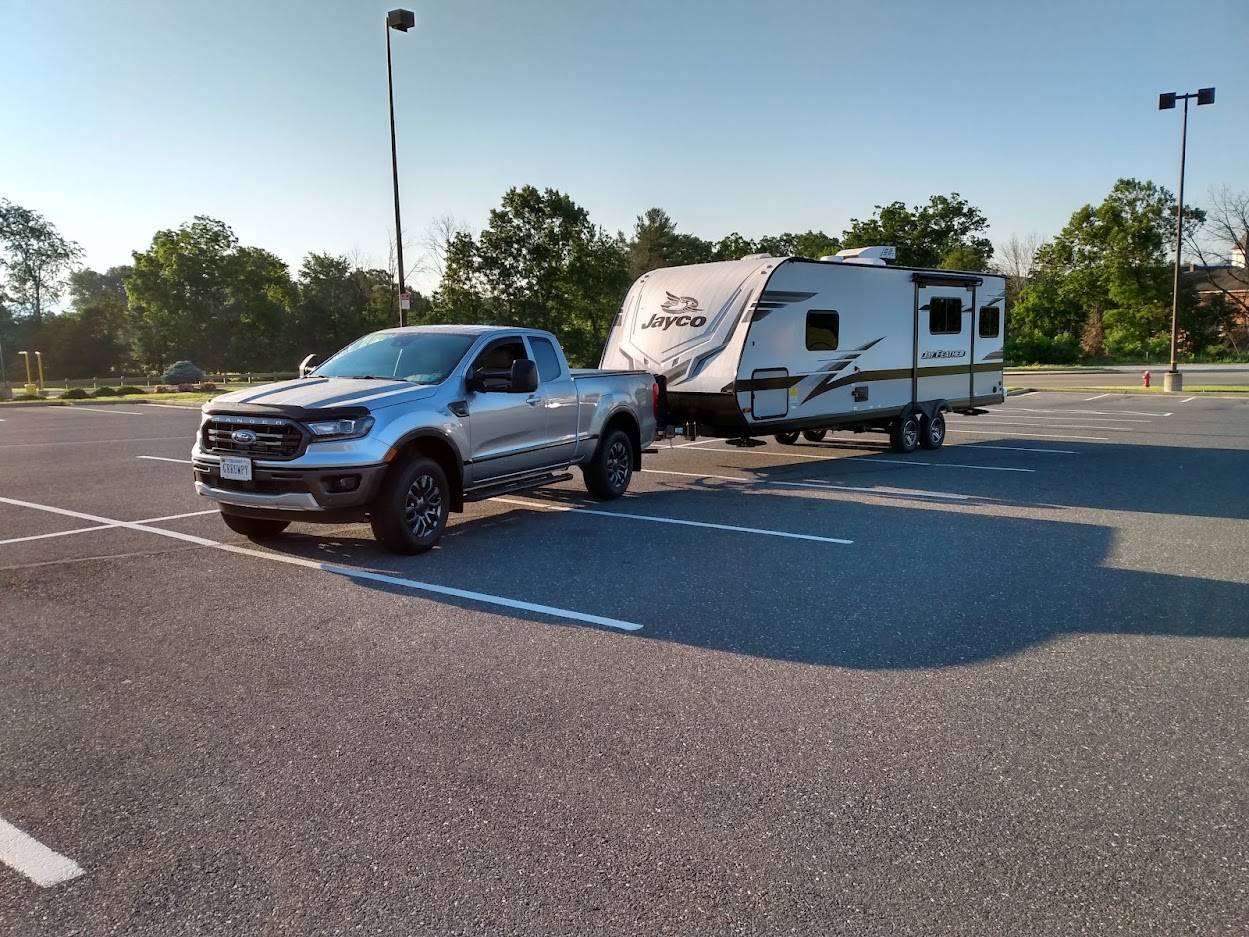

Fritz, this is our trailer, same 8 feet wide and 10 feet high as the one your looking at, but ours weighs in at around 6500 lbs loaded out with the tongue weight around 700 lbs. My Lariat tows it just fine. You won't have any problem towing that R-Pod.
