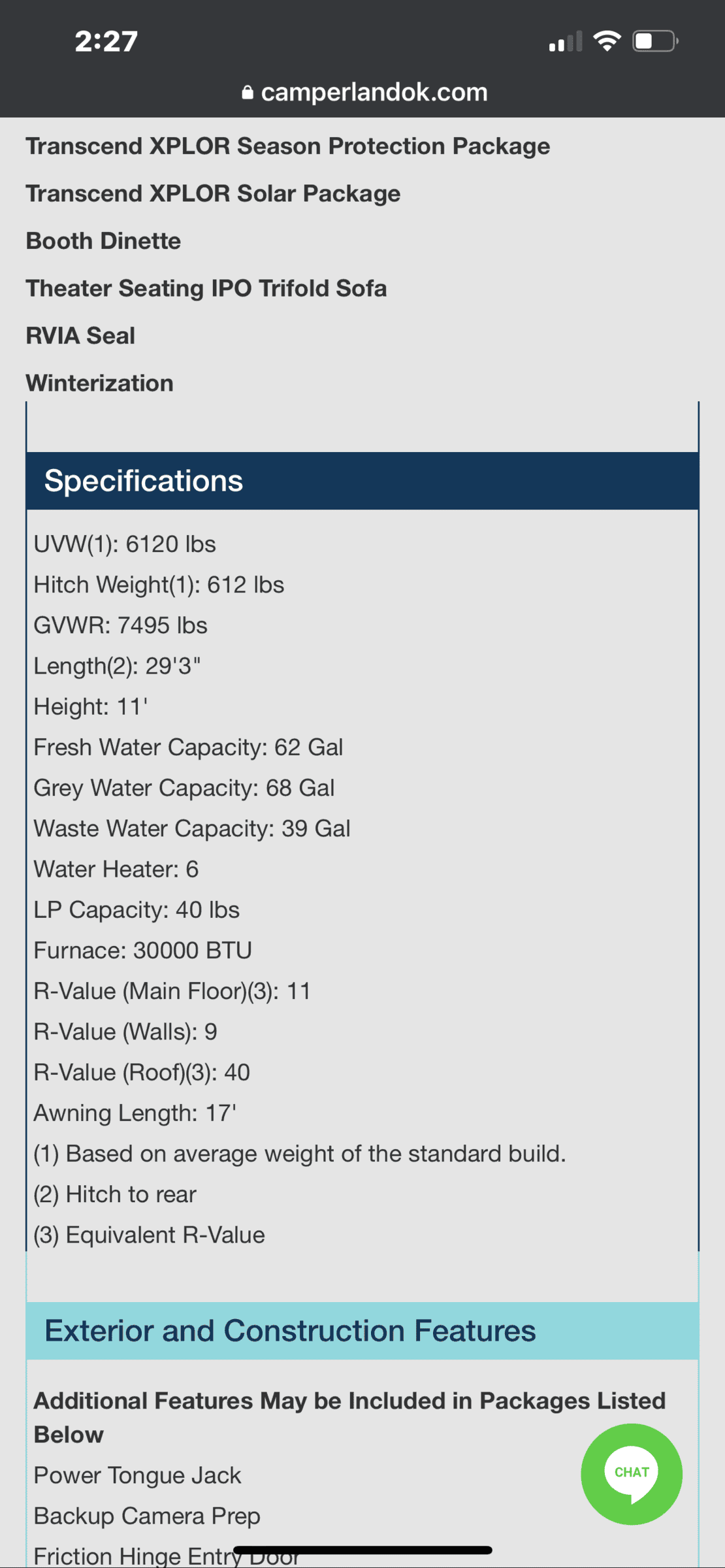

Trailer I desire:
UVW 6120lbs
Length 29’3”
Hitch weight: 612lbs
*I will attach spec picture of the trailer as well*

Sorry, but just too much trailer for a Ranger. You’ll need a full size, just to be safe

Having towed campers for about 20 years with SUV's and trucks, the longer the camper, the longer wheelbase of the tow vehicle comes into play and 29 foot is too much for a rangers short wheelbase.
The Micro Minnie 2108DS would be max I would try to get down the road safely.
I would not put anything behind my Ranger longer than 22 foot. Many people might do it, but not me and that would be with an equalizer brand hitch with built in sway control.
