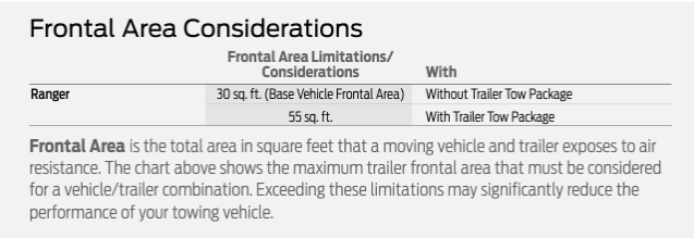

its the area exposed to wind resistance
So is that total front area of the trailer? That would be over 80sq ft. It can’t be.
55sq ft would be something like a teardrop.
6,021
30,055
Don't go nuts over this, trying to figure it out. Between the frontal area of the Ranger, and the exposed frontal area of the trailer it's over 55 sq feet.
The minute you hook up a full size frontal area travel trailer, 8 feet wide x 10 feet high, your going to be over that 55 sq feet.

Comparing something narrower like a R-pod at about 7 foot wide vs a 8 or 8.5 wide trailer.
I know Ford says to take frontal area of the trailer into consideration but I don't know how that is actually calculated.

It is best for calculating purposes to use the total frontal area of the towed trailer. The towing vehicle is either within the trailer's silhouette (travel trailer, enclosed car hauler etc.) or not (open power sports trailer, 16' boat & trailer).
The frontal area specs are assuming Gross Cargo Weight Rating (GCWR): the truck, full payload in the box and max trailer weight. I'd be OK pulling an empty trailer that is outside the frontal area spec with no payload in the my truck, but you do you.

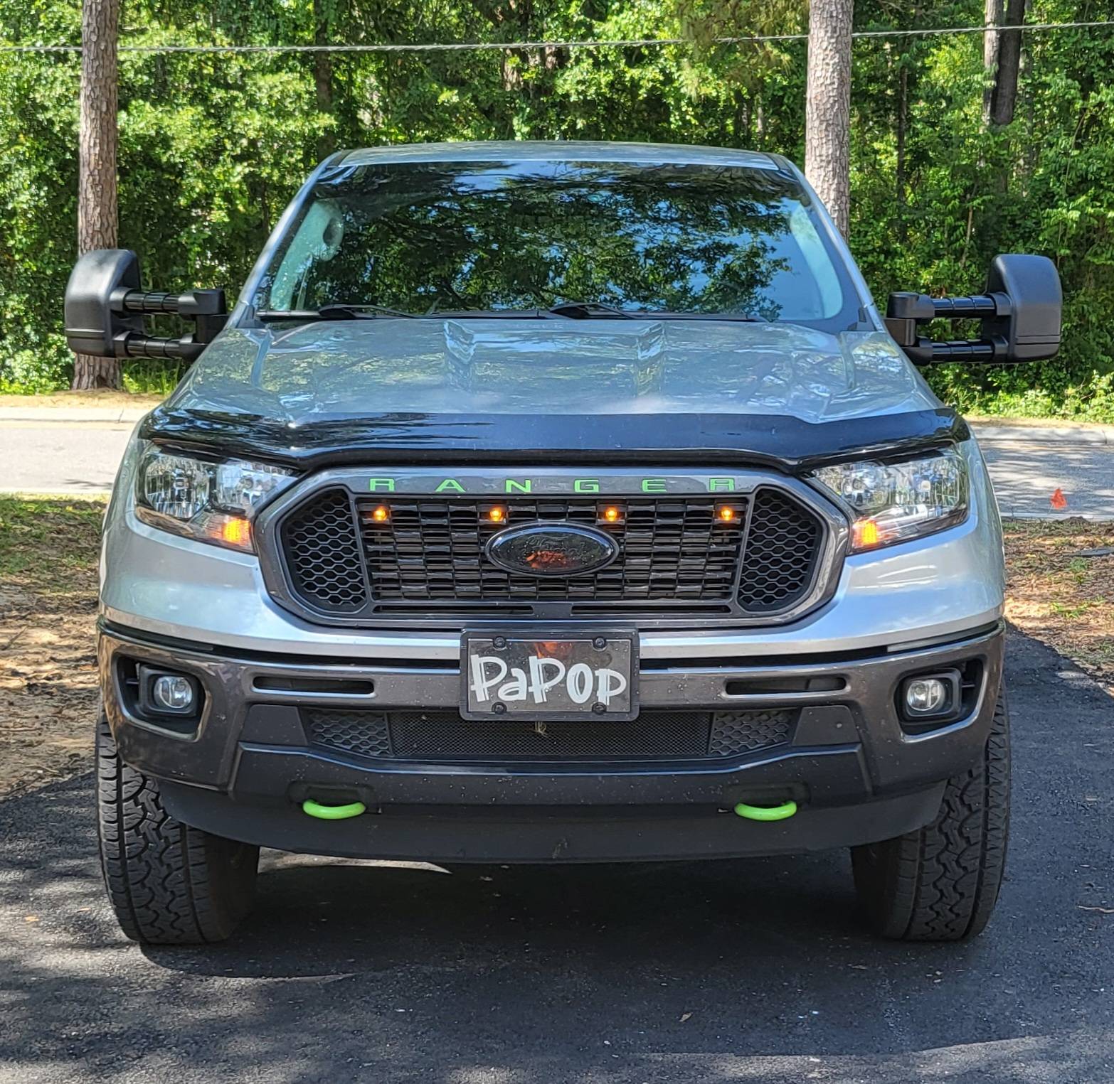

I personally feel the stock mirrors are barely adequate, and I have significantly better, faster sight lines with towing mirrors, and they also make backing much easier. Essentially, in traffic I like to make better, faster decisions, and make backing easier.

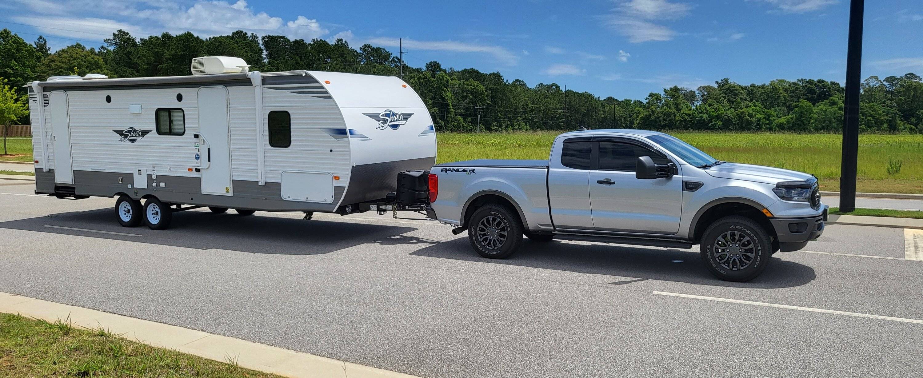

I tow a Shasta 26DB, it's 96" and I've not had any issues with towing... Besides the milage drop.
I did upgrade my mirrors... Which is always helpful!

3) Visibility is another big factor with the Ranger, as you won't be able to see "around" pretty much any travel trailer without adding towing mirrors. We were very happy with these: https://www.etrailer.com/Mirrors/Wh...IFCiYPNGC_U8kCno-xFZM75c1YP8hK4EaAq8kEALw_wcB , but no longer use them since installing a camera system covering the front and sides of the truck (we go off-road quite a bit) and the rear of the trailer (let me know if you want deets on the camera system, or if you are near to the Bay Area, I'll sell you my towing mirrors for a good price).
