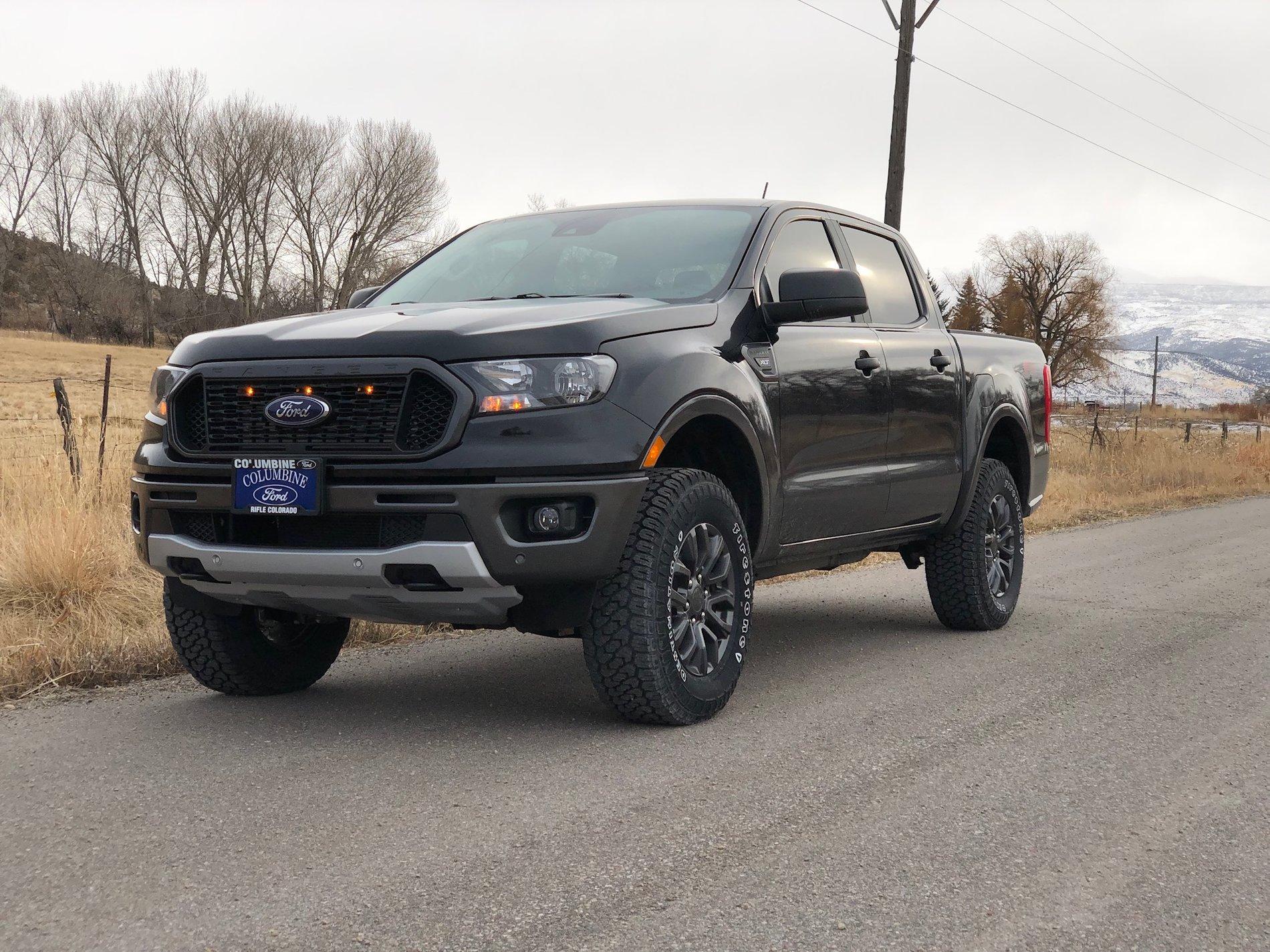

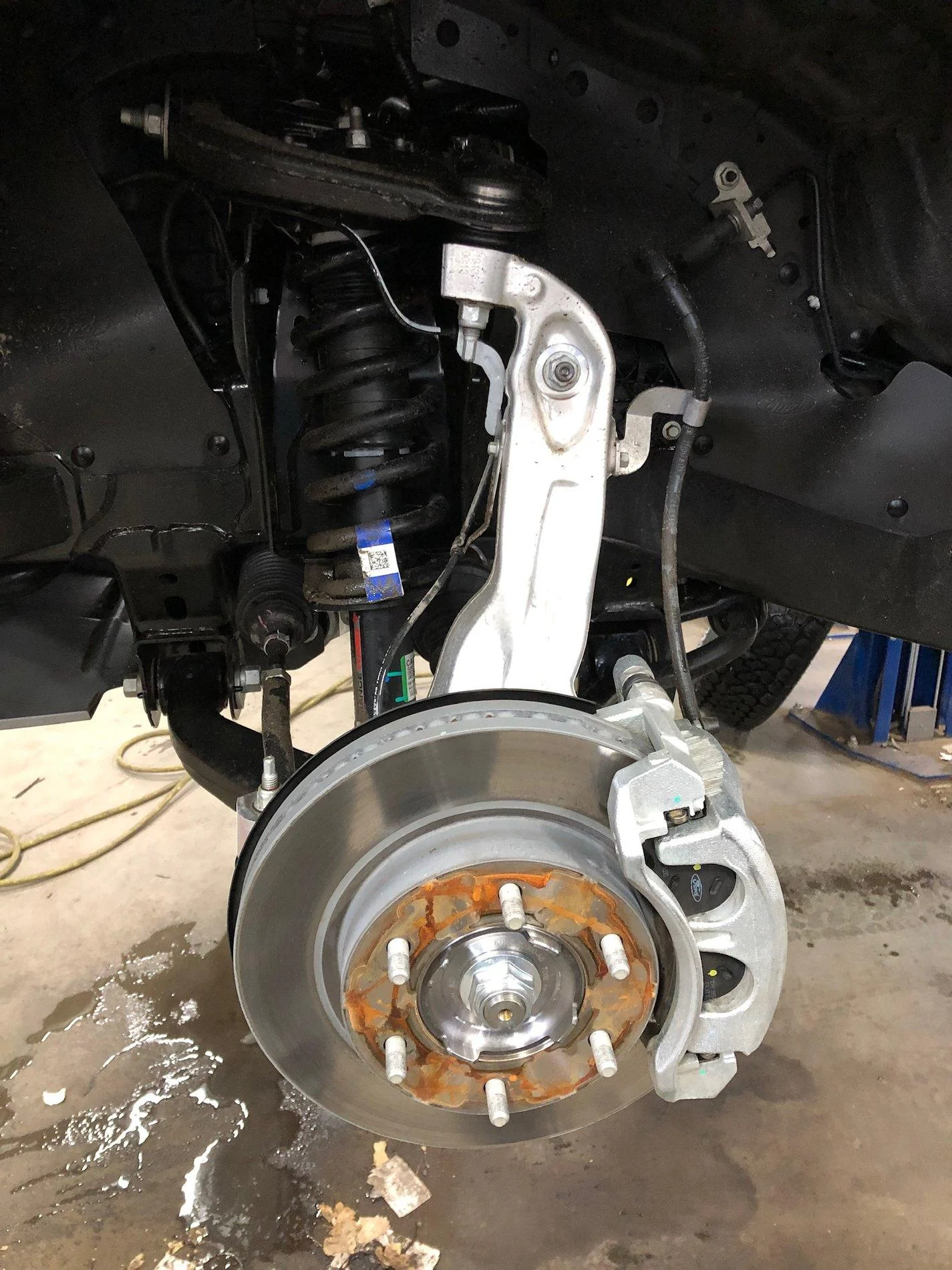

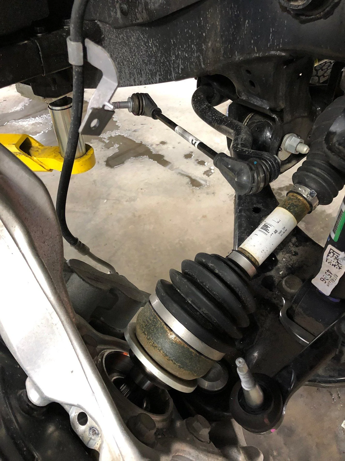

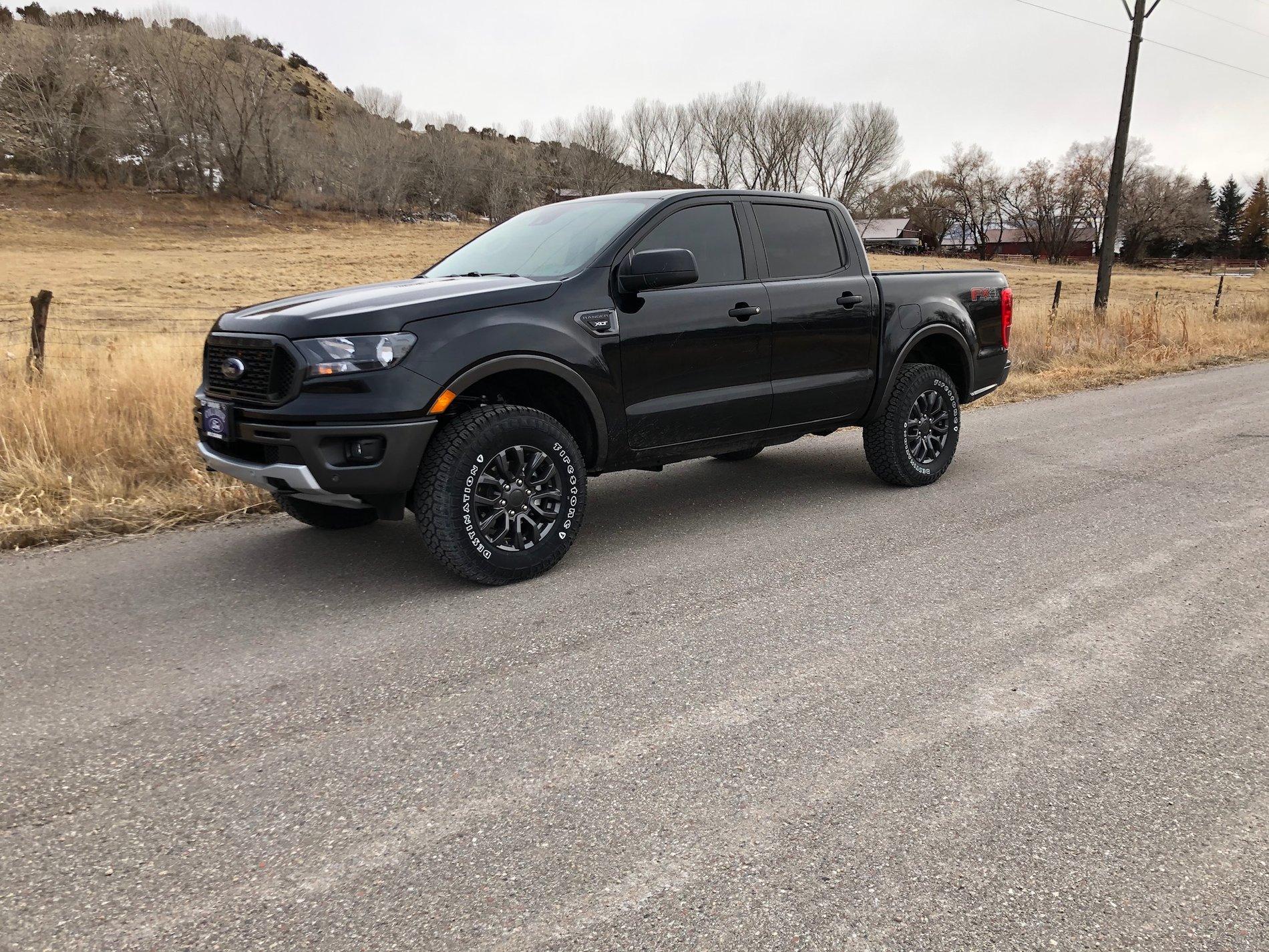

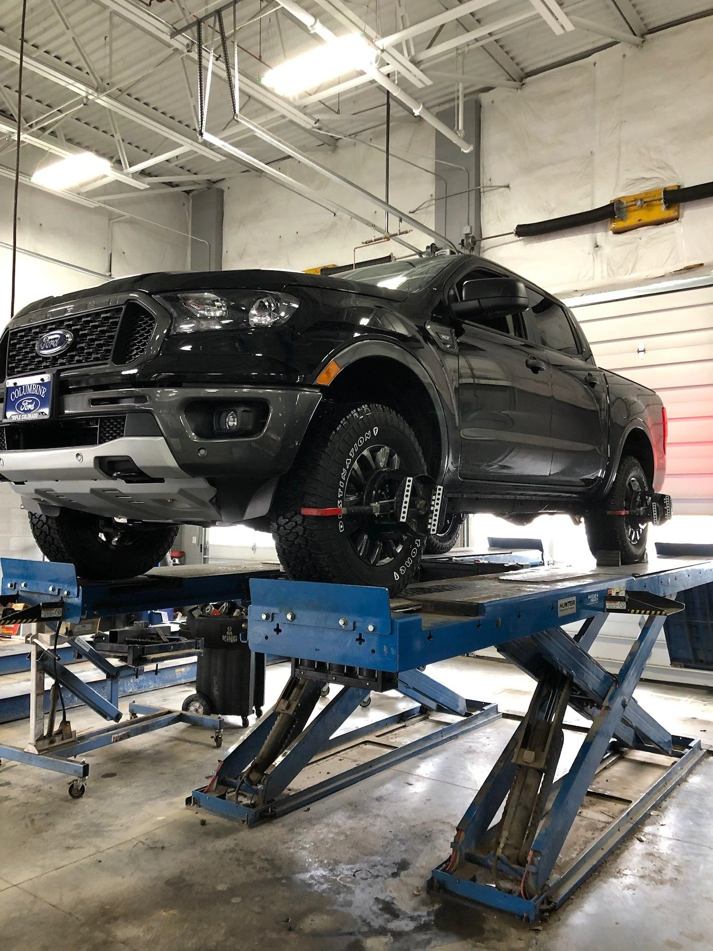

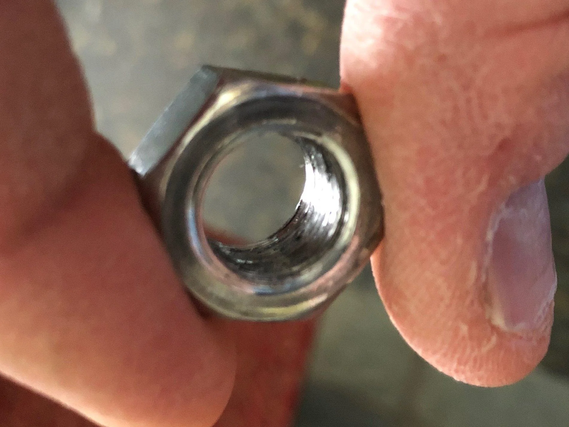

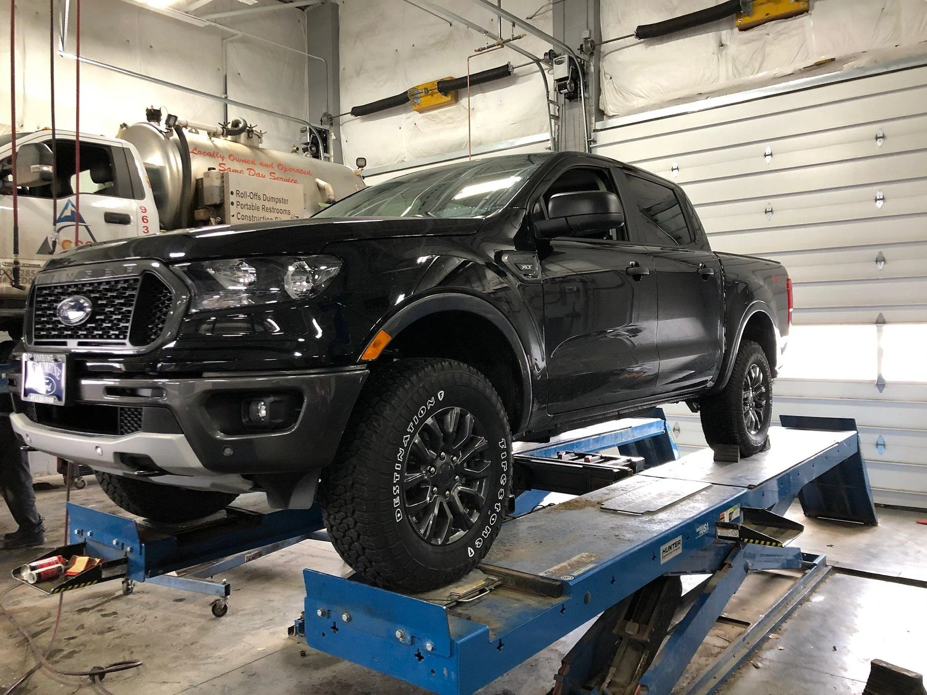

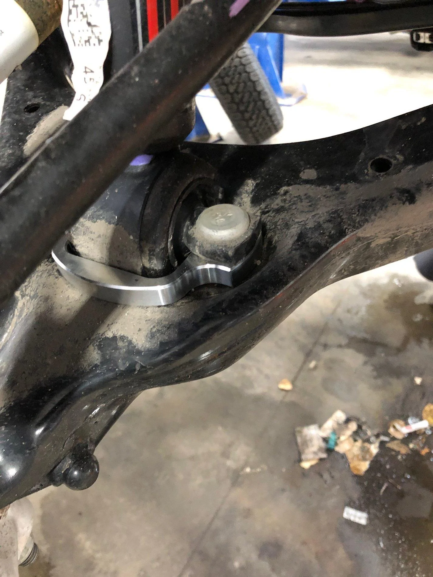

Seems like a trend today for Readylift 2” kits today. We installed this on my 2019 XLT. Spacers were great. Hardware sucked. Hardware was replaced with good bolts and nuts, after one of the nuts pulled the threads out when torquing them. Other than that, pretty simple. Lucky, a friend of mine is has a heated shop and lift. We just removed the axles from the spindles, for piece of mind, and it went smoothly. About 2.5 hours including the alignment. Here are some pics.
