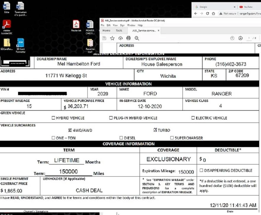

And how does one get this?!?! Sounds too good!
I got it through the Ford Dealer the same time I bought the truck.

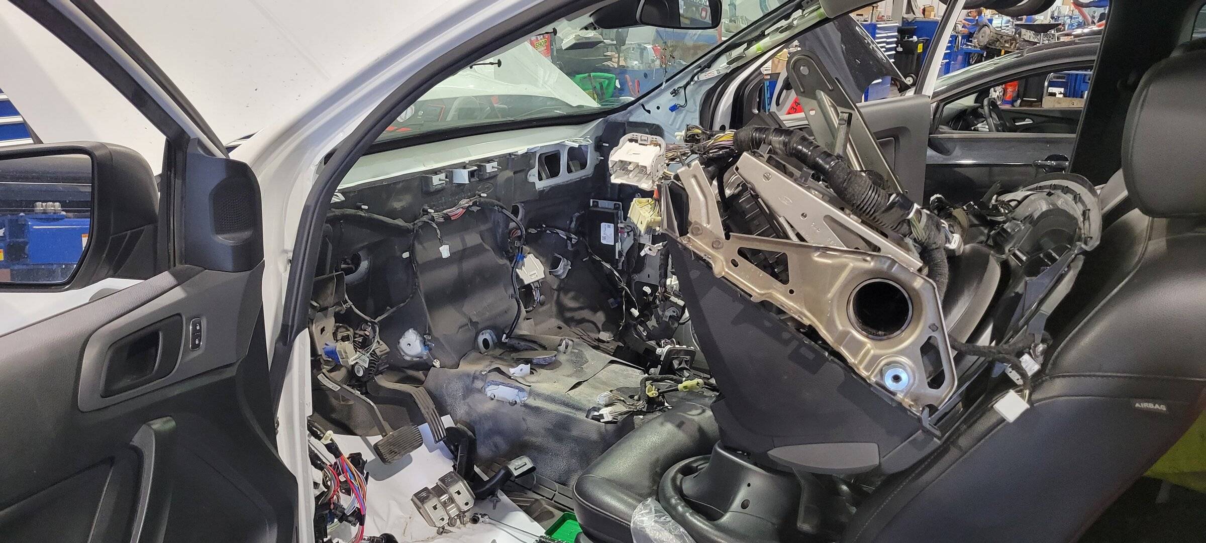

On May 25th, I had a 2019 Ranger come across my desk with HVAC issues. The blend door diagnosed bad, and it required a dash out repair. This day also happened to be the last day of my Factory warranty! After I quoted the repair job, I walked over to the finance department and purchased myself the Ford extended warranty.
Basically a bad blend door cost the owner $4000.00. OUCH!!!!

I worked for just over a month as a service writer in the area my wife and I relocated to in Florida (from the ATL area) and I got to see some neat stuff. But, the wife and I discussed it and the job wasn't for me, as much as I enjoyed working around cars and trucks. And, the coworkers were pretty good to work with and treated me very well.

What are the pros and cons to not repairing it?
Non-working HVAC, or basically it's stuck on heat (or AC?). I know the truck I supplied the photos of, the HVAC was stuck on HOT. No good in South Florida because it's damn hot down here. And according to OSHA, the HVAC has to be fully functional in a work truck. Thus the client approved the repairs.
The workaround fix is a bit bodged and band-aide style, in my opinion, but I like it for the money saved! I am OCD about having all of my systems functioning properly in a vehicle and am not a fan of band-aide fixes. But to get you heat or cooling, hell - I'd do it!
