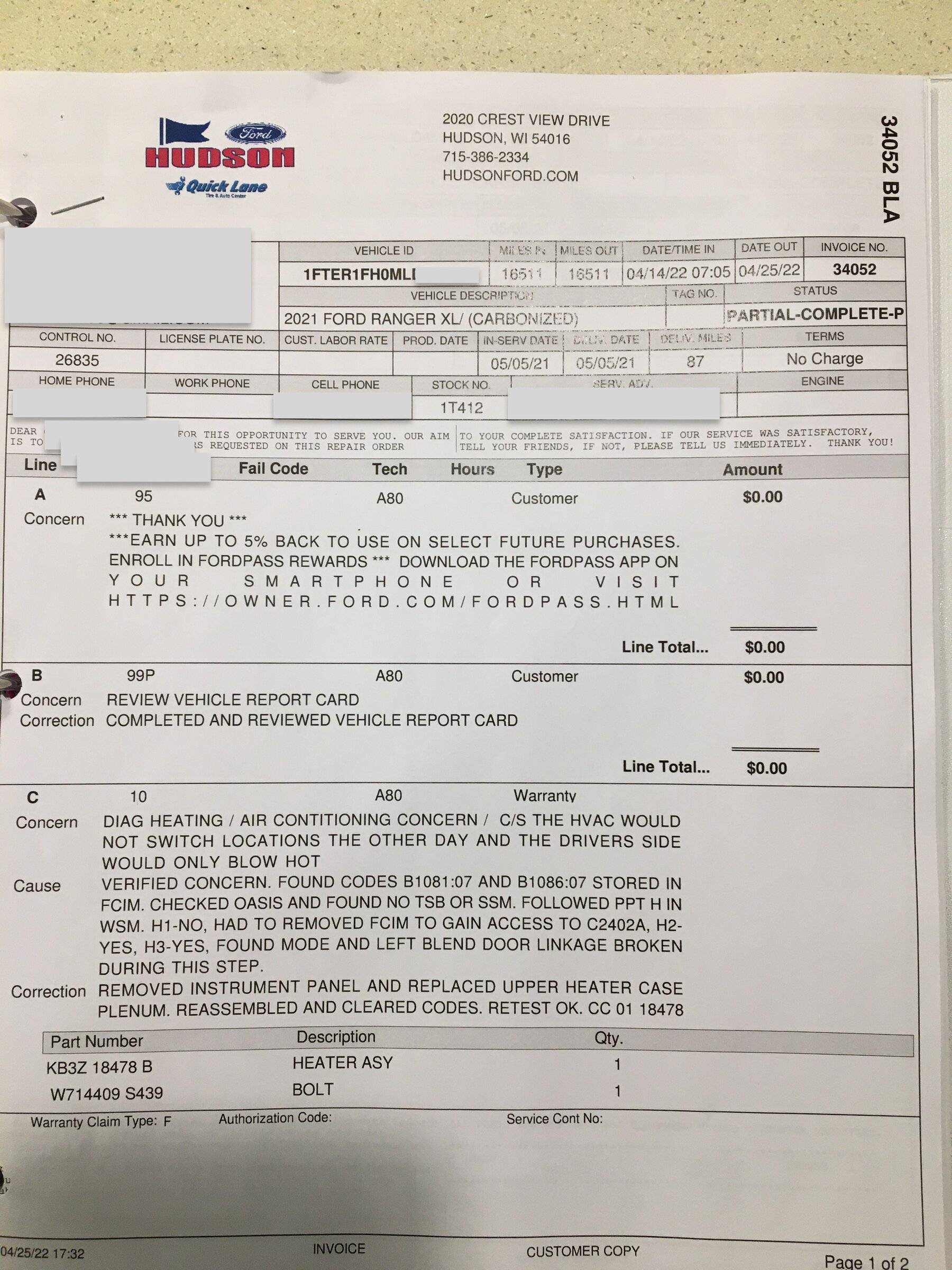

I worked for just over a month as a service writer in the area my wife and I relocated to in Florida (from the ATL area) and I got to see some neat stuff. But, the wife and I discussed it and the job wasn't for me, as much as I enjoyed working around cars and trucks. And, the coworkers were pretty good to work with and treated me very well.
On May 25th, I had a 2019 Ranger come across my desk with HVAC issues. The blend door diagnosed bad, and it required a dash out repair. This day also happened to be the last day of my Factory warranty! After I quoted the repair job, I walked over to the finance department and purchased myself the Ford extended warranty.
Basically a bad blend door cost the owner $4000.00. OUCH!!!!

WOW, that looks rough. I have a question since you are the expert for the moment. I have been wondering about a “blend door” issue on my 2019 Crew Cab. Passenger air is cold, driver side is coolish. Dual AC and passenger side set to 72 is much colder than driver side set to 67. Would this be a blend door problem or something else? Thanks

It is just ridiculous to design a vehicle where a Blend door cost $4000 to repair.
Makes me happy that I bought a life time warranty on my Ranger
Might be one too many zeros in there. I had the same problem and got mine fixed under warranty. They had to remove the dashboard and replace the whole upper heater case plenum. In and out the same day.
Mine did just the opposite, heat coming out of the driver's side vents that was so hot , I couldn't hold my hand in front of them regardless of the temp setting, auto or manual, only had fan speed #2. The passenger side worked normally. They found codes B1081:07 & B1086:07 stored in the FCIM. Mode and left door linkage were broken.
