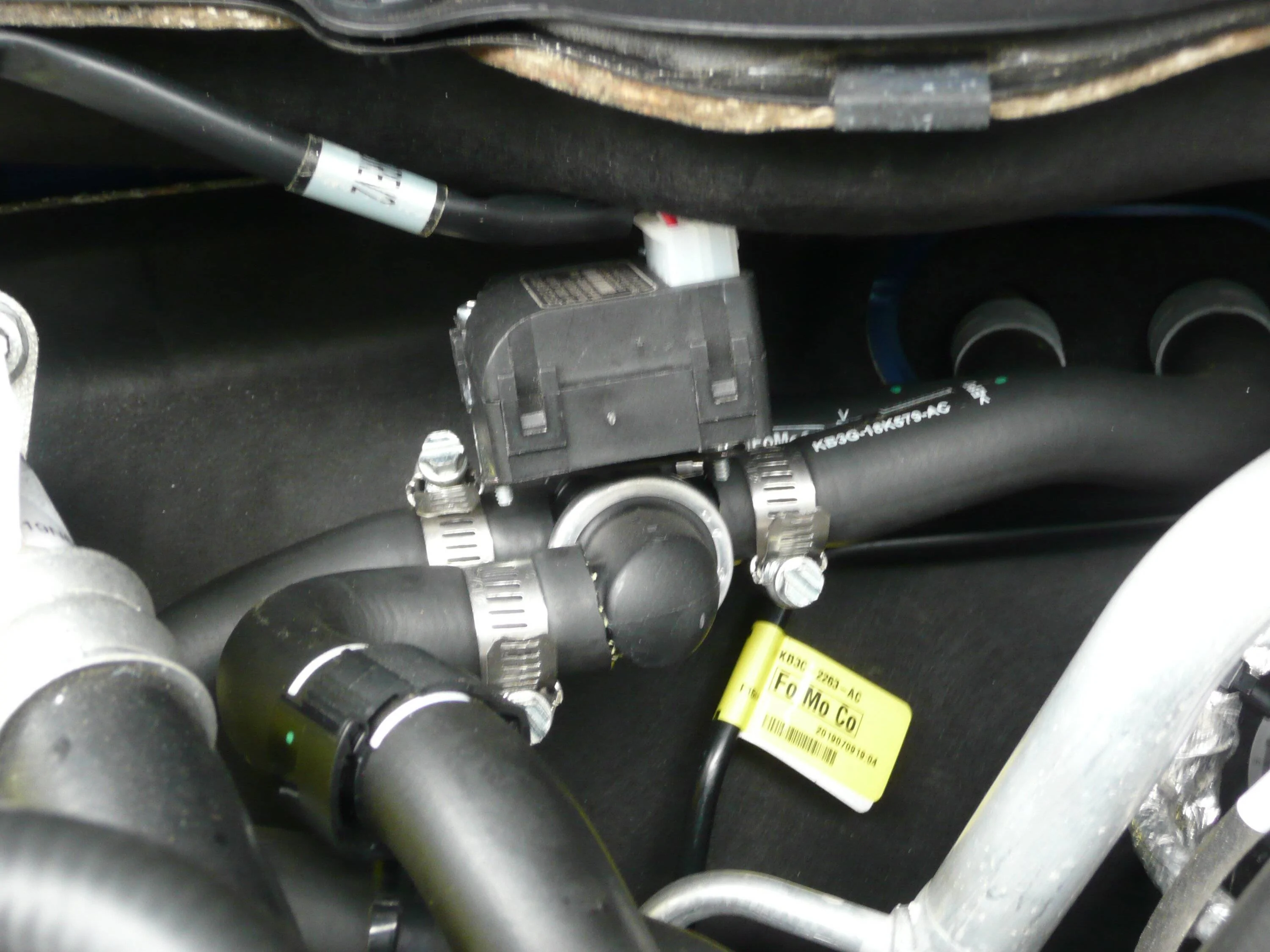

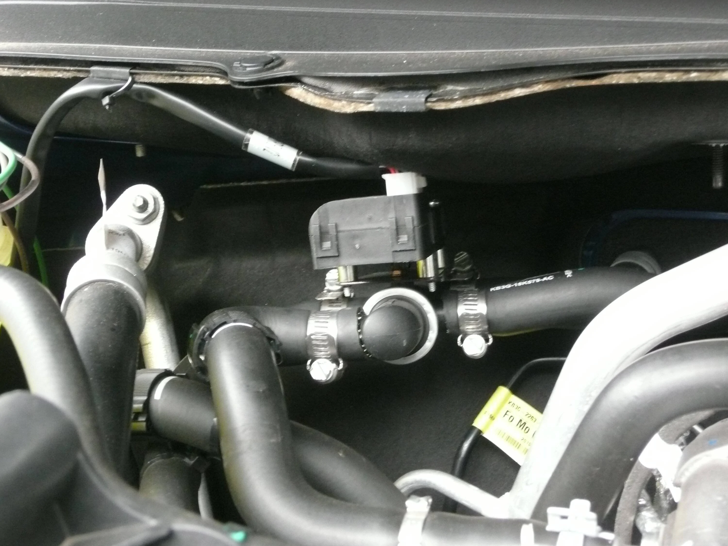

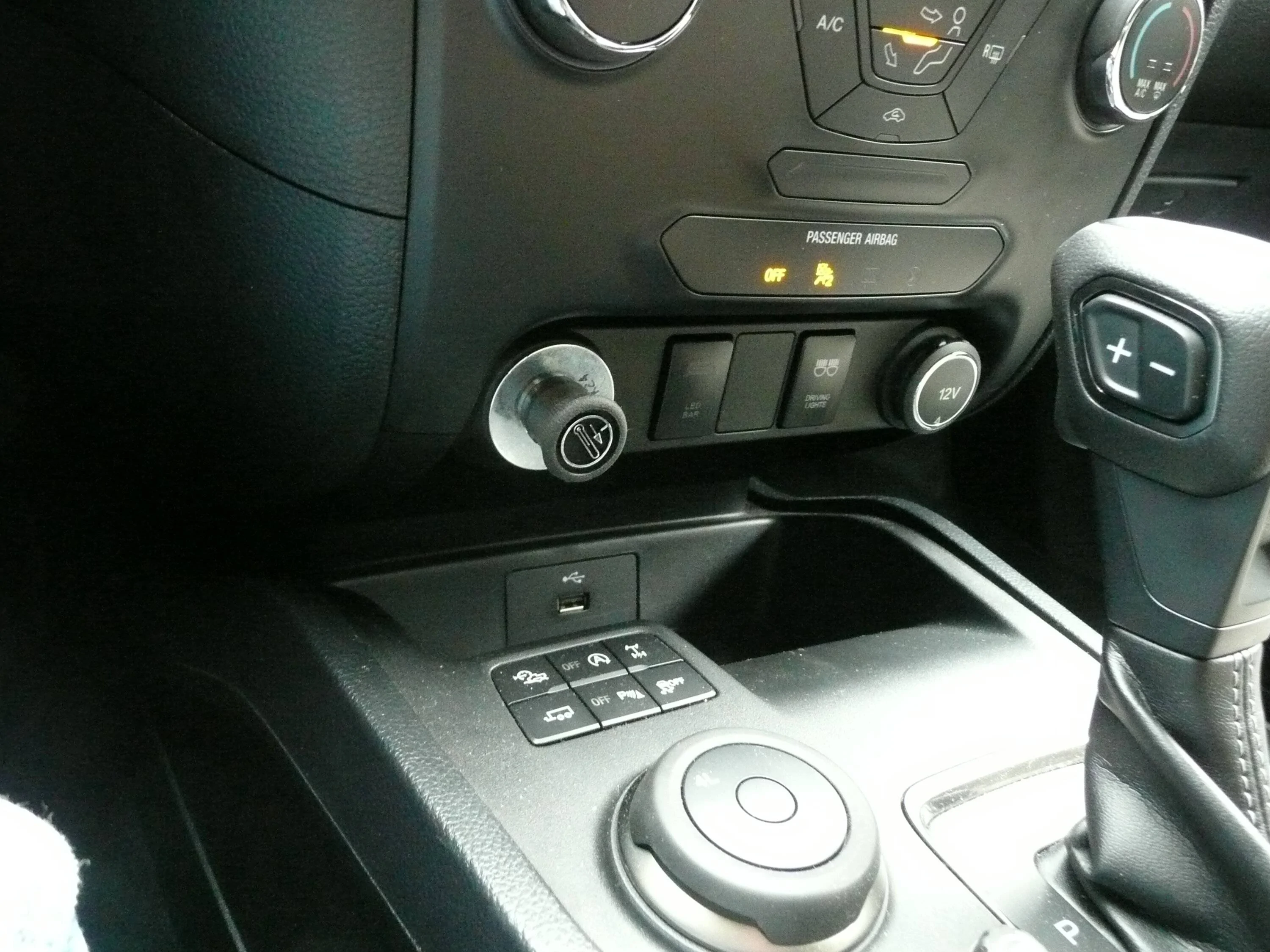

Here is some pics. The valve fits like it was meant to be there. The dial I installed with a fender washer and put it in where the 12v socket was on my Lightforce aux switch bezel. The hardest part was fishing the wires thru and you barely lose any coolant, as this is the high point in the system.

My bypass valve showed up today. Any hints on how you routed the wiring?
