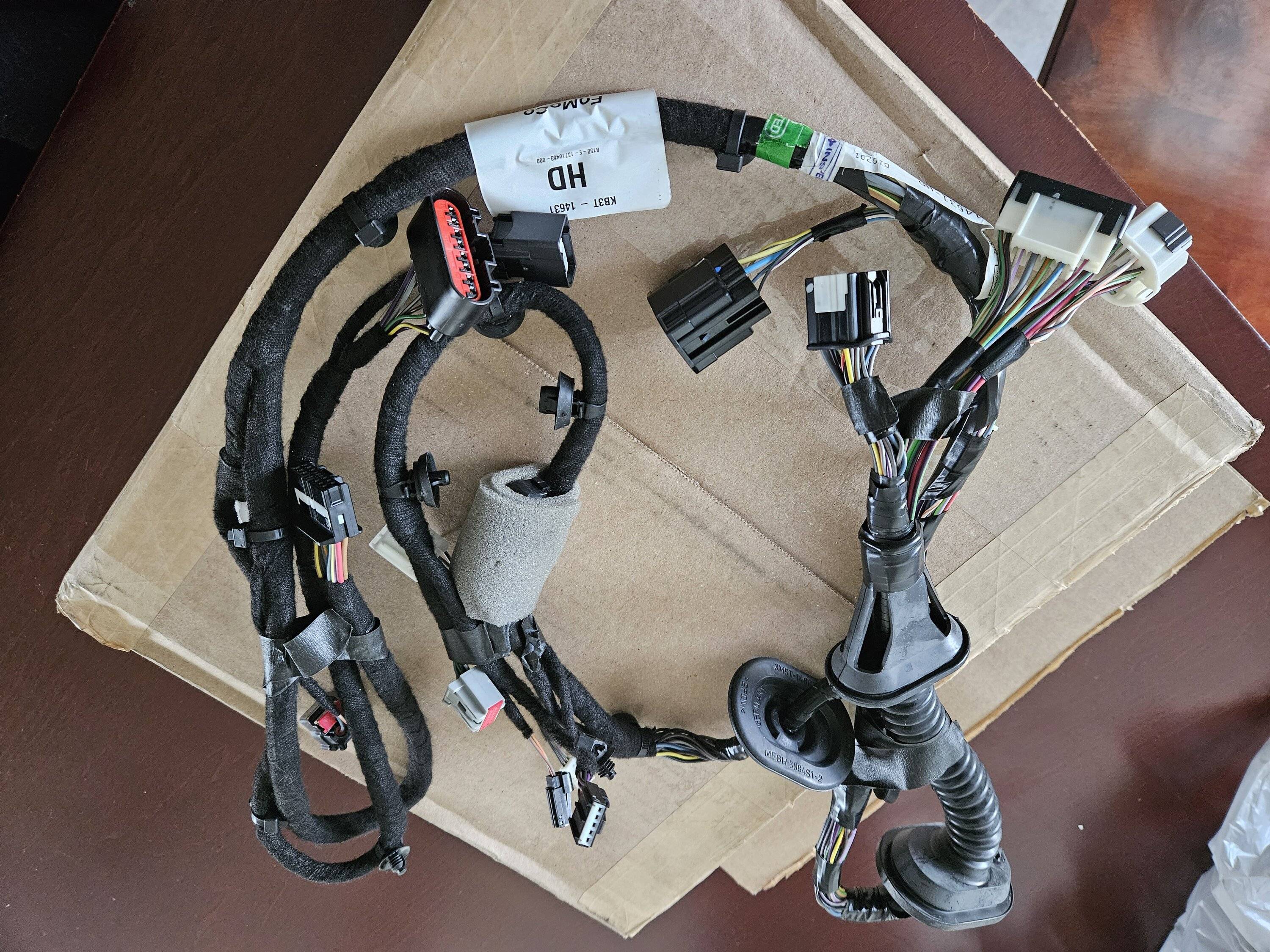

@Scubamado had a slightly different approach than mine here: XLT swap out to Lariat Mirror and door Harness
Rather than create the door harness he bought stock Lariat door harnesses ($90 for LH and $80 for RH).
Part numbers to the lariat harnesses:
KB3Z14630-F (passenger side)​
KB3Z14631-G (drivers side)​
The harness includes the accordion seal. The advantage of this is you don't need to add pins to the connector nor fish wires thru the door accordion seal, so a cleaner in the door install. Only disadvantage is the cost, but your time to create your own harness aint free! at least mines not.
The Tap Harness I made would now tap into the door harness where it comes into the body. Lengths and everything would be the same. Ryan had a good point about the grounds, I added one. Not sure if the Lariat door harness mates up to existing or non-existent grounds indide the cab.

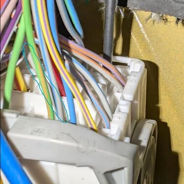

I've started the research into my truck Oct 21 build `21 XLT-mid (301A). I do have the fuse in 37 of the BJB. Looks like pin 8 of C213 is empty on both sides with the stock harnesses, I'm guessing the Lariat door harness will fill in the door side harness (14631) of that. Looking at C237 it looks like the cab side harness (14401) is empty at pin 21, I'm not sure without a closer look, but it looks like in the photo there may be a GY wire in 21 on the engine bay to cab side harness (14290). I've ordered a pin set from amazon I I'm hoping that once I have that door harness, I just need to add the wire between C237-21 and C213-8 (left side) + C238-9 (right side) to get the heated mirrors working.
I think that may be the mirror heat wire I circled in blue on the 14290 harness, kind of behind the GY-BU AND GN-YE wires.
