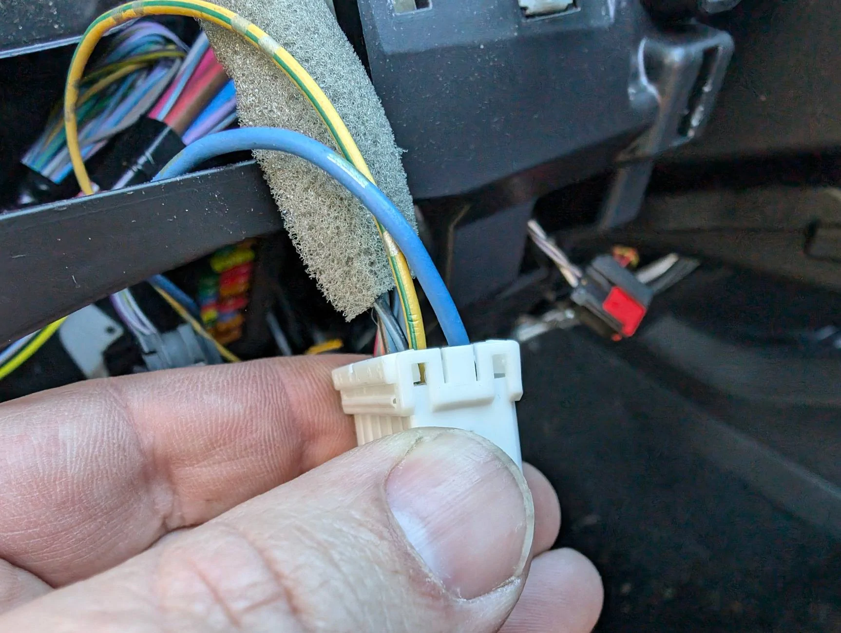

And why, Ford why. I had my hopes up on the power mirrors would just working once the mirrors and mirror control switch were replace when I saw the wires on the XLT door harness for the feature. Then I pulled the mirror control from the dash.
Those two cavities on the right, that is where should be Blue and Yellow/Green wires.
But I had the pins for those.
Next, the pins in C210 are smaller and I don't have those. I need the power mirrors working so for now, I may just extract the pins from the door side harness connector and shove the wires into it, as I said, I don't like tapping wires, can never 100% revert the work without replacing the wire or harness once that is done. Until I get pins for the connectors though, the only feature I'm working on getting on there right now is the power fold. I plan to wire in the wires at the mirror and have some lead taped up in the cabin near the connectors so I don't need to go into the doors again though.

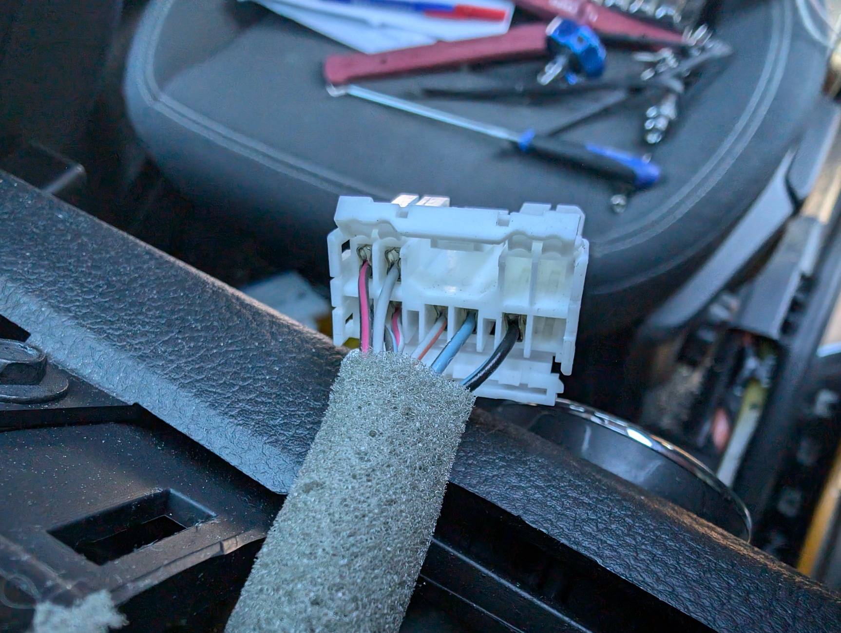

The current wiring plan. Note that the wiring in the LH door is done. I have the wires for the right door, and you'll notice the colors differ from the manual since I'm pulling pre-pinned wires from the Lariat LH door harness I bought to pull from. The wiring on the dash harness may not remain the colors shown, but could, just depends on what I can pull out of my box of wires.
I think I've found some of the needed pins/receptacles for C210/C238, still need to find C237 and C275 pin/receptacles where needed.

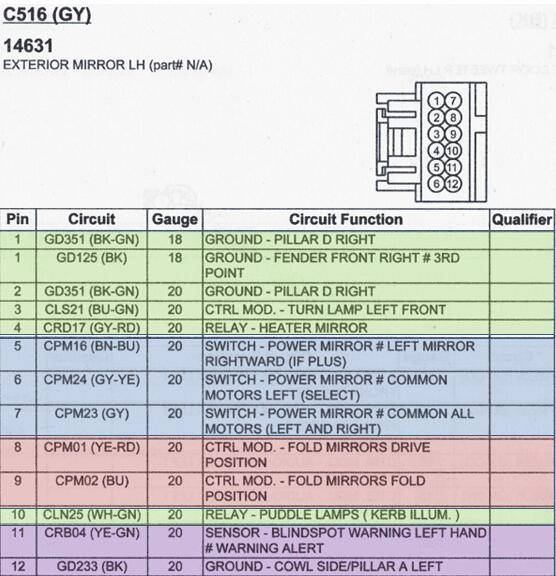

With the 23 - Dropping options off the normal - Lariat Trim Package
The only way to tell, is to get access to the Mirror Connector and see if you have all 12 wires in the connector (Harness Side)
Pin #4 = Heater Power
Pin # 1 = Heater Ground
This will determine what you need to do, to add heated mirrors as far as wiring needed.
You may get lucky, and the wiring is already ran to this connector and then all you need is the mirror harness and a heated glass to run to connector (C516)
and then the same for the Passenger Mirror
or Replace the Mirror Assembly that has the heated mirrors installed.
If you have the wiring in Pins 4 & 1 for Power & Ground on the Harness Side, you will want to check if the Mirror side of the connector is also wired, most likely they are empty cavities, if they are filled then all you need is the Heated Glass - it will come with the wiring to connect to the mirror base (assembly)

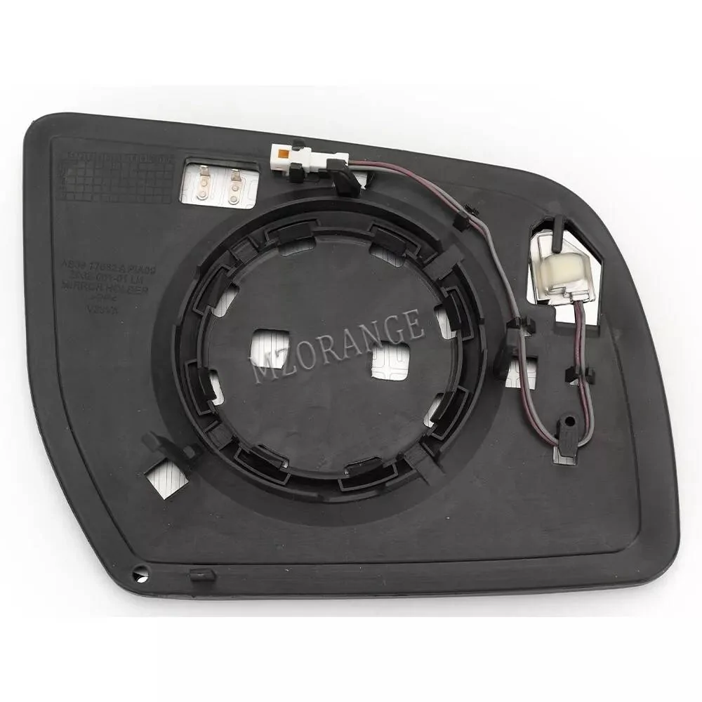

Correction - I did a Ebay search and the Heated Glass is just the glass, so it will need the mirror harness or add wiring and a connector's on both ends to connect to the mirror and pin into the C516 connector.
The physical connector on this = Blind Spot (Indicator)
The (2) prongs are for the Mirror Heat, so I assume that this just runs direct to the C516 connector
