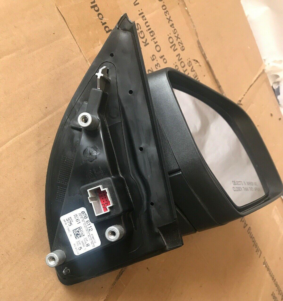

This a picture of the connector in a RH mirror with blind spot. not sure if its motorized as well.
Shows lots of unused pins which should mean there is a common connector coming from the body harness.
So if the that harness has more wires than the 5 pins in this mirror there is a good chance XLTs could upgrade to Lariat mirrors.
