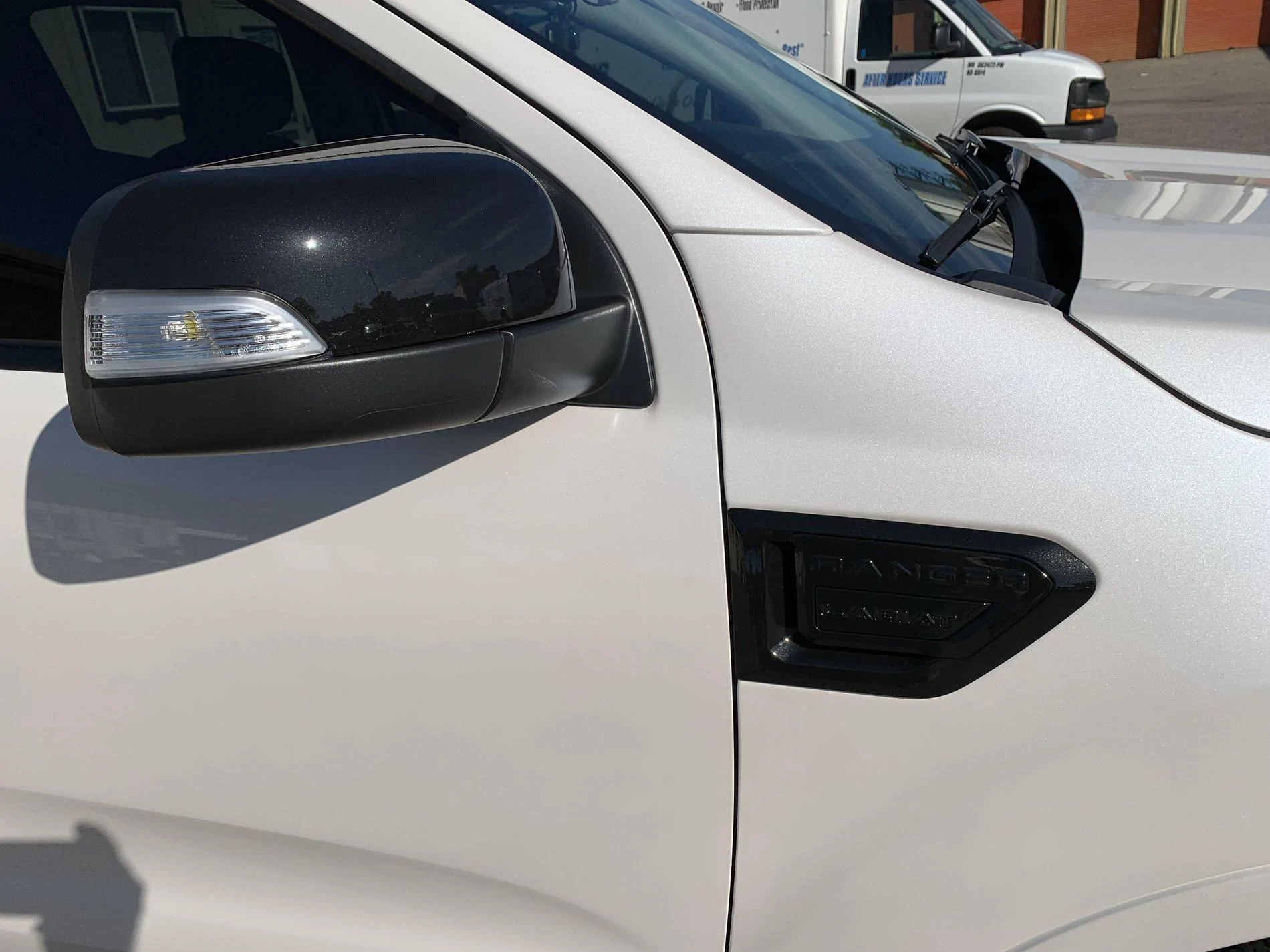

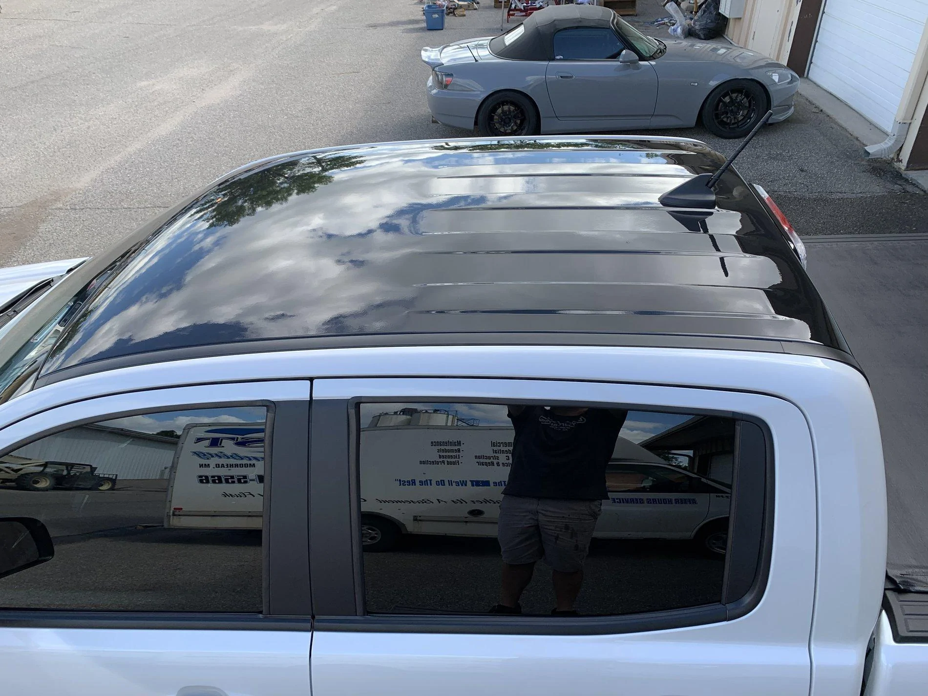

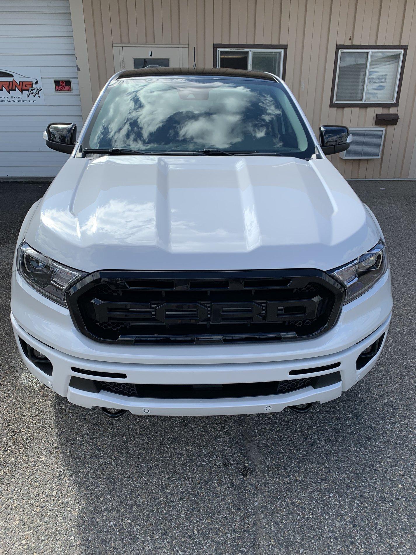

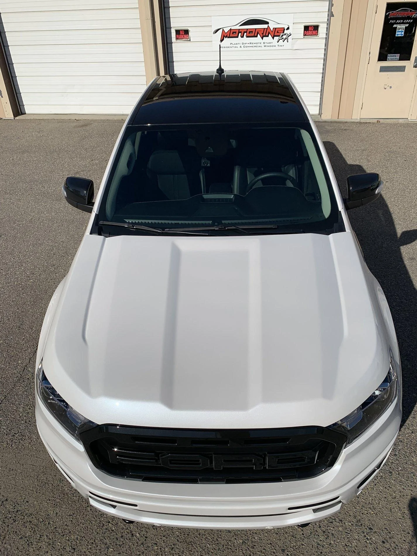

Yes the project was complete back on August 26th, but I have been super busy and haven't had time to share, or even get back on the forum. My roof, mirror caps, fender emblems/vents, and Raptor grille are now all a nice gloss black. I used Autoflex Express removable paint to do this.
VERY nice!! I just asked my vinyl place to get a quote for me to do the roof in gloss black last Thursday. Now I really want to go ahead with it!!
Glad to help! I personally love the way a white truck looks with a black roof and other black accents.

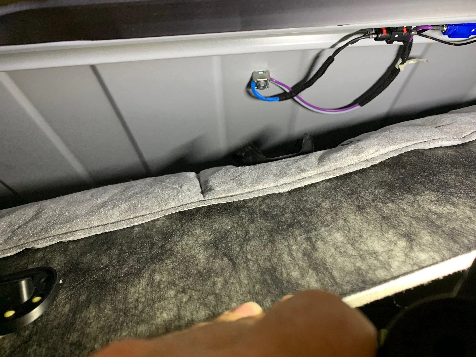

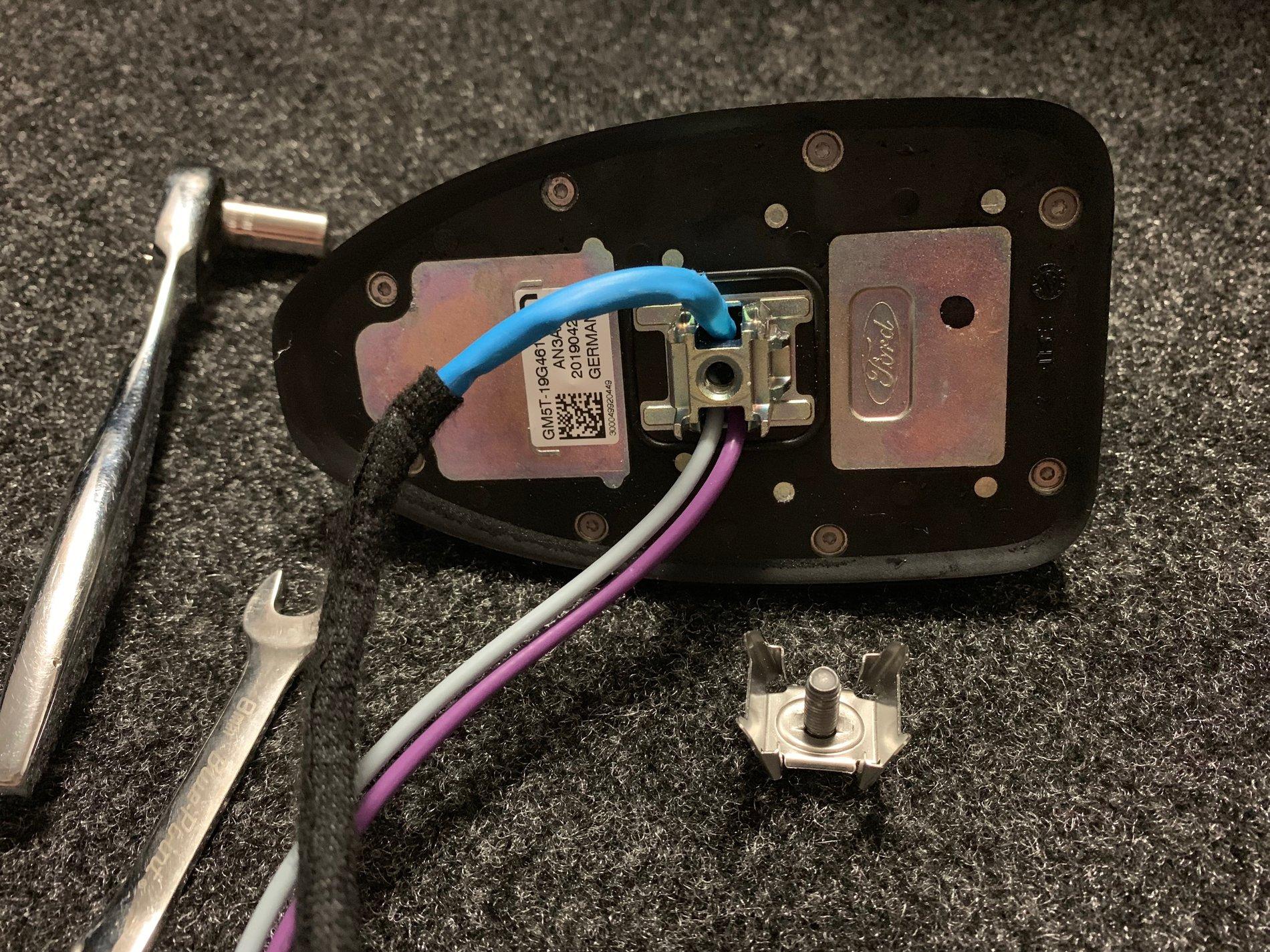

Confirmed that the Ranger antenna base comes off like other Ford shark fin antennas. It isn't difficult, but it takes some time.
Remove rear grab handles.
Loosen the top part of of C-pillar trim lower half (or completely remove the trim piece).
Remove upper rear seat belt bolts (T47 torx).
Loosen and remove upper C-pillar trim.

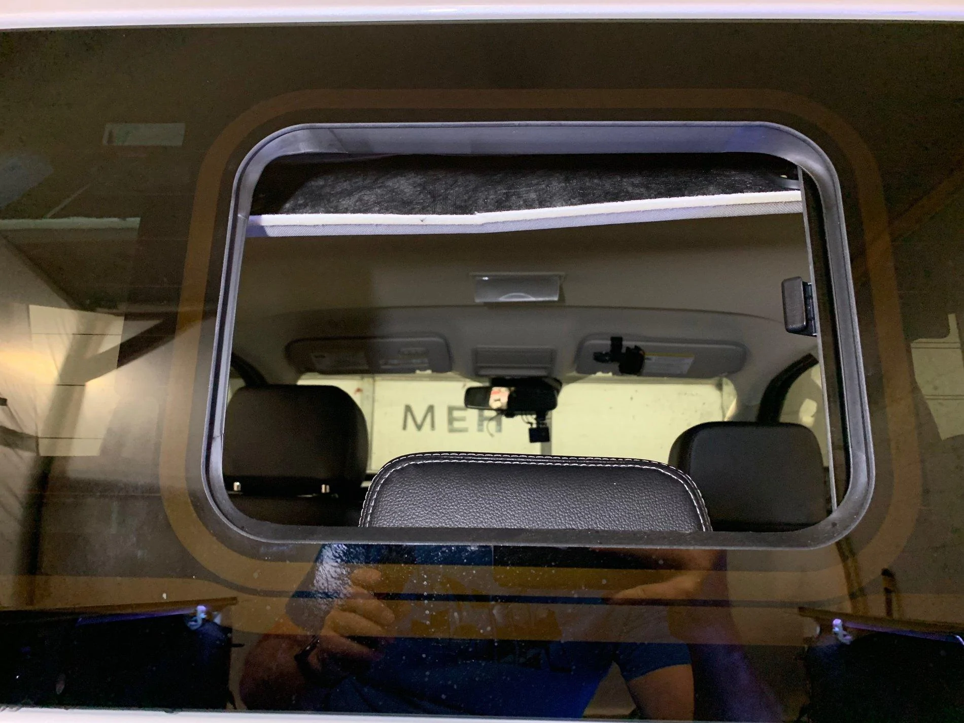

Carefully pull the rear portion of the headliner downward enough to get your hands above it. If you have the sliding rear window, the top window track is in the way of dropping the headliner down, but you can work it past that.
With the rear sliding window open, you can easily reach in above the headliner and access the bottom side of the antenna.

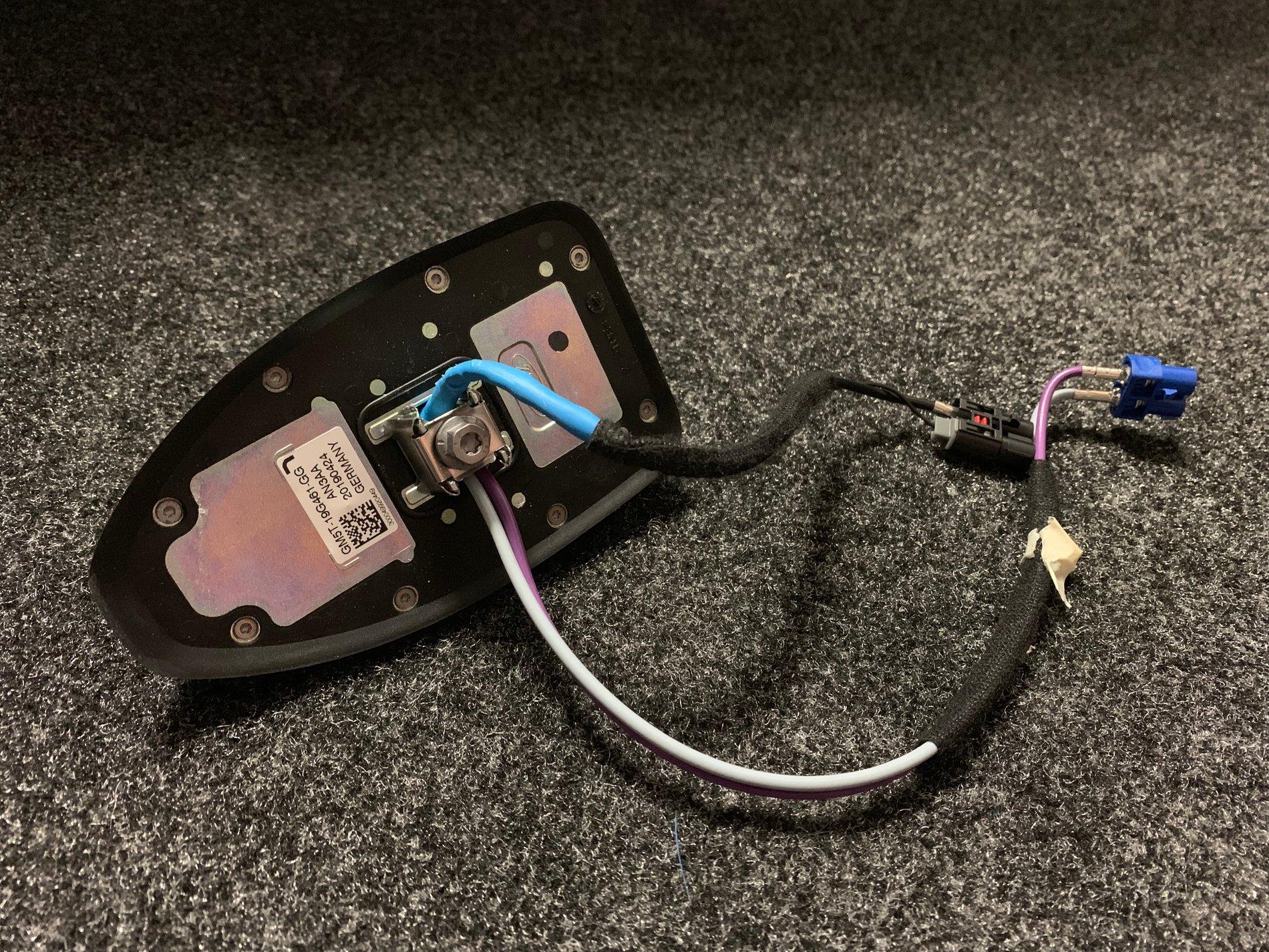

Grab an 8mm ratcheting wrench or small ratchet with an 8mm socket and remove the bolt and clip holding the antenna base on. You might be able to squeeze the metal retaining clip enough to pop the antenna base up and off the roof, but I couldn't get it so I just removed the bolt and clip.
Unplug the 2 connectors seen in the pics.
I can get more pics if needed.
