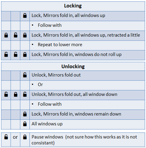

I made a quick user guide - an abbreviated version of TRAC's guide. I plan to print it small, laminate and attach to my key fob until I can remember how it works.
Updated 7/25 as I have learned how to use it

micI9... great tool... please elaborate on these 2:
They seem the same... or is that press lock once, pause and press it again to get the windows to go up?? Thanks.
It is confusing - sorry. I tried to show it was different with the added column.
After you do unlock-lock-unlock, if you hit lock Again truck will lock, mirrors fold in and windows remain down. If you hit lock again, windows role up *and truck remains locked with mirrors folded in).
Does that help?
The key is it remembers what keys have been hit since ign turned off. I am not sure if its long term memory, ie never forgets, or resets after a time of inactivity.
I am struggling with the lock-unlock-lock. If I do that combo after shutting the door, the windows stay up. If I hit lock, pause, lock-unlock-lock. It seems to work.
