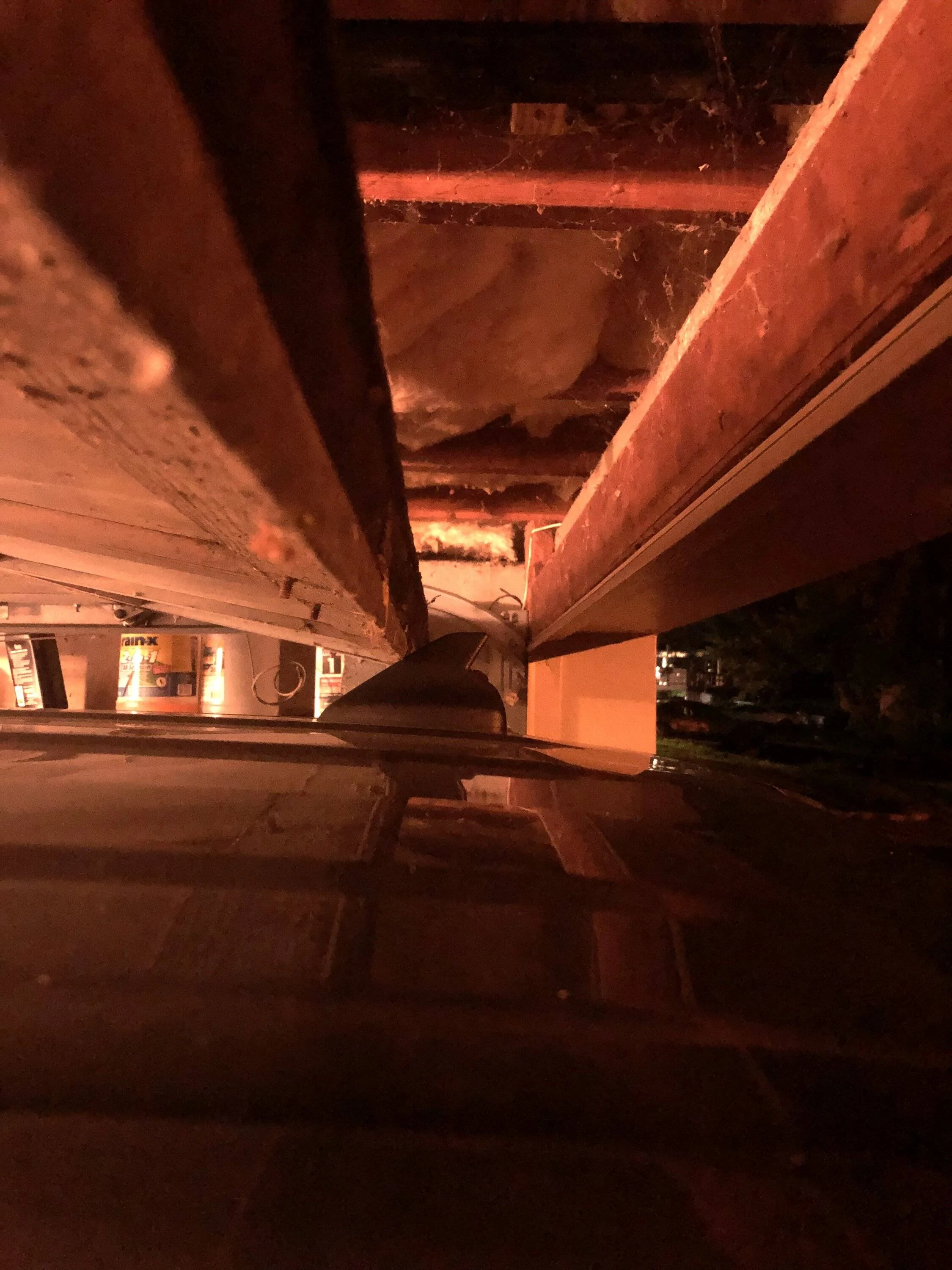

Hello, I'm trying to remove the antenna of my single cab Ford Ranger 2022. I'm building a truck camper and don't want to lose 7cm of space in the cabover just to keep the radio antenna.

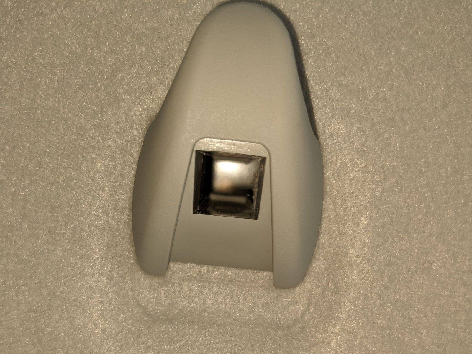

I've tried following the advice here but the single cab is quite different, shorter headliner with 2 hooks at the back, see photos attached.
I've talked to the dealer service and they told me it's easy just remove those caps, there should be a screw and then the headliner comes off. He said if I'm careful I could probably unbolt the antenna without removing other trim pieces of the pillars.
The problem is I've tried removing the cap but it's actually another hook and pulling it off reveals a hole where I can see the painted metal of the roof, but no visible screws or anything. I tried pulling but the plastic doesn't move, looks like it's fastened to the metal and the headlines moves around a bit but it's clearly held in place by that plastic hook, I'm afraid to break it if I pull it too much.

Nevermind I managed to take those off. I just had to pull them really hard, feels like you're gonna brake them but it works. Maybe pulling from top or bottom works a bit better.
The headliner is really stiff though, so I don't have enough room to reach my hand in there, I'll have to remove the seatbelt as well, now I need to find a T47 torx which surprising is hard to find.
