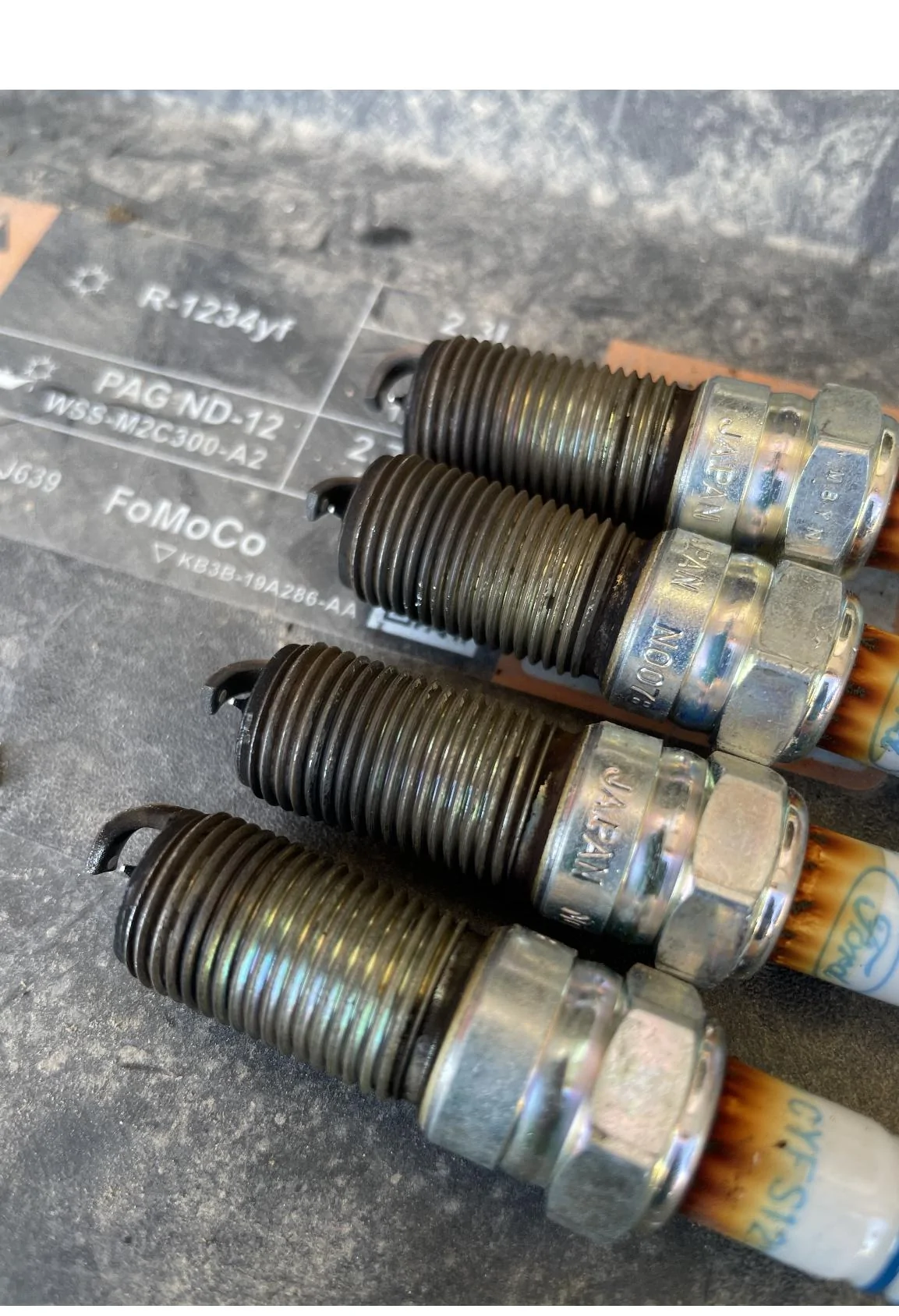

For what it's worth i've had roughly 0.5qts of extra oil come out for every oil change (5,000 mile interval) since 2019. Yes I measure it. I just cracked 50,000 miles. I have the Mishimoto catch can and I empty it weekly when it's about 1/2 full of mostly fuel. I live at 6500 ft and do a 50/50 mix of long highway and short <5 miles drives. I did spark plugs at 35,000 miles. I took a peak in the cylinder with a scope and everything looked normal.

How did the plugs look at 35,000?

Some heat signs on the ceramic and slight white on tip. No oil or fuel.
Did you check the gap on the plugs or notice any wear on the plugs? I'm curious why you had to change iridium plugs.
