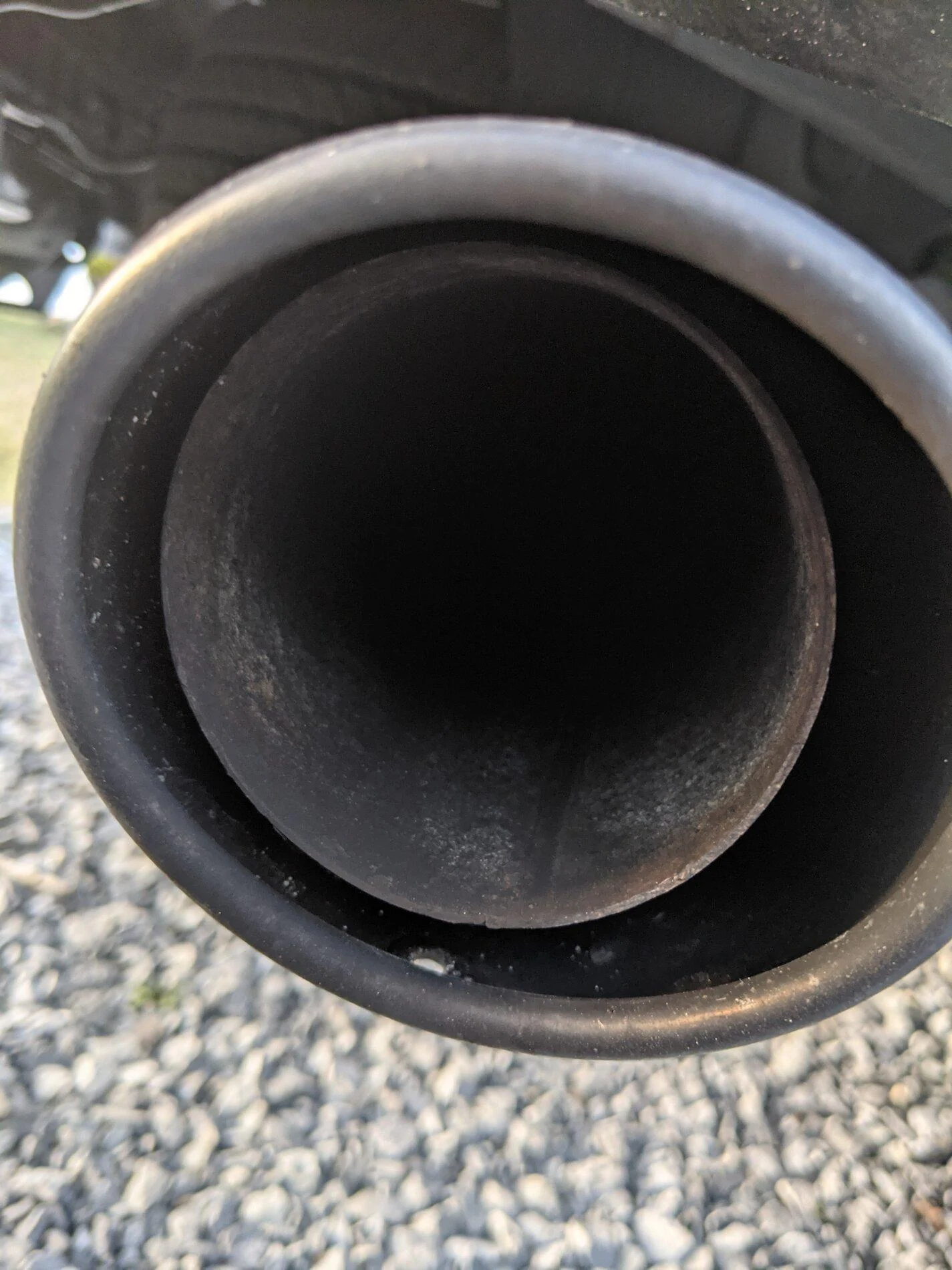

Still confused by the EGR application in the ranger. This Road and Track article states, "The EGR system was likely implemented to assist with emissions by pumping hot air into the intake to richen up the fuel mixture as needed." In my old VW 2.0 TSI, also direct inj turbo, the tail pipe was always black. This I would expect was due to rich fuel mix. The Ranger does not have this black exhaust soot. Question is... Is the EGR redirecting this gas back to the intake and could the temp and fuel be be condensing as it cools when the engine is off? The VW 2.0 TSI also had an electronic fan that would run when the engine was off to help cool the turbo.
What do the tail pipes of the 2.3L mustang and RS look like as to exhaust soot?

My Ranger has exhaust soot, 13k miles and its heavy

Damn you got me thinking about the sooty tailpipe. My tailpipe was really heavily covered with soot. I installed a AEM DRYFLOW FILTER, the trype that does not get oiled. I also went to 5/40 synthetic on account of fuel dilution. My tailpipe is no were near as sooty now, maybe more airflow helped with the rich condition. And my fuel dilution is manageable now. Before I would go all the way up to the twist, now the highest it's been is the top hole! Tailpipe is even starting to get a little rusted near the end!
