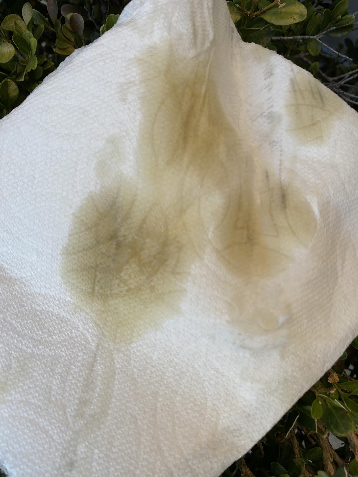

I have a brand new Ranger, 200 miles on it and love it so far. I was reading this thread and decided to check the smell of the oil on the dip stick. Mine had a smell on it similar to gas, not sure if the new oil had a strong smell or not but was a strong smell. The feel and look of the oil seems ok. I have attached a picture of the paper towel I used to wipe the dip stick a few times. Does this seem like the same issue?

I wouldn't worry about the smell, and just keep an eye on the level. If it is not rising past the max level mark and beyond, I would not be concerned. After a lot of researching, it seems a little fuel dilution is the nature of the beast for these DI, turbo'd engines and nothing to worry about unless the oil level continues to climb, then something else would be amiss.

Thank you for the reassurance Moto! I love this truck and just picked it up and haven't driven more than 30 miles. I'm guessing that nothing major has happened to these trucks as a result.
