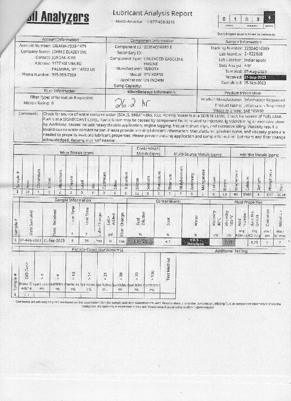

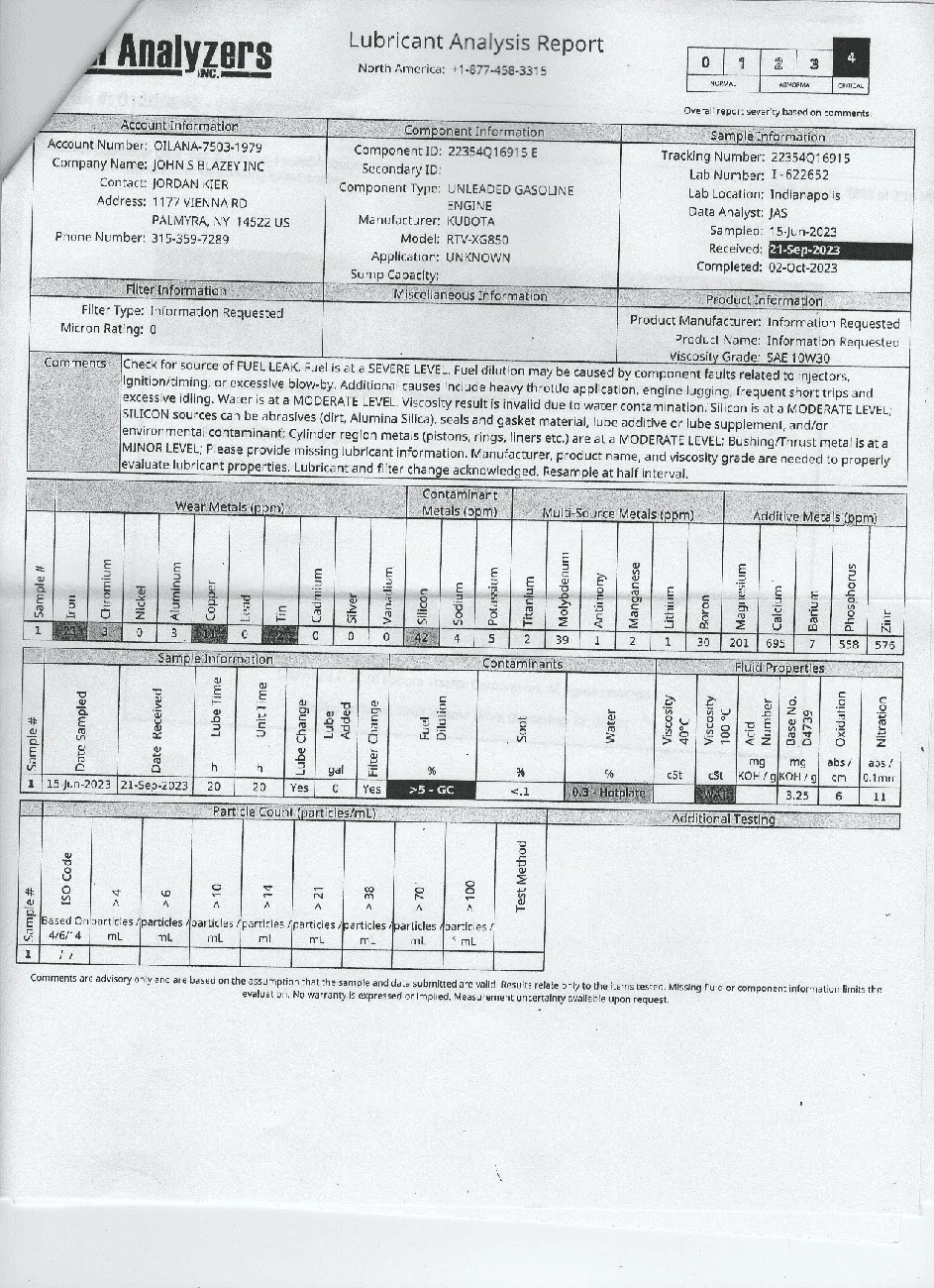

I'm having an even worse problem with my new Kubota side by side. About 5 ounces of gas in the oil every 5 hours. Seems they have an even worse problem with the Subaru injection but luckily Kubota is now involved. I think these companies are hiring incompetent engineers nowadays and passing garbage on to unsuspecting buyers.

No it is not. It's a high compression engine with a manifold injection setup I think. Not sure what they will do about it but seeing others with similar issues and also bogging from too much fuel in the midrange fouling plugs. I think it is a very crude system with no exhaust monitoring because the exhaust stinks of raw gas. Sucks after waiting 14 months to get it.

I'm guessing pandemic quality has something to do with it. Kubota bought the Subaru tooling and mine is one of the first built by Kubota during the pandemic.
