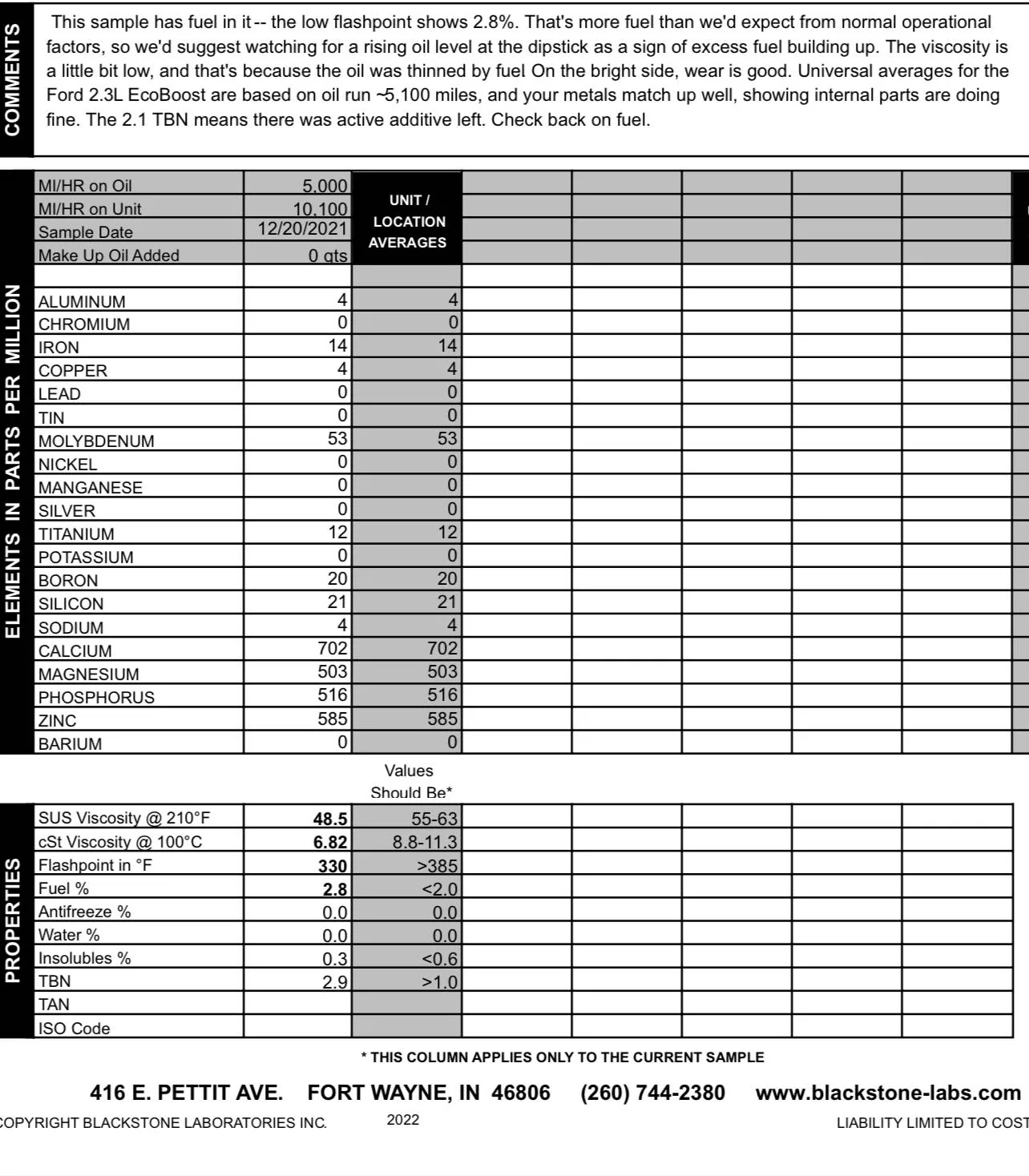

My results at 10K miles from blackstone was 2.8. They told me that is high. The fuel also thinned out my oil (obviously). My truck is used on the highway 90% of the time.

How much does this analysis cost to be done? Want to know what mine is but kinda don't at the same time
For Blackstone, a basic analysis (including fuel%) is $30. TBN is an extra add-on, but completely unnecessary if you're just wondering about fuel and wear metals.

After my first analysis, I e-mailed Blackstone to ask about the 2% limit and whether that was relevant to DI. The guy who responded said the 2% is somewhat arbitrary and is based on what they typically see across all vehicles, and also that they don't see much difference in DI engines.
