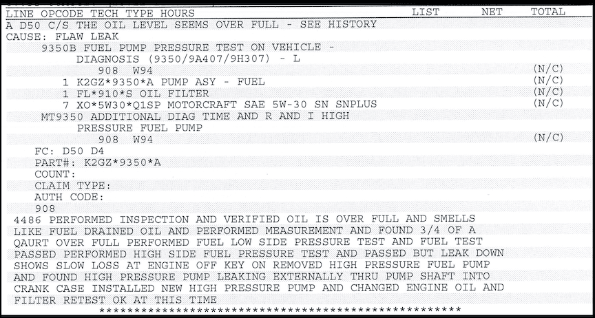

Mine turned out to be the HPFP.
My oil level was rising and the dealer confirmed it, then did some testing and found the HPFP leaking into the crankcase.
They replaced it 8k miles ago and I've had no more oil level increase.
Edit: Added my service ticket.
