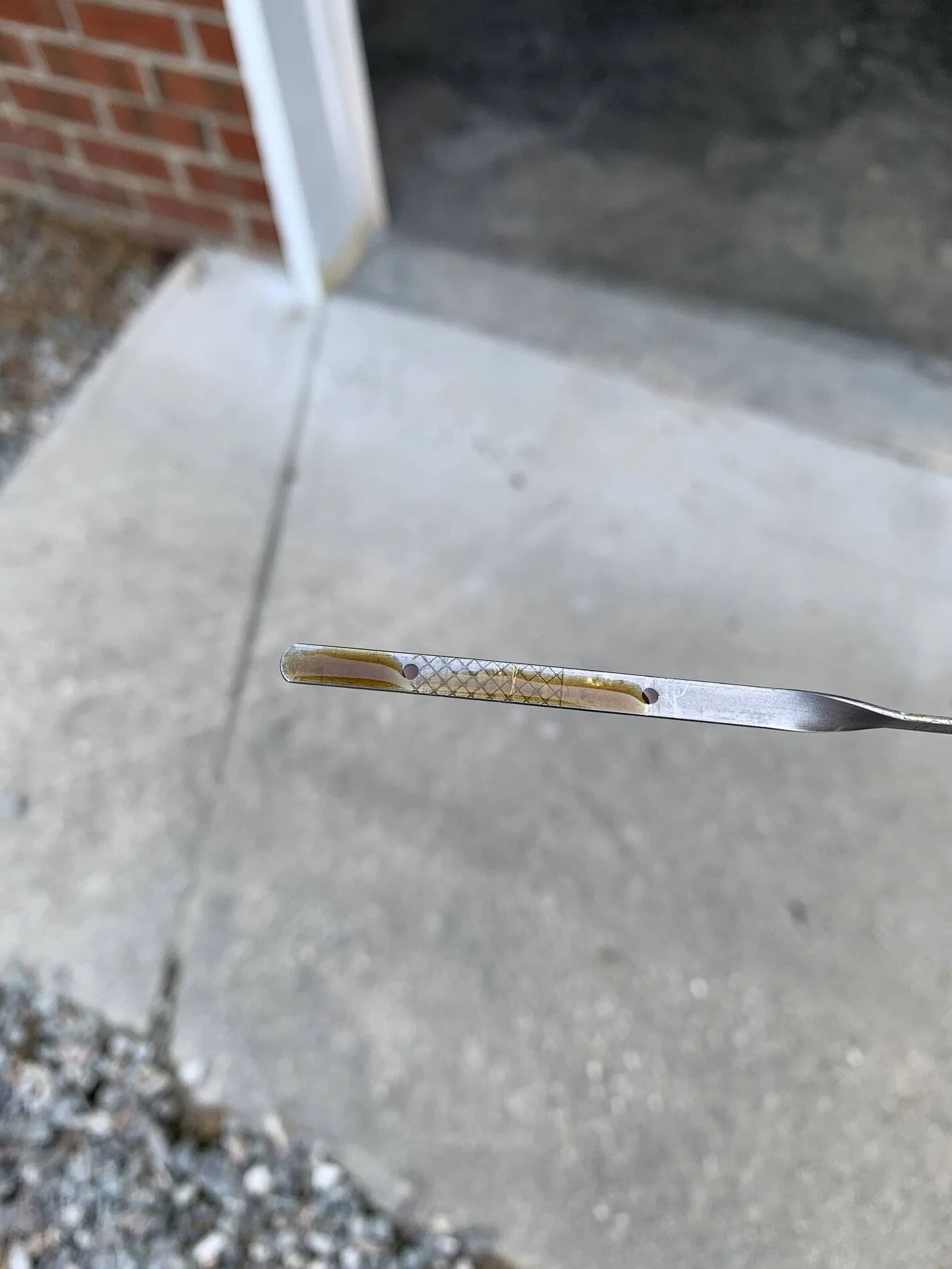

So since my last oil change, I have gone 4,420 miles. Oil level has risen 3/8 of an inch to the max level hole. I have an appointment for an oil change 8/21 and will point it out to them, but I really think I am just not going to worry about this any more. They replaced all four of my faulty injectors back on 4/8/21 @ 8,849 miles. I went full synthetic at 10,230 miles. That oil change the level was just below the hash marks on the dipstick, and since then so I have driven almost 4500 miles. Just going to stick to 5000 mile oil change intervals and be done with it.

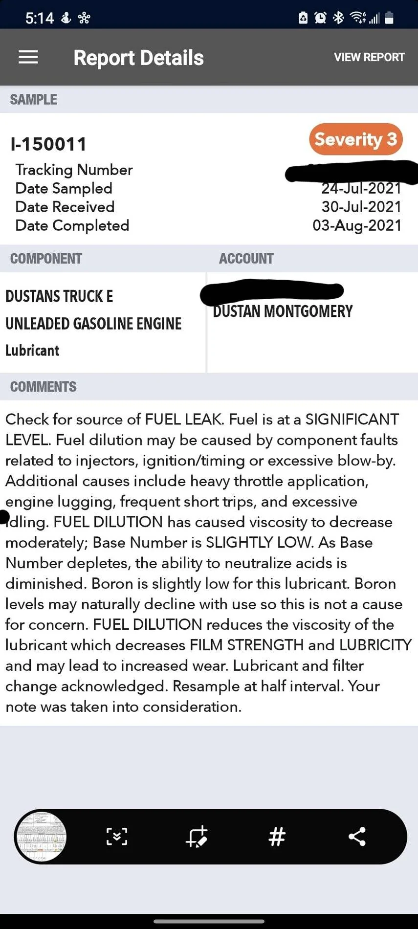

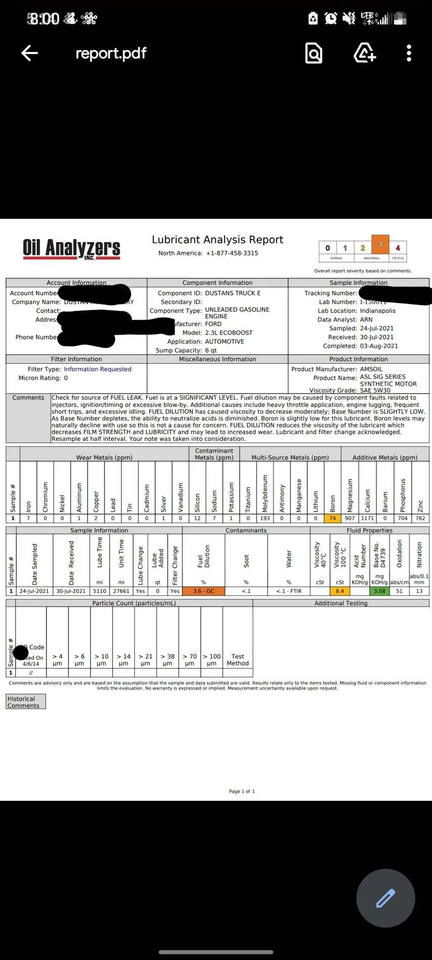

Truck has 29k miles and I did a 5k interval for this test. Been keeping an eye on the fuel dilution and figured I had a problem. Changed the oil and filter and drained the filter and engine into a clean marked pan. An extra .5 quart came out than initial fill. I obviously didn't get all the oil out of the filter so it could have easily been .6 or so more over. Sent the oil out for analysis first to Blackstone and lastly to Oil Analyzers. Both said I had a fuel dilution issue.. Kind of a bummer because this is one of the best trucks I've owned and now I have to worry about long term reliability. I talked to a dealer and they just reassured me if I had significant fuel contamination my engine would have serious issues. Smoking burning oil etc... I think I'll just go full send for the initial 60k powertrain warranty and then trade in for the 23 model if it comes with a 2.7L.
I wouldn't even worry about it if your 4% or below. I've read a few articles that state today's modern day synthetics are engineered to handle up to 4% fuel dilution. Infact I think one of the articles was even on an amsoil site!

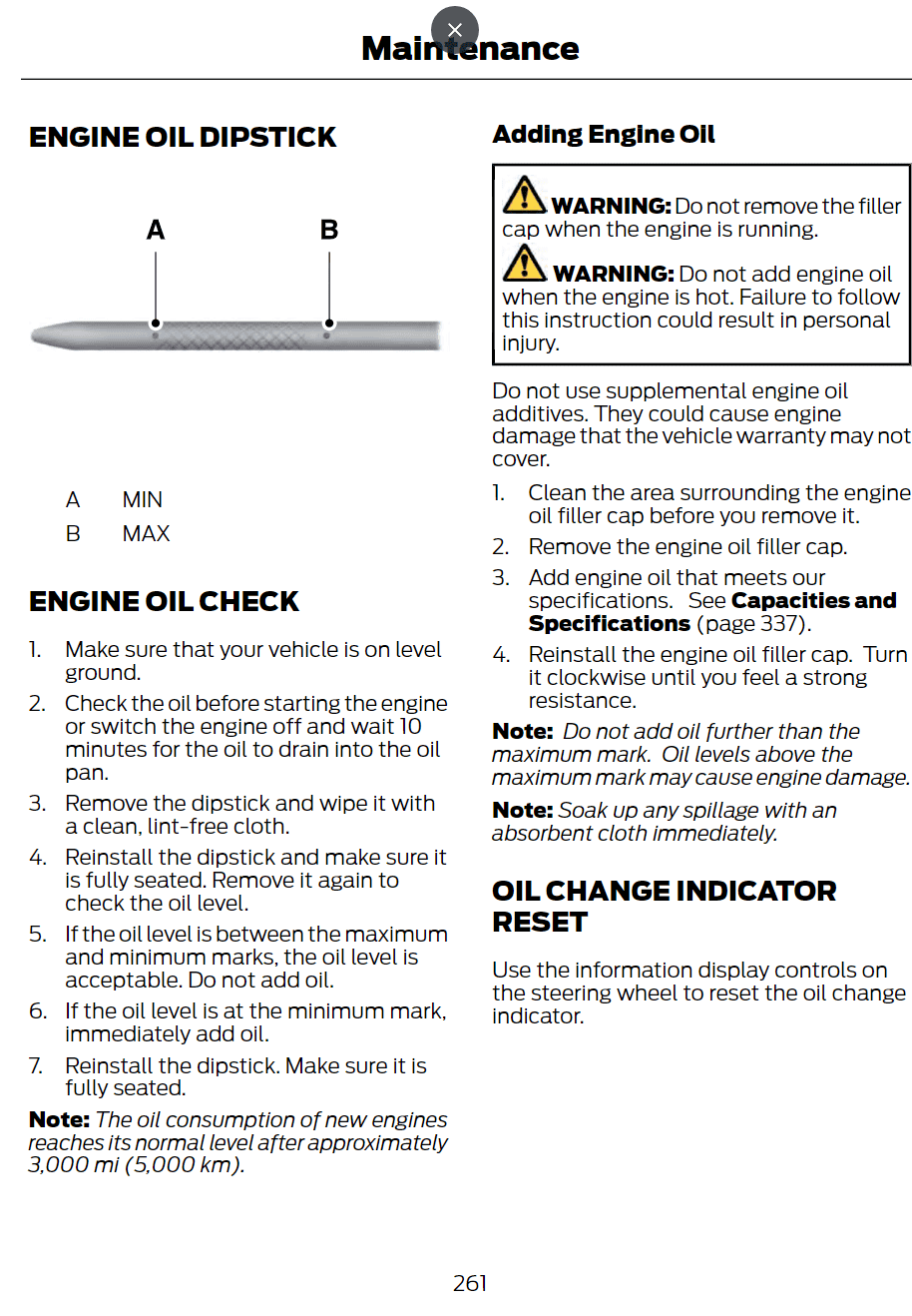

I've decided I'm not going to worry about it too much. the Owners Manual says nothing about overfilling the crankcase, and makes no specific reference or remedy for oil level above the maximum like they do for minimum oil level,
or for overfilling the gas tank, for instance.
The engine has been around since the 2015 MY in the Mustang, and to my knowledge there is no wholesale engine failures resulting from excessive fuel-in-oil-dilution or serious class actions, like there is for the 1.5L EcoBoost Four in the 2016-19 Escapes for coolant intrusion into the cylinders. I have no empirical data, but I suspect that a large portion of the $3 billion in Ford's annual warranty payout went to replacing thousands of short or long block 1.5 EB4s.
When gassy/oil starts barfing out of the air filter, I'll contact my lawyer and my dealer then. In that order.

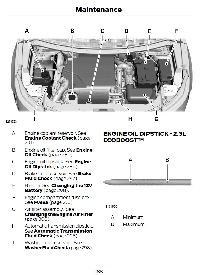

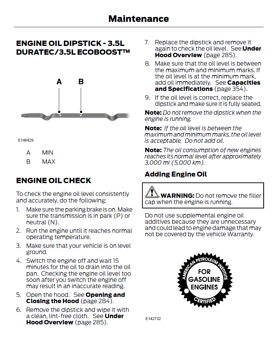

That is actually a good point. Just to check - I looked at the manual for my wife's 2018 Explorer as well, and sure enough, the verbiage is the same. It does not specifically call out anything about the oil level going over the max mark. I mean I would think it would be bad, lol.
JKocot
Aug 3, 2020
359
775
Montpelier, VA
2020 Ranger Lariat SCrew FX4, 2018 Explorer Sport
Senior Systems Engineer/Former Marine

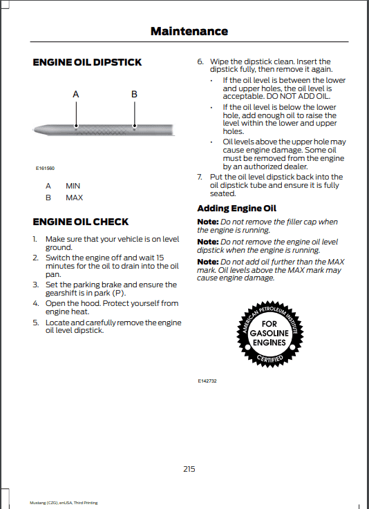

But here is the manual from the 2015 Mustang. It calls out going over the upper hole:
But the 2021 manual does not:
Wonder what changed?
