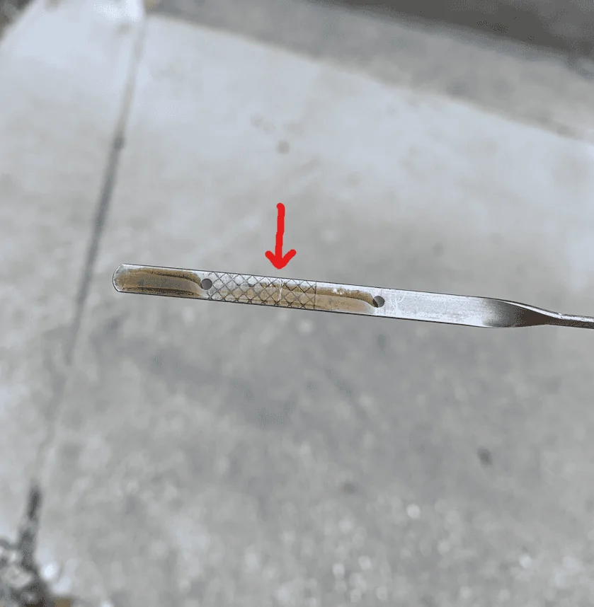

I am at 15000 miles and the level is at the max hole. Last oil change was at 10550. Oil level was measured about 2/3 up the hashed mark area (Had the dealer score the dipstick)Back on page 265, it states that the "oil consumption of new engines reaches its normal level after approximately 3000mi (5000km)."

My experience is that my oil level was at the full dot at 5300mi before a recent Ford Quick Lane oil change, and ~1/4" above at less than a thousand miles after; both checks after sitting overnight in a level garage. I'll check it again each thousand.

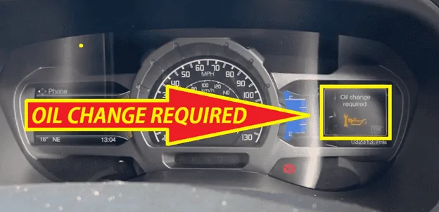

I had my 1st oil change last week at a local Ford Dealer. The "Oil Change Required" notification came on several weeks before I had the change done at 4231 miles. I assume they put in exactly 6.2 quarts because the oil level was right on the line at the top of the crosshatch. I am curious if you guys are getting the same level reading on your dipstick (pic. below) after you do an oil change? I will send a sample of the original oil to Blackstone for analysis and report back their findings. This dealer recommends 5000 oil change intervals which has been my standard practice.
Chris,Your Oil Life Index is Interesting. I changed mine at 5745 mi and my OL was still 48%. I wonder if the Monitor accounts for fuel along with other contaminants and triggers the Service engine soon at some threshold? I understand its pretty comprehensive system.

I have 3500 miles since my last oil change and my oil life reads 65% !Your Oil Life Index is Interesting. I changed mine at 5745 mi and my OL was still 48%. I wonder if the Monitor accounts for fuel along with other contaminants and triggers the Service engine soon at some threshold? I understand its pretty comprehensive system.

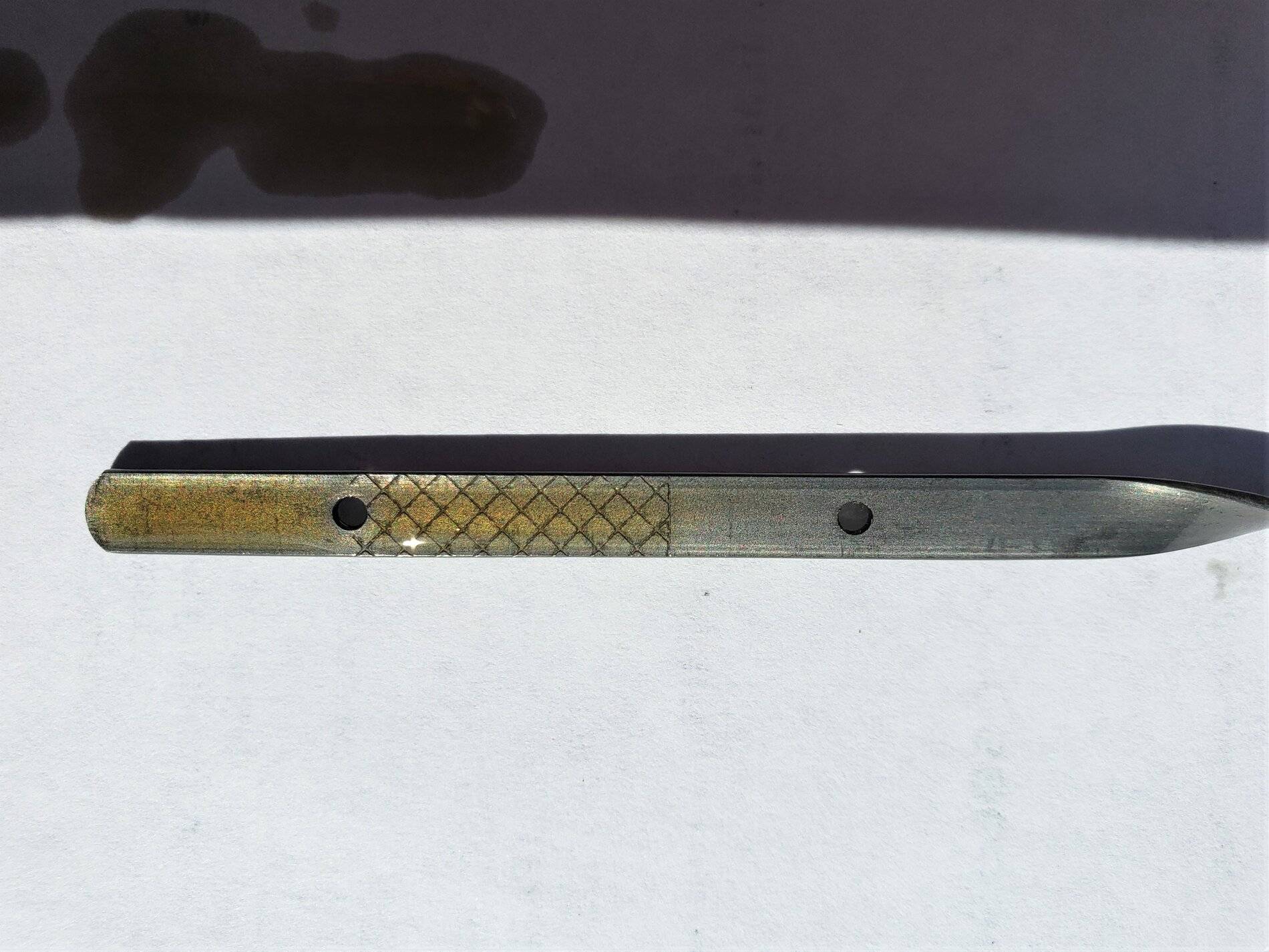

Has the level been above the top hole on the dip stickI’m happy to report that my fuel in oil went away in my latest blackstone report
https://www.ranger5g.com/forum/threads/blackstone-used-oil-analysis.7489/post-304645
Nope. Normal in the do not add oil range.Has the level been above the top hole on the dip stick
