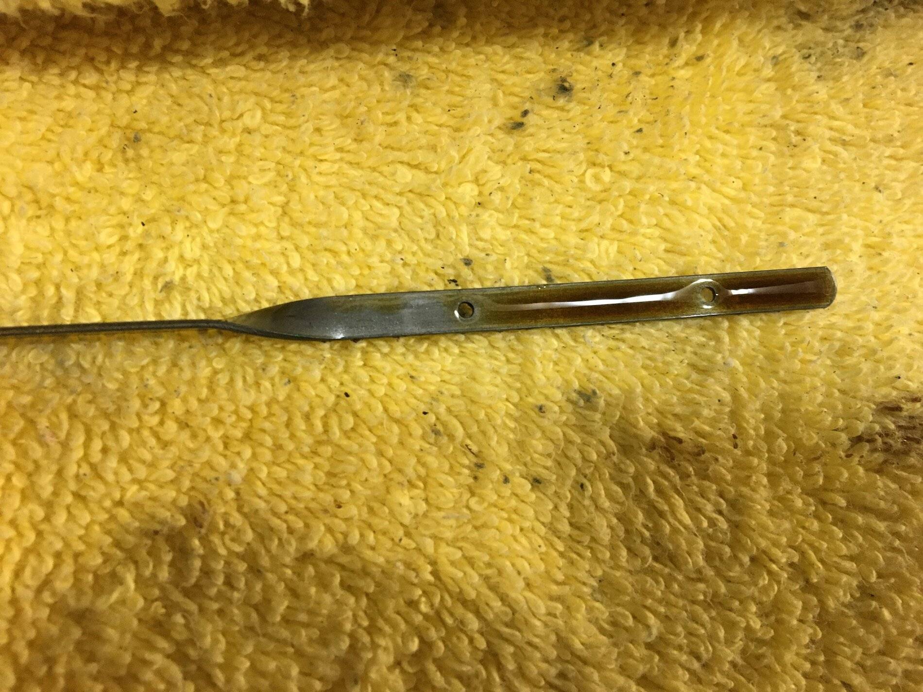

I commented before that my Ranger was a little above the top hole with 5,000 miles on it and smelled like gas. Well I just got my oil changed and the dealer almost filled it to the top hole so I would say it is gaining very little. Nice it is not really an issue for me.

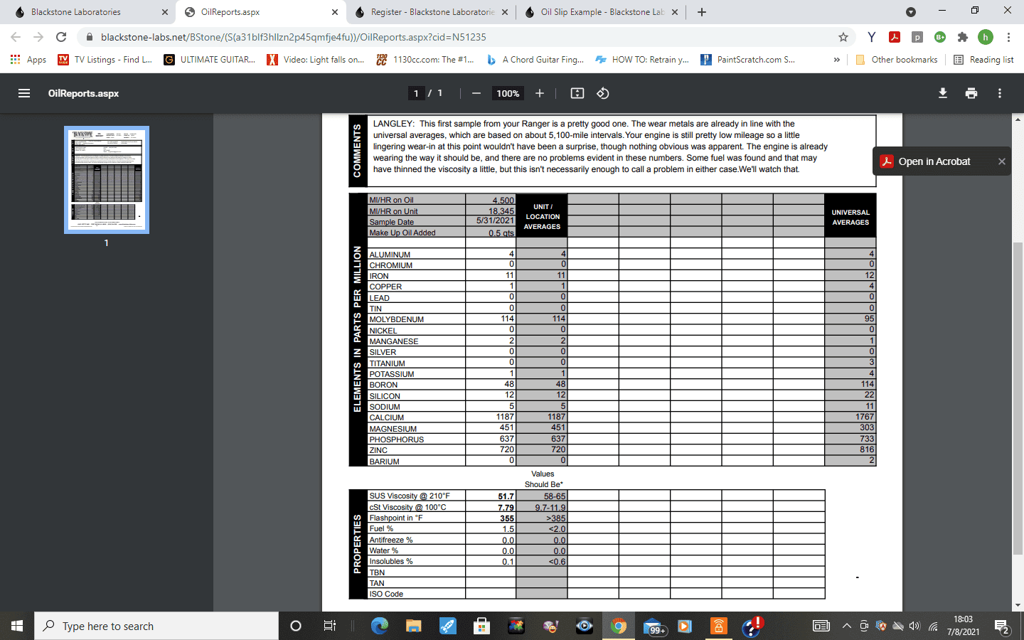

here is my report.
This is one of those reports that make me question the benefit of having this done at all. You’ve got lower than normal viscosity and they can only attribute it to “operational factors”. What’s that supposed to mean? They want to attribute it to fuel in the oil, but the numbers dont support it. This seems to call into question the relationship of low viscosity to fuel in oil on any of these reports, since there are apparently ”operational factors” that can not be quantified that can lead to the same result.

It may point to these engines just being hard on the oil. From past experience with the mazdaspeed engine, the factory fill was 5w20, then 5w30, and in some cases (turbo burning oil) they began to recommend 5w40. Fuel dilution wasn't a big problem but the engine liked to shear the oil. I always ran 5w40 and that worked out until I sold it. Some guys ran 5w30 WalMart oil in their race engines and others ran boutique race oils in their dailies.. I plan to find an approved oil on the thicker end of the 5w30 spectrum, most likely the motul 8100 eco-lite. I doubt it matters but peace of mind is worth the extra 20 bucks.

Yeah with that 5 to 6 % fuel dilution I figure I need all the help with viscosity I can get!

Update on my 2020 XLT coming to the time to do the initial oil change in August. No change in driving habits, still short 8km daily drives, auto start/stop off, occasionally couple of hour drive once a month and not every month. Truck has just shy on 4000km (2500mi) on it. No system modifications or tuning, just stock.
During winter I saw the oil level reach about a 1/4in above twist before going for a long drive. After the drive it would be at the base of the twist. In the current summer driving I am seeing the oil level back down to just below the hole. This is after driving around city and getting the engine hot but not driving for more than a hour.
In another month I will change the oil and continue to monitor between summer and winter conditions.
Again I am saying this is just my experience. If the fuel dilution situation with the DI engine is predictable, I am happy.
