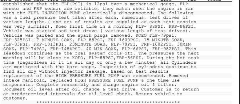

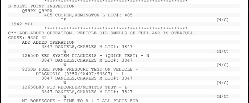

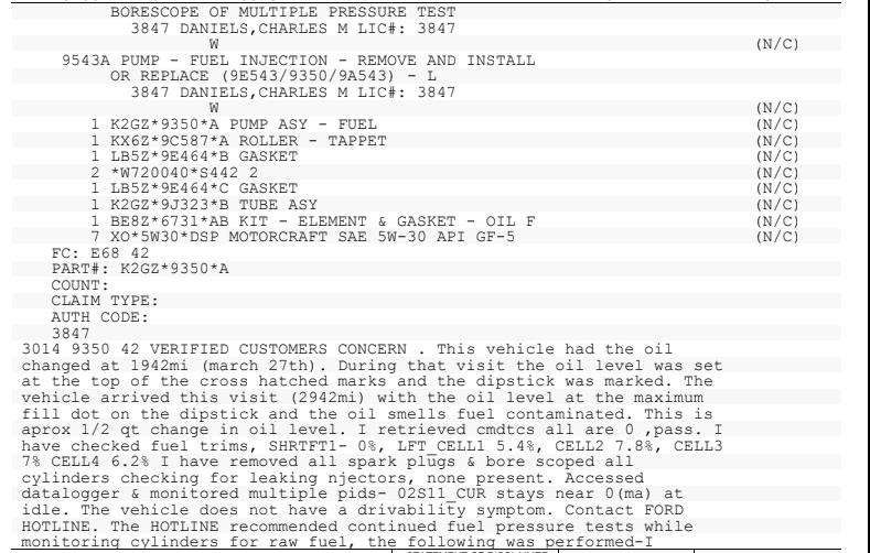

Got it back.. They changed the HPFP and said come back in 1500 for an oil check..
Yeah a half a quart of fuel in the oil, that guy who said nothing to see here I wonder how he would like to ride around with a half a quart of fuel in his oil. Mine had a HPFP change because the level was up to the twist. Helped but still rises to the top hole. This is an issue ( NOT NOTHING TO SEE HERE)!

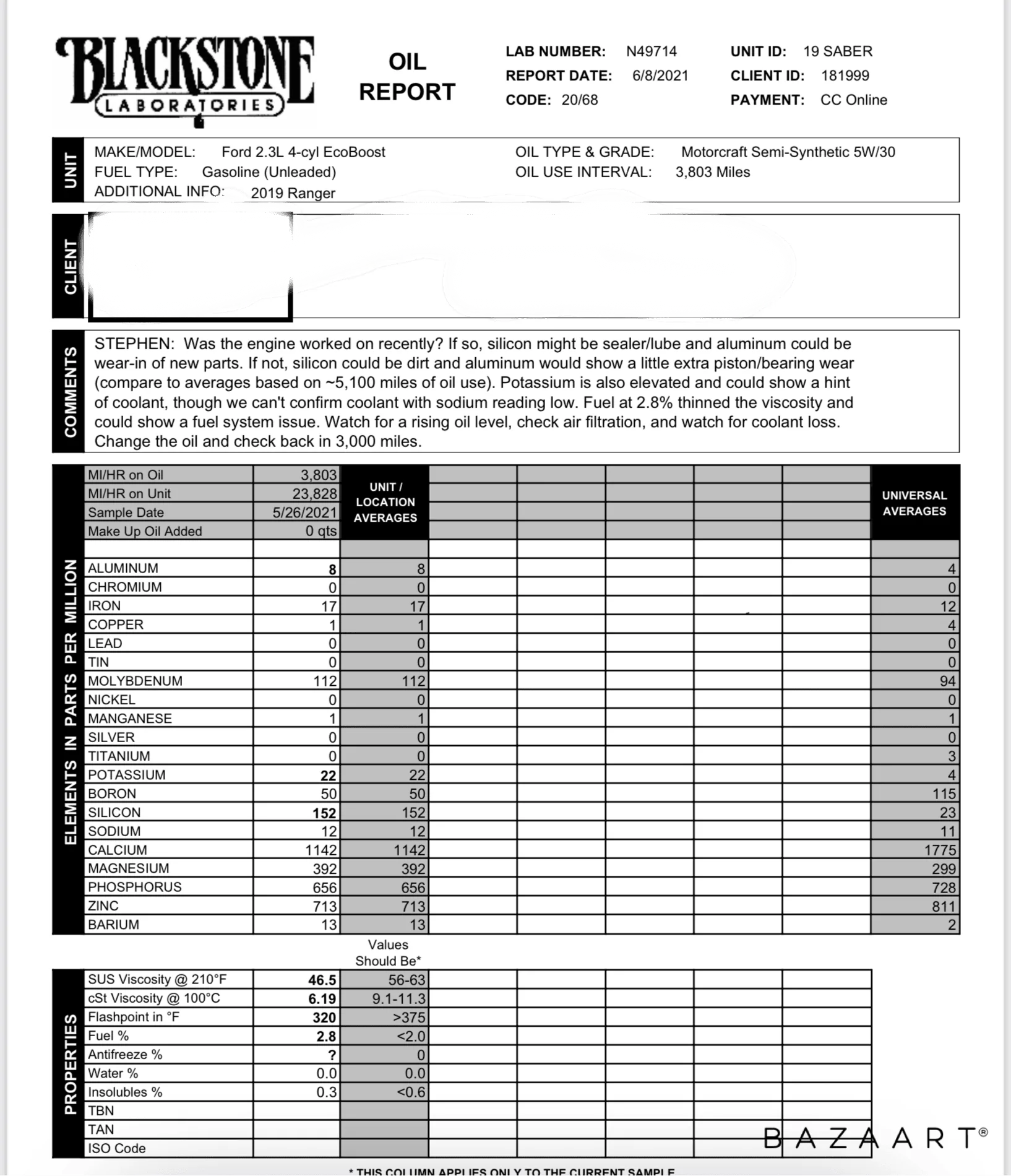

I got my oil analysis back from blackstone and I have 2.8 fuel dilution at 3,803 miles on the oil. I also have high silicon, aluminum and potassium.
should I be worried about those elevated levels?
Not in my opinion anything to worry about. I've sent in a total of five samples to blackstone and the five average out to 2.8 dilution. If you feel like it you can go back through this thread as I've posted all my sample tests. I too am no longer going to worry about this issue and just drive my truck. I do love my truck.

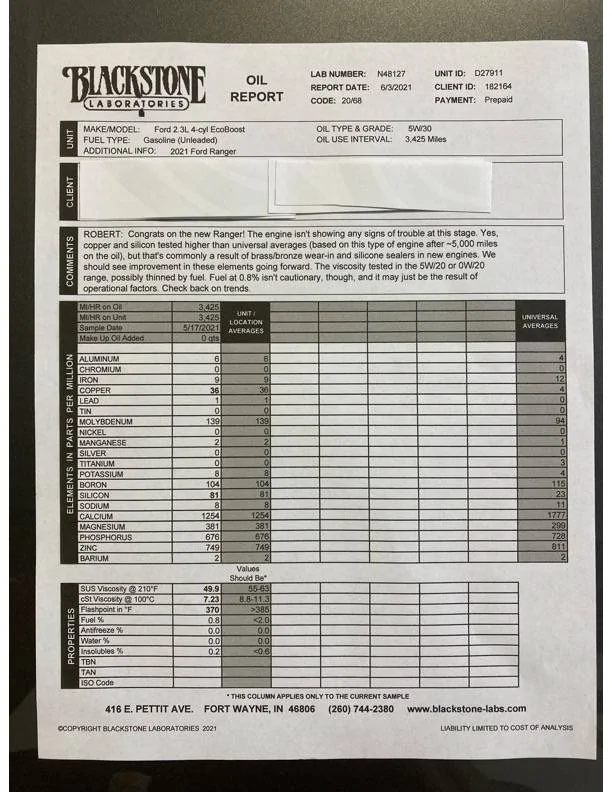

here is my report.
This is one of those reports that make me question the benefit of having this done at all. You’ve got lower than normal viscosity and they can only attribute it to “operational factors”. What’s that supposed to mean? They want to attribute it to fuel in the oil, but the numbers dont support it. This seems to call into question the relationship of low viscosity to fuel in oil on any of these reports, since there are apparently ”operational factors” that can not be quantified that can lead to the same result.
