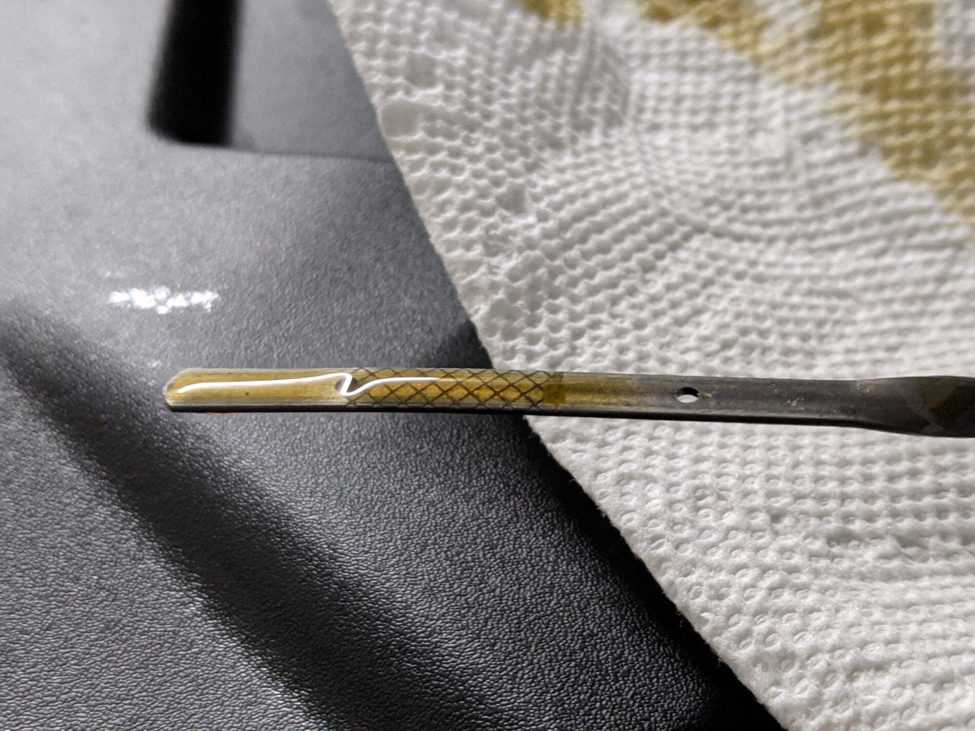

Update.. 1100 miles on my oil change took it back to the dealer who wanted to check it at 1k they said the oil was high and smelled like gas
The service adviser asked if they could keep it and contact ford for further information.. I left the truck there..
Oil level before I took it in..

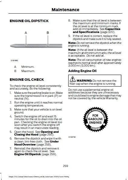

That's not high, that's just fine.
Just was notified ford is replacing my high pressure fuel pump..

It helped alot for me but did not totally fix the problem. My level was going past the twist before HPFP change, now still rises to the top hole or a little above!!
That is what mine does too, Jim. Its weird how it likes to go a little above the top hole and stabilizes there.
