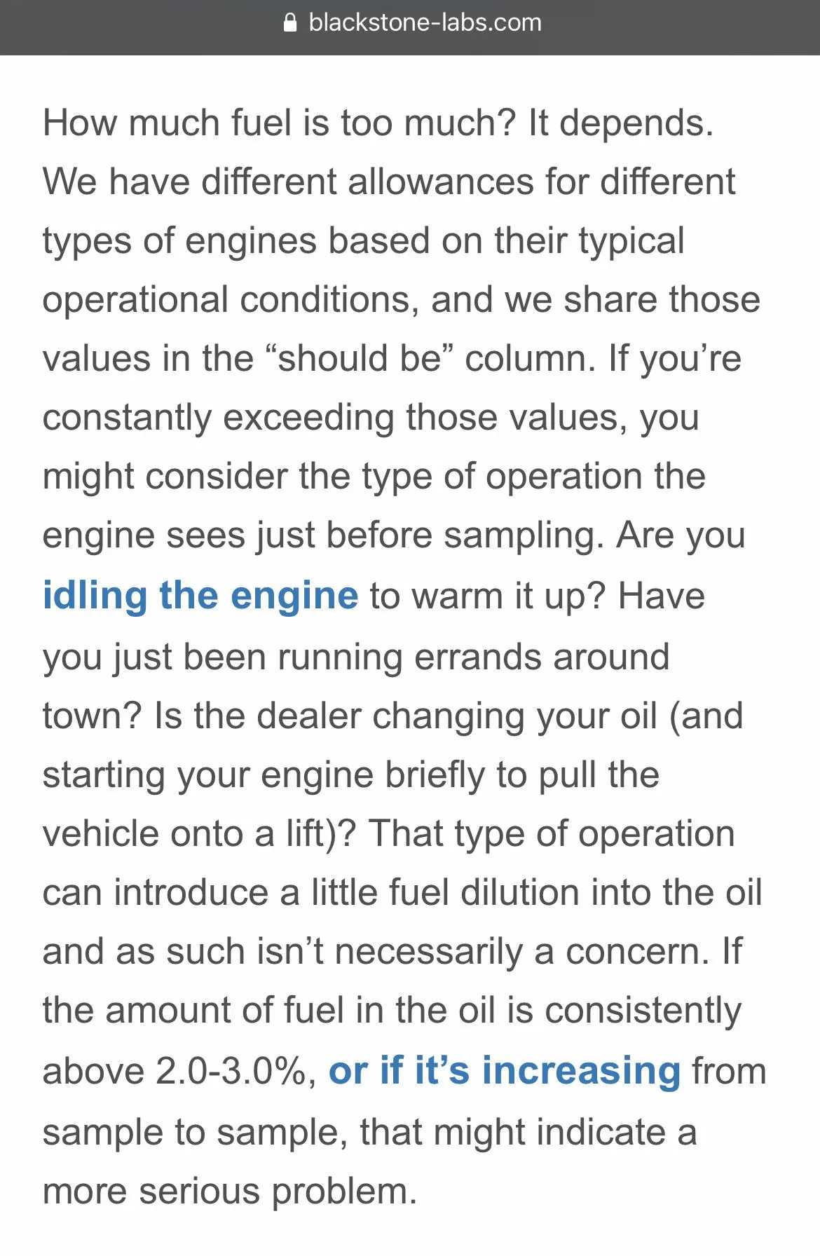

It really just comes down to research. Oil experts seem to say the anything above 3.0% for gasoline engines is cause for concern. Amsoil specifies "up to 2.4%" and Blackstone seems to support this with a more broad "2.0 - 3.0%"
https://blog.amsoil.com/what-is-fuel-dilution-and-why-is-it-bad/

But how did the oil labs decide on those thresholds? It's simply a matter of that's the level that is generally unusual across a variety of makes/models. Being unusual is a cause for concern (which is why the labs flag it), but it does not mean that it is for sure discernibly harmful.
