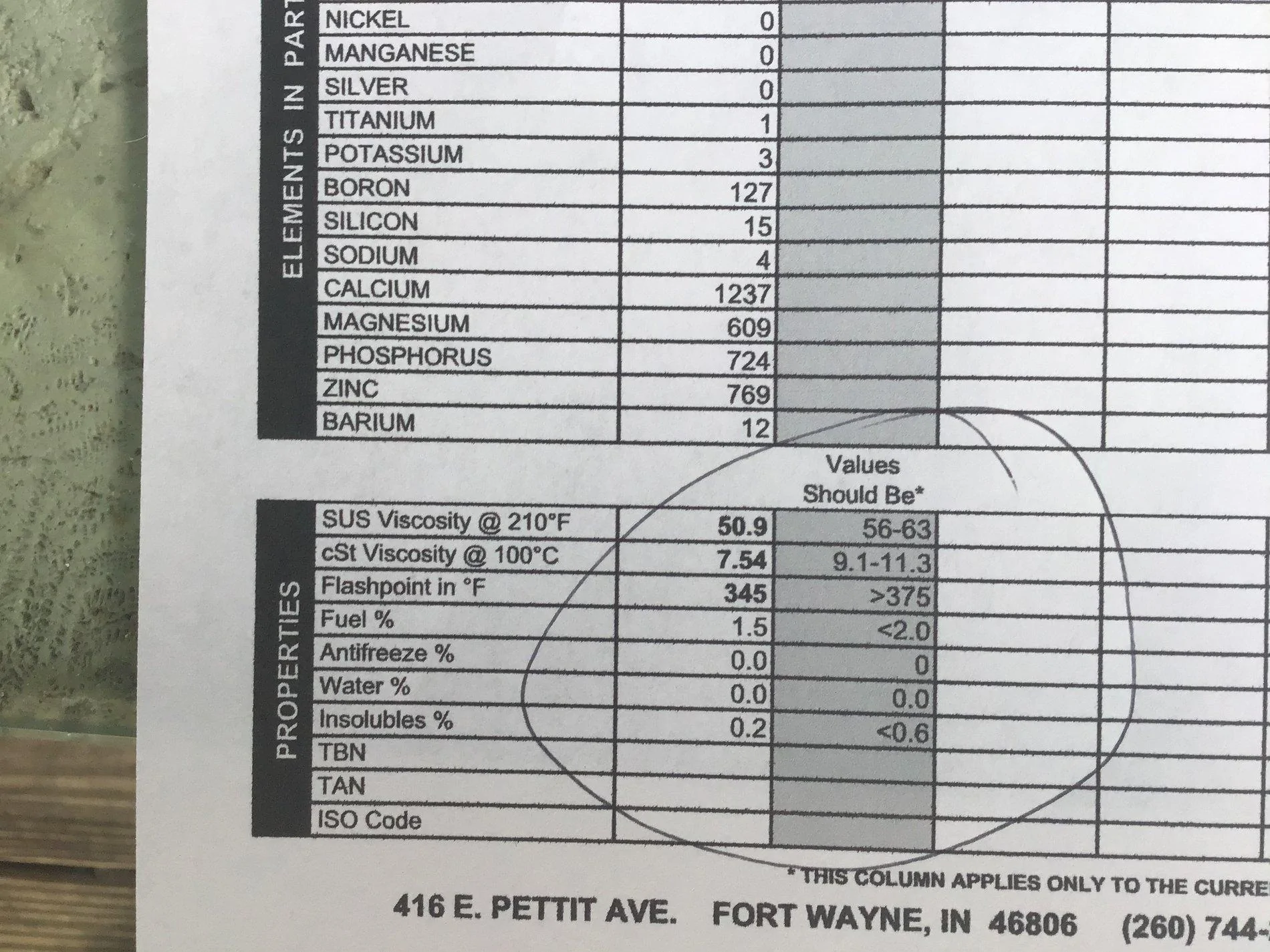

What oil are you running? Viscosity is sub-par.
Ford, motorcraft 5w40...that was a 2000 mile interval test ( the engine has 5000 plus miles on it)..although within specs, not for 2000 miles, with that fuel dilution. I wouldn’t go over 3000 for an oil change. Did you test yours yet well worth the 28 bucks!

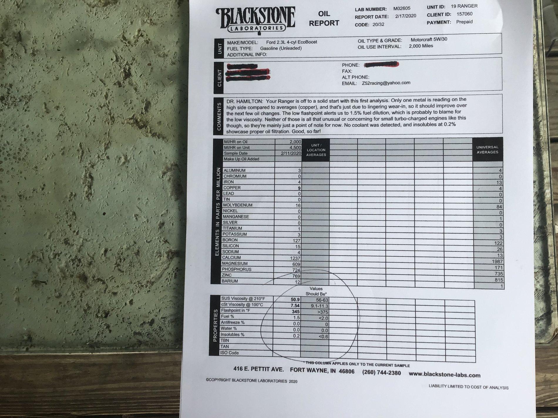

My bad...5w30 motorcraft , dealer service.
Yes dipstick smelled like fuel, so I had it changed, put 2000 miles on it changed and tested.
On this test, there is a 1.5% fuel dilution which I consider excessive for only 2000 miles. Dealer notified.
Although these results are a lot better than most of the tests I’ve seen here.
Regards

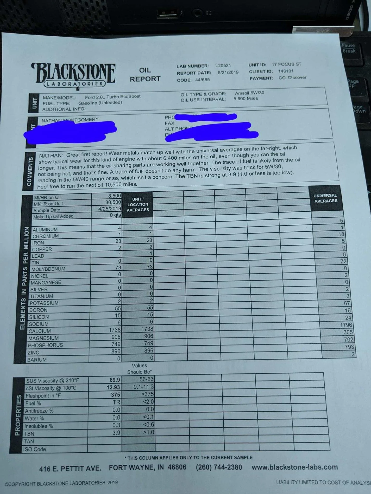

FWIW I had a full bolt on stratified tuned 17 Focus ST and used amsoil XL series oil. I sent my oil in after a 9k interval and it came back from blackstone passing with flying colors and they even mention I could go over 10k if I wanted too the oil was still in that good of shape. So a boosted car doesnt always mean you will have a bunch of fuel in the oil. Fuel dilution was so low in it was marked TR for "trace". Im running same oil currently in my Ranger and plan on doing a sample at 5k because to me the oil already seems thin and of course reeks of fuel. To me the high fuel dilution is unnaceptable but if it's going to be the case Im running cheap synthetic and doing shorter intervals i guess.
